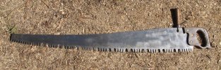

Picked this up recently, and wondered if anyone could shed light on the unusual shape of the blade. I'm used to them having more backbone, this one tapers down a lot at the tip. It is for some special purpose? It's an Atkins, if the button is anything to judge by. I made a new handle and stuck that on it, now I just need to finish my single man saw vise and file it.
.... wondered if anyone could shed light on the unusual shape of the blade. I'm used to them having more backbone, this one tapers down a lot at the tip. It is for some special purpose?
It's a one-man felling saw. The shallow spine is make room for the wedge to come in behind it.
Hm. Makes sense. Cool. Seems like that would be no fun. Hard to get much bite without gravity or a partner...

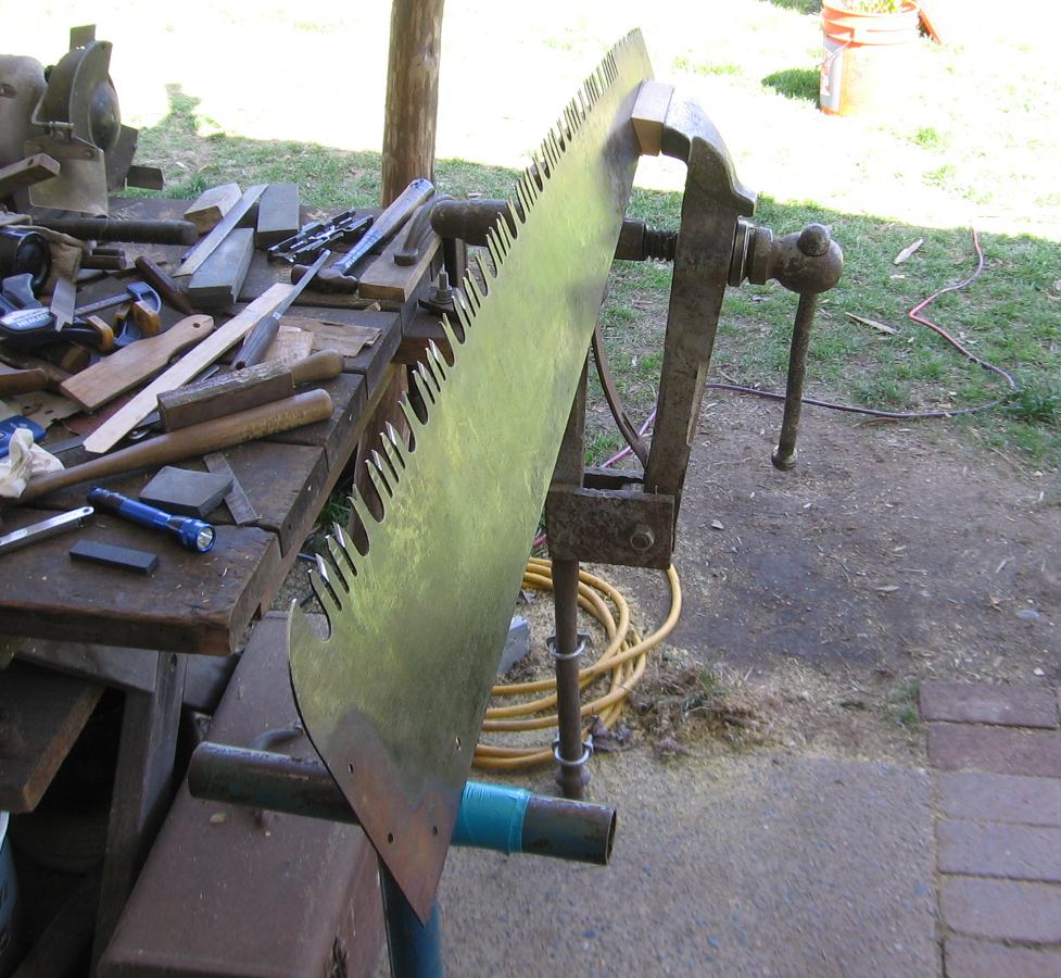

Here's a photo of my makeshift saw vise. I'd love to have a real one but it just isn't practical for me to give up that much shop space for something I'm only going to use maybe once a year. So I just ripped a block of wood in half at a 25° angle and hot melt glued the halves to the jaws of my vise. Then I propped up the loose end of the saw with a runoff stand. It works OK but I have to keep repositioning the saw to keep the work close to the jaws. I tried 15° blocks first and that wasn't nearly enough tilt. 25° was OK but I might try 30° or even 35° next time.
Here are some freshly sharpened teeth. The teeth facing the other way still have their flat spots from the jointing process.
This saw needed some serious jointing. It took me over 5 hours to go through the whole sharpening process on this 48" saw. I hate to think how long my 90" will take. I've still got the saw apart for refinishing the handle but I'll post another pic once it's finished and put back together. It cuts like a dream right now. Helluva lotta work but worth it.
I was filing saws for about 4 bucks an hour last year. I remember one badly rusted simonds saw which was particularly tedious. That simonds steel is tough stuff.
Yeah, there is more value in the work put into sharpening an old saw then there is in the saw itself. Dolly Chapman charges $9.00 to $40.00 per foot of saw depending on condition. That's actually very reasonable.
I was doing full restoration, cleaning, straightening, etc for 20 or 25 bucks a saw. Some folks around here know I'm a sucker for anything to do with hand labor and metaphysics.

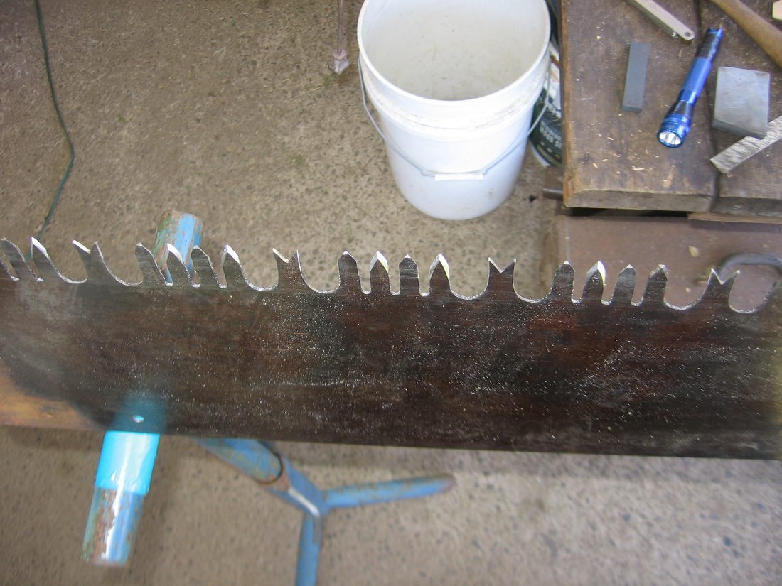

Picked up this saw yesterday at a garage sale and I know nothing about saws but would like to learn. The blade is 3 1/2 feet long, is marked "Superior" on the button on the handle, is perfectly straight and to my eye has no damage to any teeth.
Is this a crosscut saw? (told you I know nothing :-))
I will clean it up and so forth but then what do I need to do to get it to be usable? And who works on these saws anymore or where can I learn? I'm not giving up my chainsaws but I would like to have a usable crosscut saw for fun and for emergencies.

That is a one man crosscut saw, Champion tooth pattern. The link below takes you to the Forest Service manual on taking care of them. It's not all gospel but it's all pretty sound, especially for a beginner. Then you need to find a couple different kinds of files, a proper hammer or two, a jointer, probably a set of feeler gauges, and a pin gauge. Or something like that... And you'll need to build or improvise a vise too. It can take a fair bit of different hardware to get them sharp but if you enjoy tedious repetitive work with a low tolerance for error you'll love it. :-) I do. Check out the book and you'll have a better feel for it.
