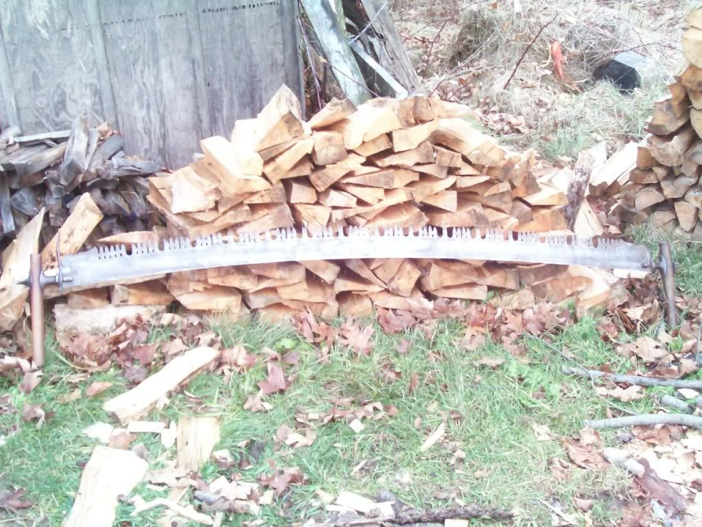

Bringing this thread back with oodles of pictures. I hope I haven't posted any of them already
Disston Toledo 598 felling saw with perf-lance teeth and western handles (mismatched, one atkins and one simonds)
Disston Keystone felling saw with perf-lance teeth and original loop handles, also; hand built (and I mean it, those were originally 10" dead pines) and my little Mann 2 1/4 pounder
Simonds red end 4' bucking saw with tuttle teeth and climax pattern handles

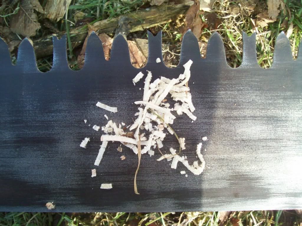

The keystone ran smooth and without much effort...after i address the teeth, clean, set, sharpen and swage, I expect her to run like a hot knife thru butter.
only ever seen 2 saws bigger than the 36s that are common, one is hugely overpriced the other was a choice between a chainsaw and a 52" with worn teethYou will be amazed when you see how much better a bigger heavier saw cuts. Even 48" makes a big difference compared to a 36".
With the 36" I'd recommend moving the supplemental handle back near the D handle and use it to apply downward force on the front of the saw. With the bigger saws you just pull it back and forth and let the weight of the saw do the work. Much easier cutting.
apparently this was my thousandth postonly ever seen 2 saws bigger than the 36s that are common, one is hugely overpriced the other was a choice between a chainsaw and a 52" with worn teeth
