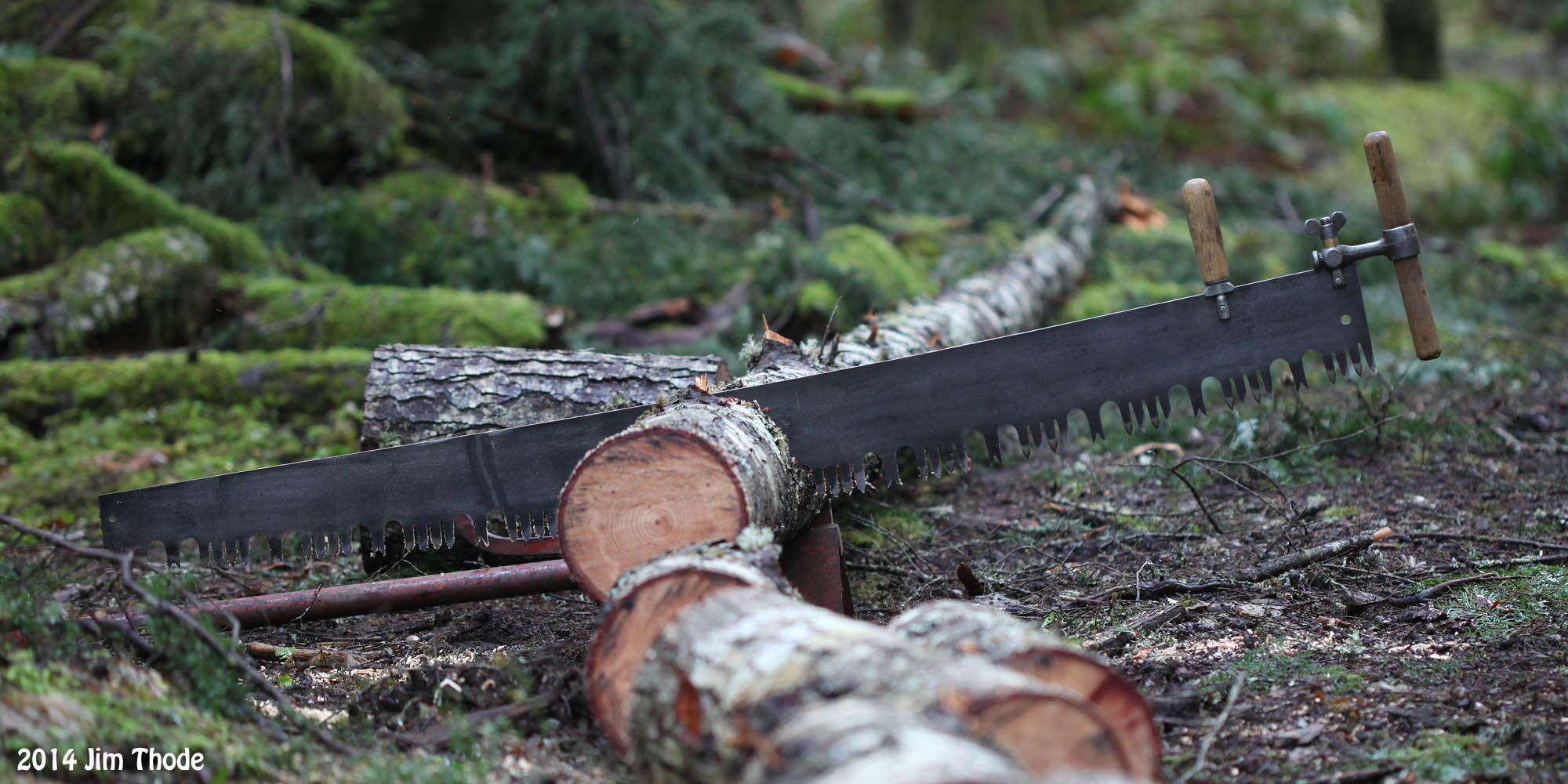

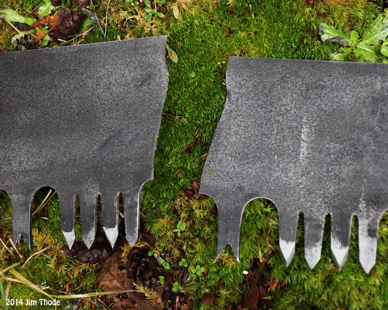

Talking about welding on saws, this saw has likely been welded on more then any saw. The saw left the factory way too hard and either had several or developed several cracks in the blade soon. I pulled it out from under a steam sawmill that collapsed with heavy snow a few years ago. Other then being too hard for its own good it was a quality saw with very little wear, most likely a Simonds Royal Chinook falling saw. I cleaned it up, sharpened and put it to use cutting firewood. No too long after I put it to use I flexed it too much and it broke in two at about the 1/3 point. The longer section still worked as a shorter saw but just for the fun of it I decided to try welding it back together. After welding the break and welding up a few cracks in blade I've cut about 10-12 cords of firewood with it. I'm sure it is not as strong as a "normal" saw but it is serviceable. Because it is so hard it holds an edge very well and I've cut about four cords before having to touch up the saw. More pics of the welding at: http://www.pbase.com/jimthode/welding_a_saw And the full story of the saw at: http://www.bchw.org/Tech tips/sharpening/Saw Reconditioning.htm
The break:
Back in service:
Jim
