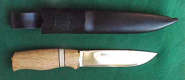

The little hatchet is a GB mini.
The FB is a Helle Jegermester (Sandvick SS)
The SJ is a Queen D2 canoe.
