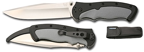

while out on the trail today, I started becoming a little disenchanted with my Benchmade Skirmish. It's my go-to knife for quick trail hikes where it's nice to have something small which will helps me prune my trails.
The pivot is undersized for this type of use, (no fault of Benchmade's), and the flat handle is kind of uncomfortable. Other than that, it's a pretty strong performer in many regards. The pivot, lock and stop pin are starting to show the effects of the heavy use this knife is seeing, so I know its days are numbered, at least if I keep using it:(
I'm looking for ideas and suggestions on the ultimate folding chopper. Features, materials, shapes and textures, and makers are all important considerations. As is size, and I think that with a maximum of 5.5" for the handle, it should slip into a pocket pretty well while still allowing around 4.5" of blade.
I do not think that there is anything like this out there. I'm hoping that someone will prove me wrong:)

benchmade LFK
I have one, it's not a chopper. I'd hardly depend on a liner lock for chopping work. Then again, I wouldn't depend on a folder as a chopper unless it was a last resort.
