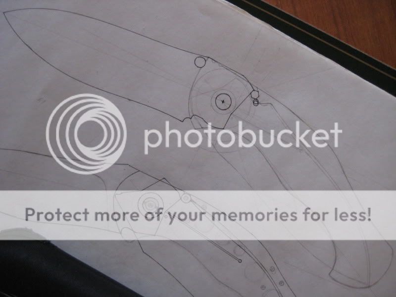

The design is cool but for me I prefer a little more belly. I feel the way your blade straight with the handle would take a bit away from the force behind a chop. I could be wrong. I like my blades to stick out just a little so the cutting edge meets the target a tad before my hand is level with it.
you're right Jon. I think I'll tweak the design some more, removing more of the backspacer to allow the edge to drop some, and then take a little off the spine as well. Pretty happy with the handle design for the most part, but there is definitely room for refinements especially since this knife won't be cheap to get made. I know who I'd like to have make it for me, and so far he hasn't said no, so we'll see what happens I guess.

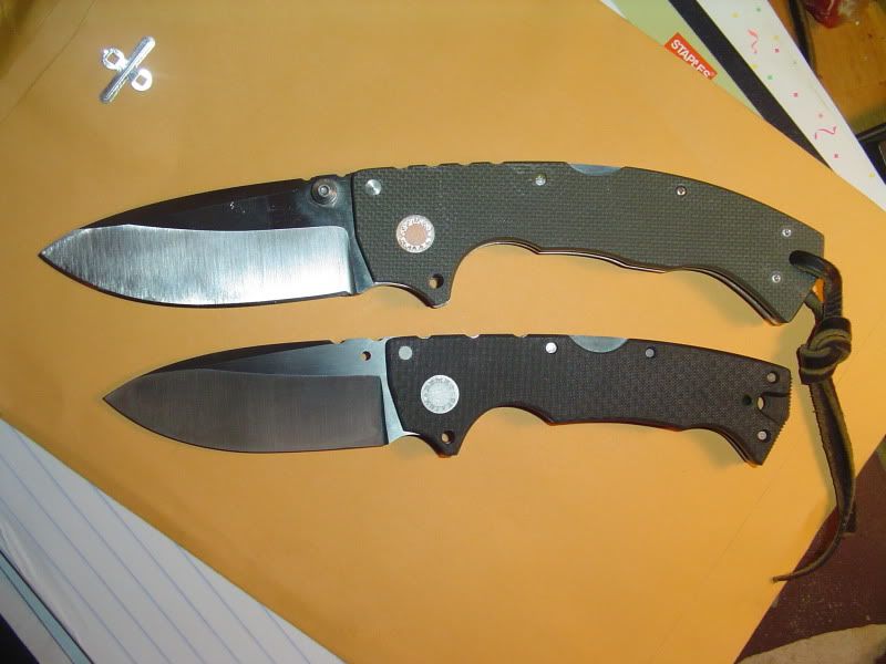

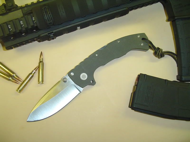

I got in touch with Andrew Demko, and he sent me these pictures;
The big one is his new 4MAX design which he said is meant to outperform most of the 4" bladed folding knives currently available. I don't doubt that he's on the right track. This is a pretty amazing design.
Hopefully I'll get a pic or two of his Rajah proto at some point.
I just have to say, that he was extremely fast and thorough in his response, I was very impressed.

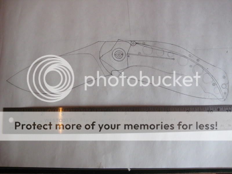

this one has a little more drop than I expected. It's quite difficult to design a folding knife- every one thing affects the other, and not just changing lines here or there to dial in the flow, but mechanical interference is a whole other thing. Anyway, this is a lot of fun! I need to get a proper drafting table.
5 1/4" blade;
I'm getting pretty close to a final design. The most recent isn't complete yet, but I'll post it when it is.

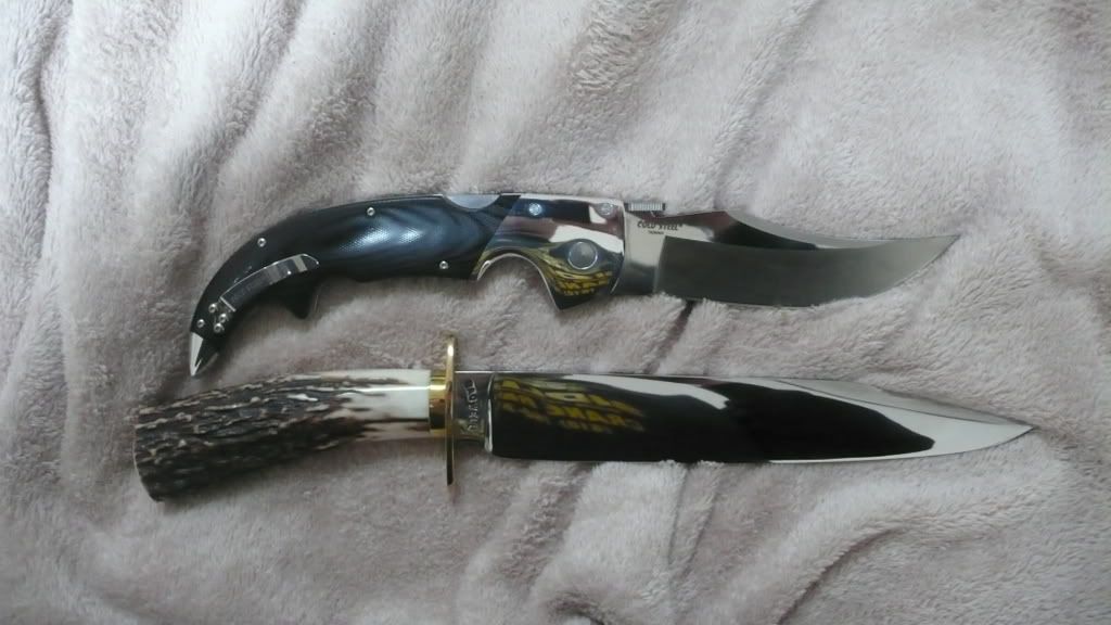

Try a cs Espada they have a strong lock and are big
Here is the mid size one with a 9 1/2 inch blade Bowie for comparison
I still do not suggest a folding chopper my friend
I disagree. Try a CS Spartan chopping through a 2x4, and you'll rethink that. Would I choose it, or any folder, over a comparable fixed blade? Nope. But there are good folding 'choppers' outh there that would definitely work.
