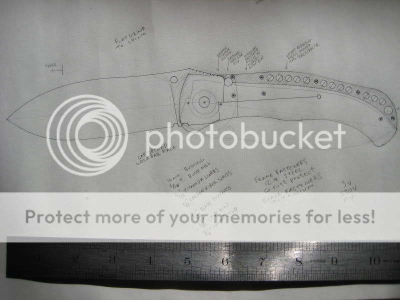

I'll bet that both of those locks are designed to resist closing forces, I've seen the CS test with the vice. Pretty impressive. I've seen that ball lock thing, but only once. It's pretty cool too. Very innovative.
However, I think that what I'm looking for is a folder which is strong in the opposite direction...
Maybe a locking liner is enough. An important attribute would be for the lock disengagement mechanism to be WAY out of the way. A locking liner would allow a largely symmetrical handle and comfort for my poor beat up hands.
I wonder how many different kinds of locking mechanisms are out there?
If the backspacer were robust enough and supported in the right places it might provide the kind of support needed for impacts. The material would have to be really hard I would think, so no carbon fiber or mokume. I'd even go so far as to use the exact same material the blade was made from.
Are stop pins usually harder or are they usually softer than the blade tang?
Would a hidden stop pin, plus a backspacer as blade stop get us there?
