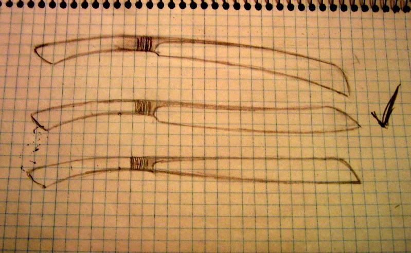

Initial concept of the "Marchete"
10"handle
18"blade
Forged from 1/4" 5160 stock
3/4 tang
hickory "axe" type handle.
Here's a preliminary doodle, I'm thinking the middle one....

That second one looks sweet. I'd be careful with a round profile handle though as it won't index well. I love the blade shape and the handle looks great you just need to be able to know the angle of the blade by the feel of the grip on the handle. Mac

Pict..... I never make my handles round, for that very reason.:thumbup:

Very Golok like Rick.... Those look great!
Im diggin the first one, it has great lines. Any of those would be waay cool though.
As nice as the second one is, I actually like the look of the third one quite a bit too! If you flared it slightly towards the point it could be quite a contender as well!
Good stuff, Rick, as always!:cool::thumbup:
Wow. That's awesome Rick. I had a similar thought but different. I used it for a Dao-ish sword design though (bottom one). I like yours better though for a machete. I did these last week but will go with something like the smaller one. The top one. It's a 12" bolo design. It is the size I would use out here and what I am more comfortable doing.
