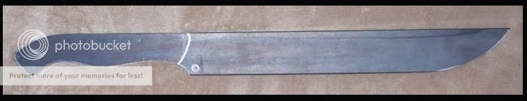

I got the Blank cut out and have started grinding. Here is the blank and I messed around a little in Photoshop to get an idea of how it COULD look!

that's might nice.
i'd get rid of the lower lanyard hole and cover it with scale material thouugh.
machetes are finicky with stuff like that IMHO.

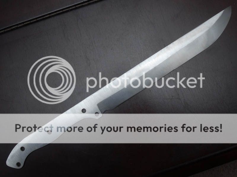

I got the bulk of the grinding done, I still need to clean it all up... This is my first time working with 5160 and I really like it, I normally use Precision Ground O1 which I miss the "Precision Ground" Part!
