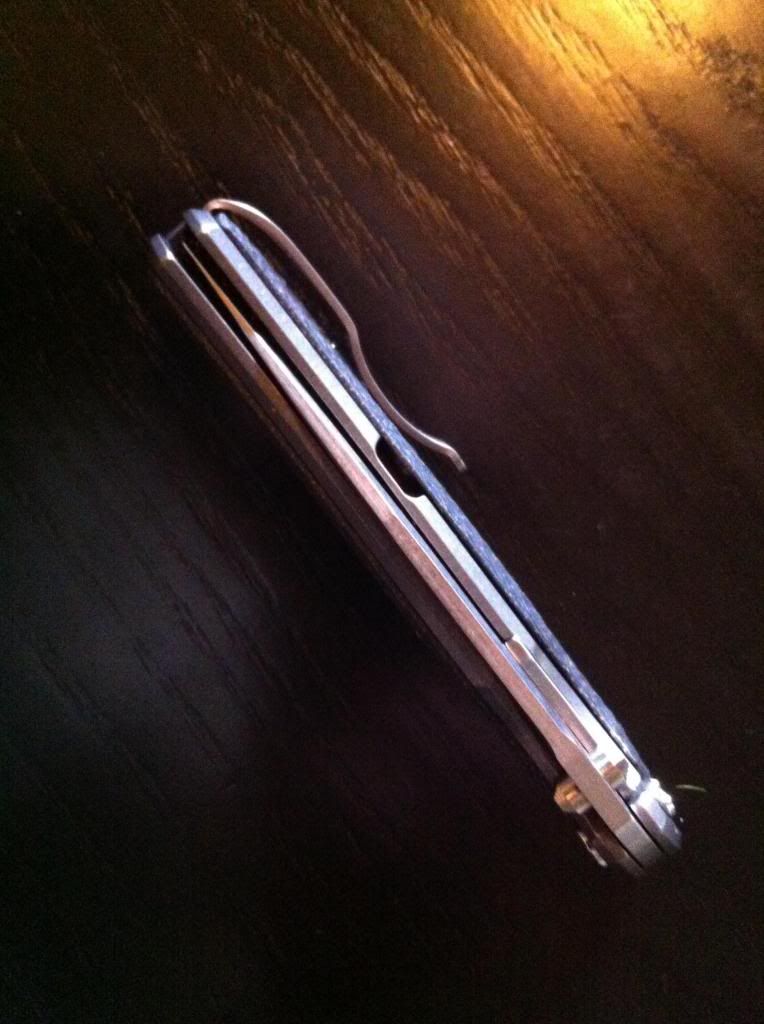

Follow-up on my Fire:
I sent it back to Matt and he took care of me. Turns out the Pivot screw had come loose causing the lock bar to push the blade to the side. Not much of a concern since this thing fires SO hard. Matt tightened up the Pivot Screw and used some loctite. If it needs tightening down the road Matt said a simple number 10 torx driver is all that is needed. It feels much tighter now, and a bit harder to fire, but I'm sure that will loosen up a bit. Either way I'm excited to get it back and that Matt took great care of me. :)
Pic of how the blade looks now.
