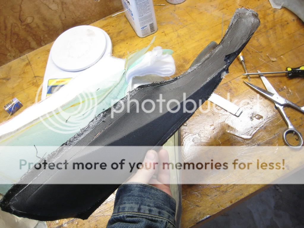

With the guard rough fit, it is time to make the handle. This will be a "dry run", in that I am going to test the procedure out with low quality resin as a proof of concept, so I can tweak my process before I make the final handle.
With composites, the name of the game is "preparation"- you have to have everything ready before you mix the first batch of resin.
First, since this will be a unidirectional handle I have to get a bunch of fiber ready. I just used a bunch of scrap material I saved and pulled it apart to get the fibers all in one direction.
As I pulled the fiber apart, I sorted it acording to length until I had more than I would need. Again, better to have more than you need than run out of fiber while you are all sticky and your resin clock is ticking.

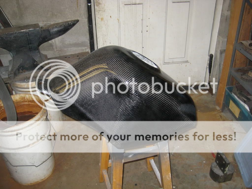

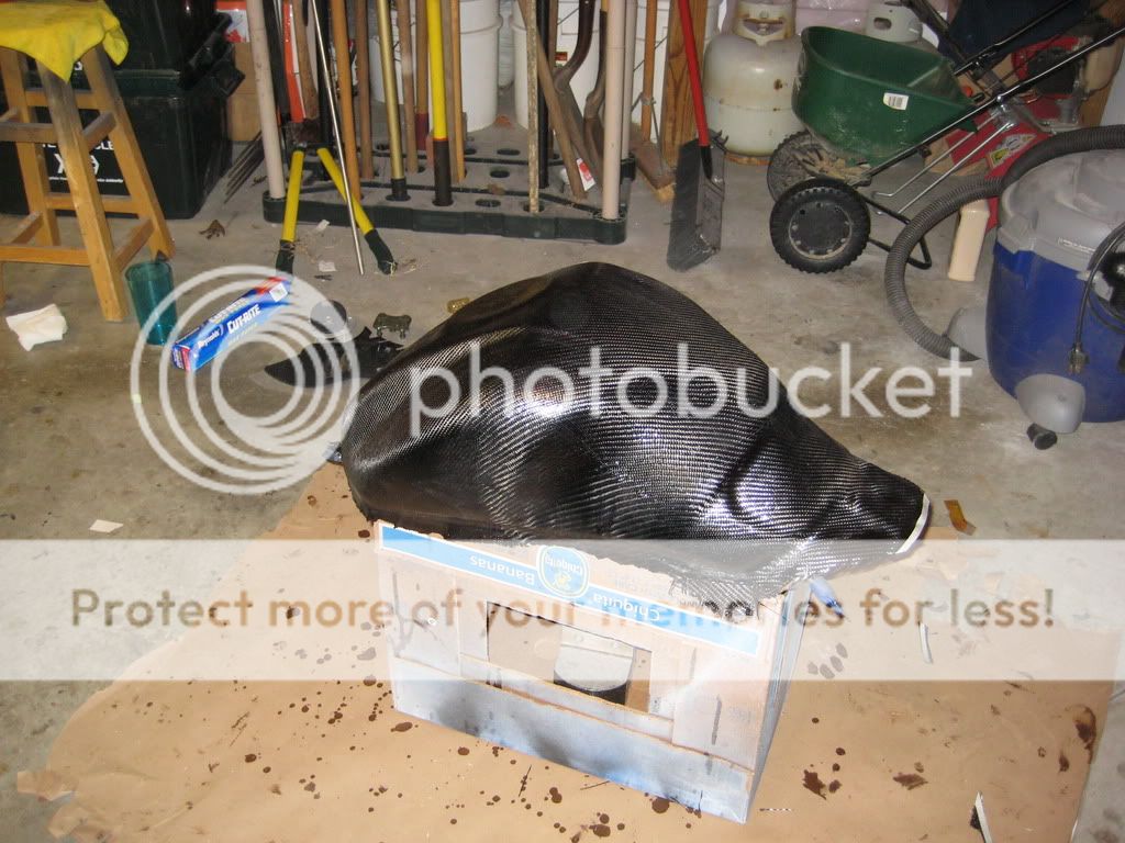

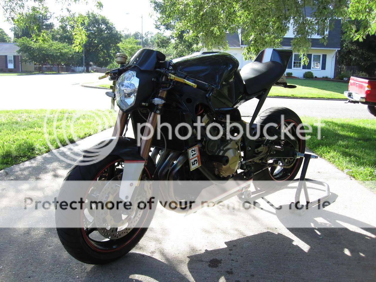

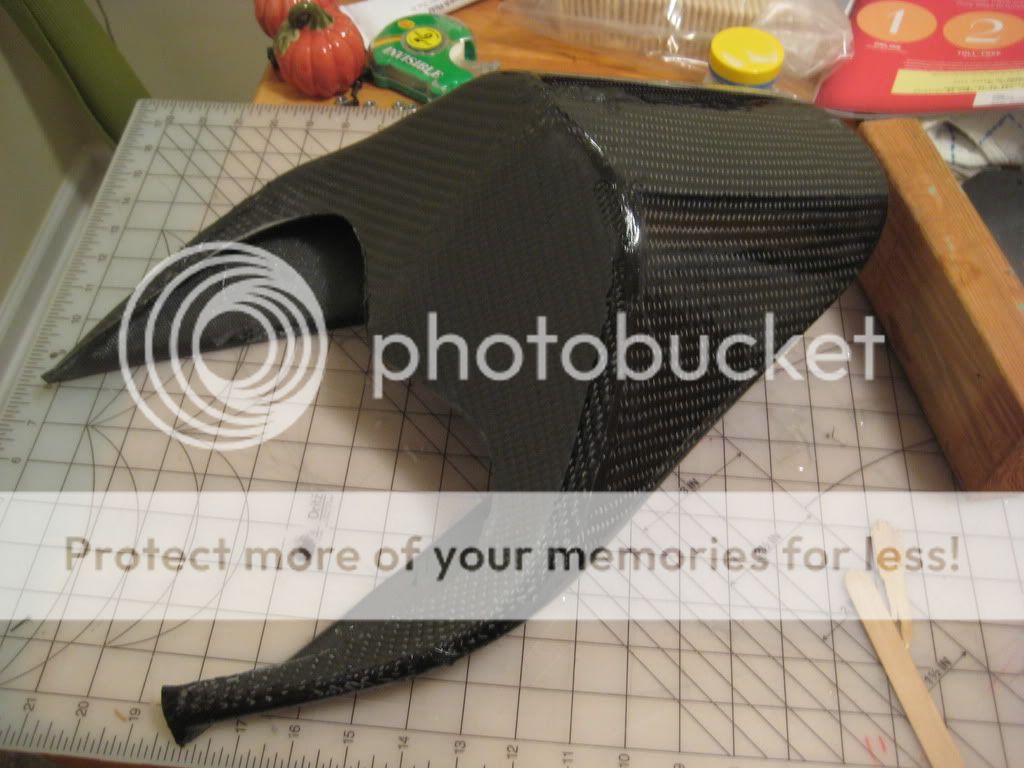

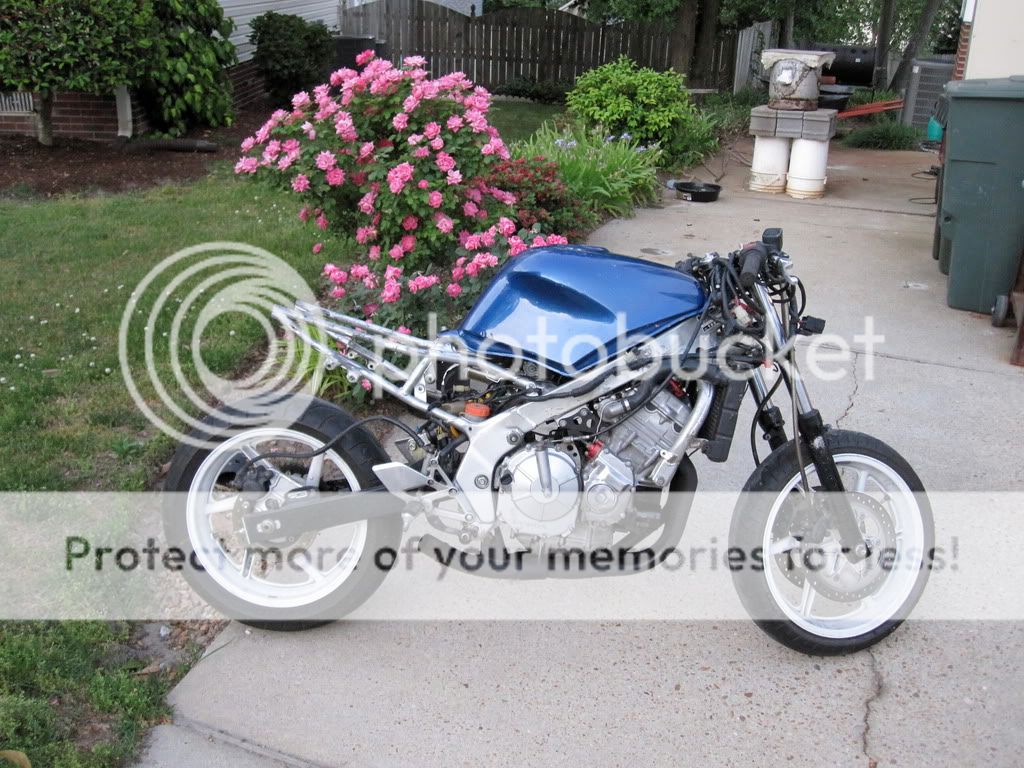

here is some motorcycle stuff:
seat fairings:
one piece tail unit:
Covered my tank and couple friend's tanks:
here is what the bike looked like brand new:
what it looked like when i bought it:
here is the bike when i finished it:
all the fabrication, machining, mechanical, welding, and paint work i did myself.
