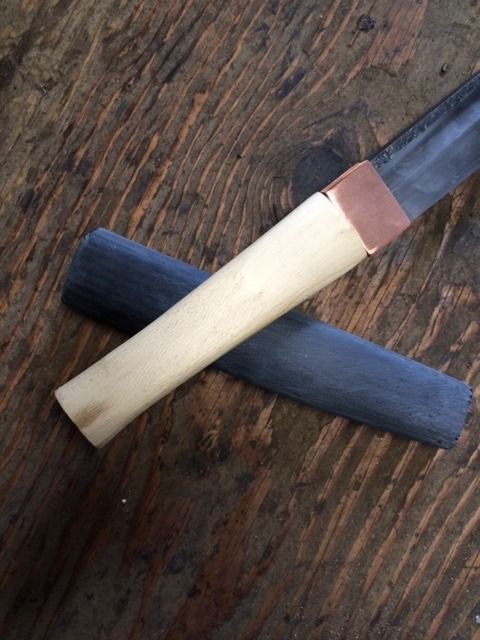

Future versions of this will be from W 2
It's all in the heat treat
Quenching this blade
[video=youtube_share;eb9ZCyvf8uQ]http://youtu.be/eb9ZCyvf8uQ[/VIDEO]

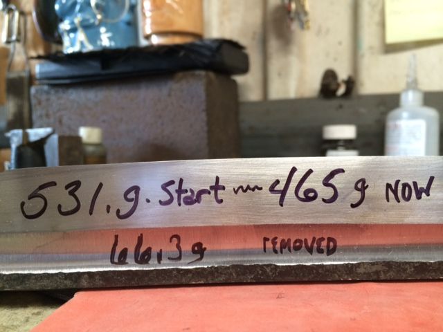

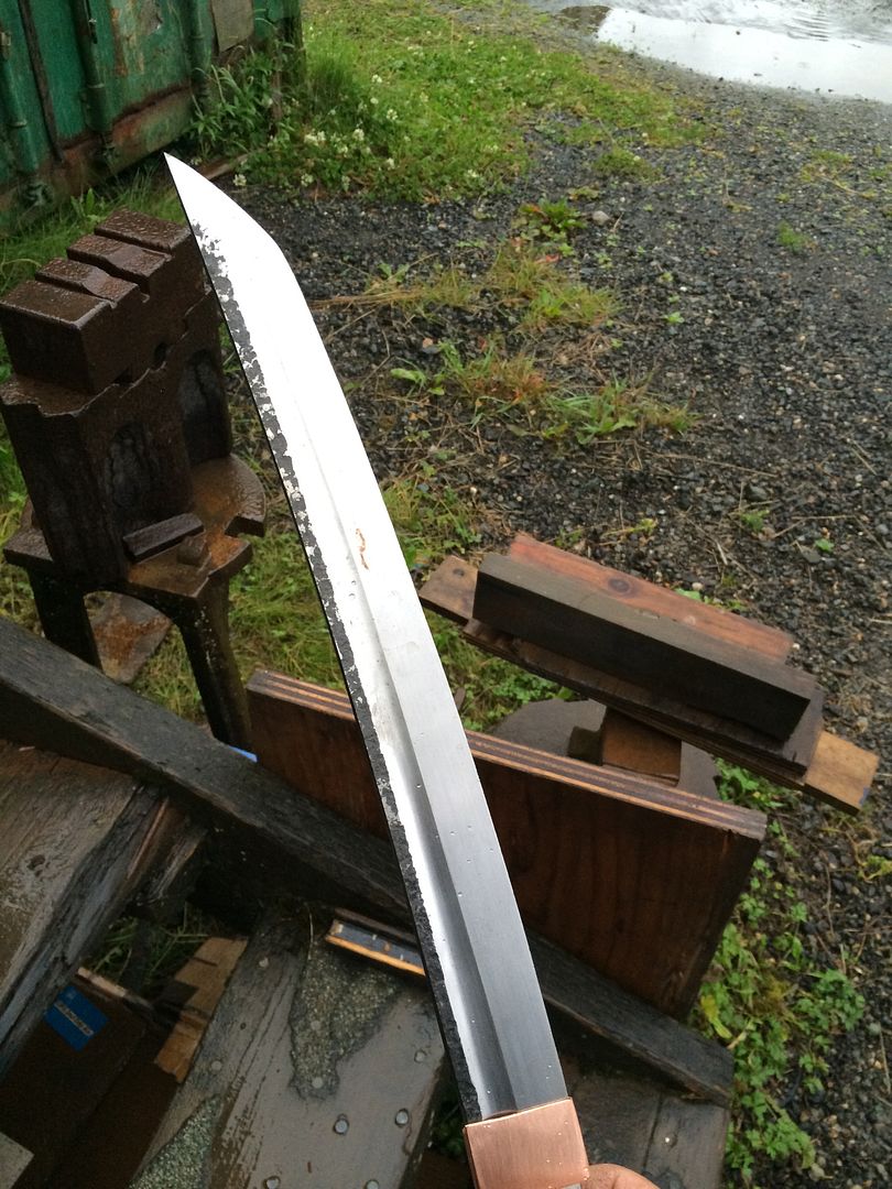

So this blade is 15 inches long and exhibits some wonderful Sori (curvature)
Before BoHi (fuller) was carved in
After BoHi (fuller)
Now a lot of people truly do not understand what a fuller (BoHi) is for and I've even heard some on here refer to it as something cosmetic
A fuller is not a blood groove :)
It is a way to lighten and adjust balance of a blade
Yes when done well they can look very cool :)
Weight saving after BoHi
The blade was left with rough forge marks in it to keep cost lower and to emphasize its utilitarian or battle field purpose
The tip is Shobu Zukuri : Which loosely translates to Iris leaf shape. What is most notable is the absense of a yokote (border line between the tip and the cutting edge) and a graceful, curved slicing tip that was used to great effect against the Mongol leather armor during their attempted invasions in the 13th century AD.
This tip style is one of my favorites and makes for a beautiful sweeping tip

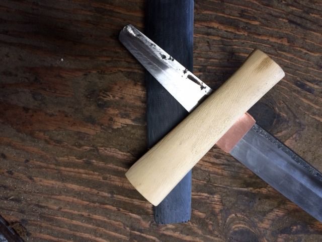

The Tsuka (handle) is a study in function
The traditional Japanese handle is hour glass shaped and that is for a reason
It gives fantastic purchase
For this handle David took it to extremes and shaped the handle in the classic hour glass shape but with some design changes. He left the front fuller to facilitate pivoting and gave it a slightly longer taper to the butt
The flare of the butt will be exaggerated when the Kashira is added
