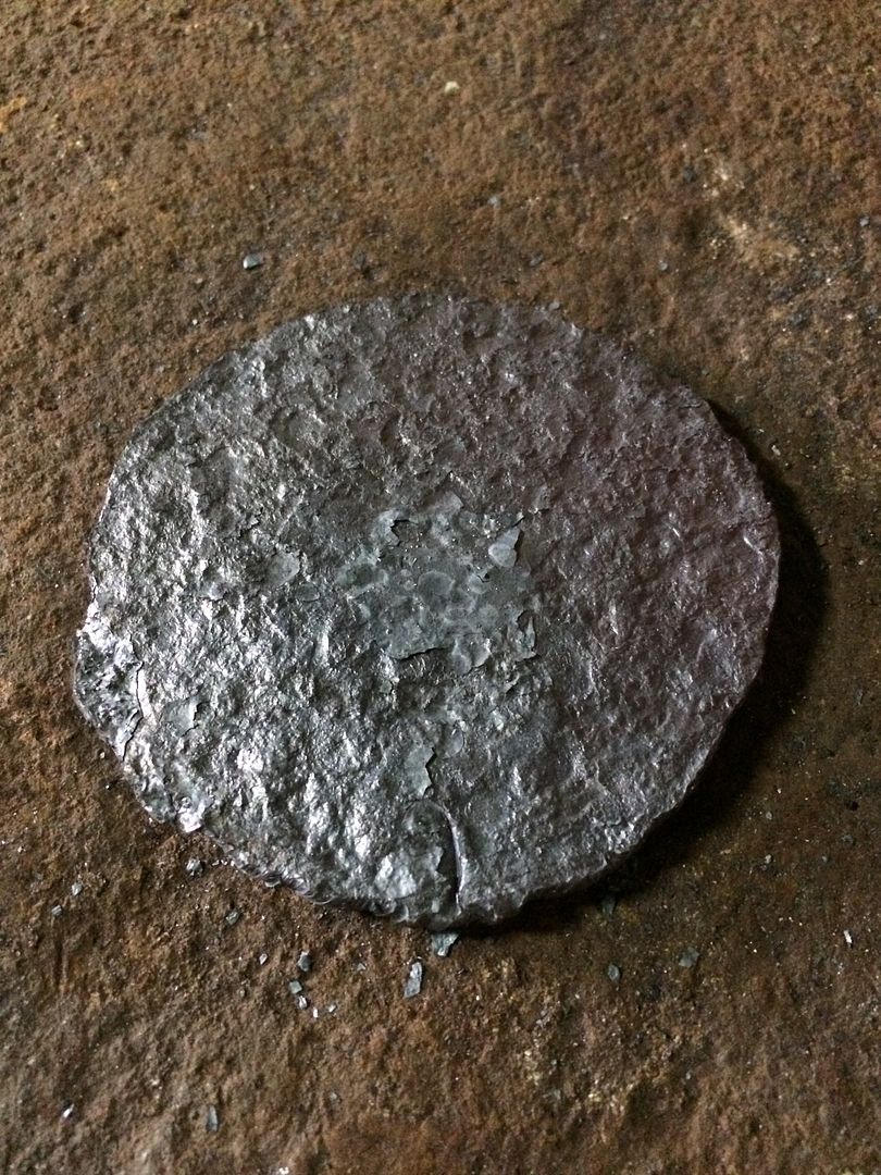

There are many materials to make the guard (Tsuba) that distinguishes this as a Tanto
Many would choose titanium in this day and age

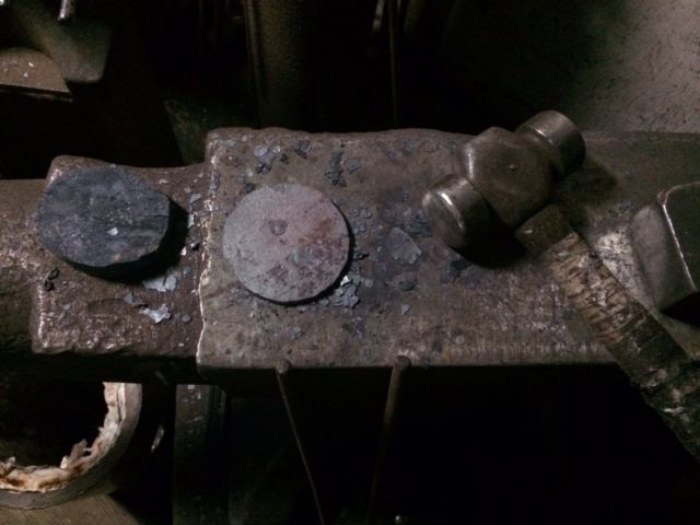

I choose iron
Why ?
Not only is it the traditional material.....I like iron for many reasons
One I don't mind the weight in this part of the piece
Weight here gives the blade a more neutral balanced feel
Next
Not that I'm planing on having a blade run down my blade and into the guard but it is what it's made for and a forged Iron Tsuba excels at this
Next

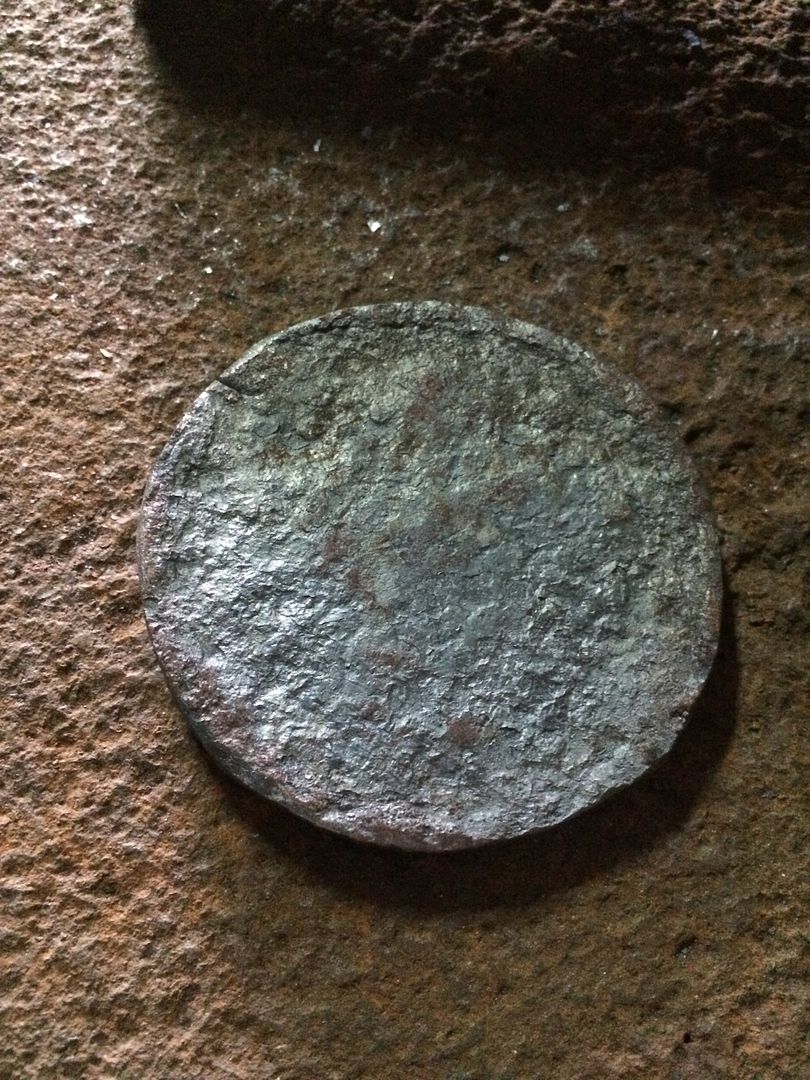

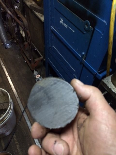

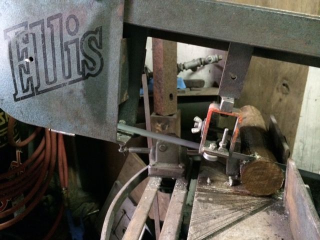

This is wrought iron, smelted at the Treadwell Foundry in Juneau around 1900. They had the most state of the art foundry on the west coast at the turn of the century, supporting the many area gold mines and actually building much of the machinery used.
So it is rich in history

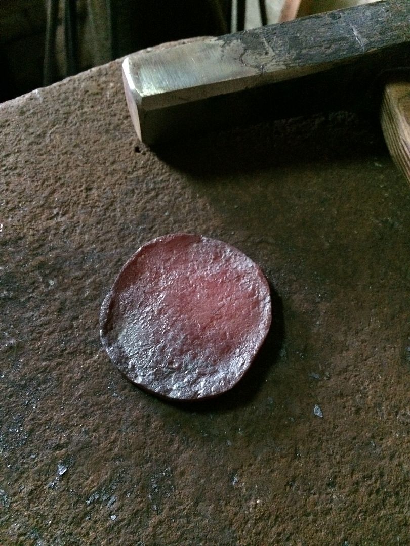

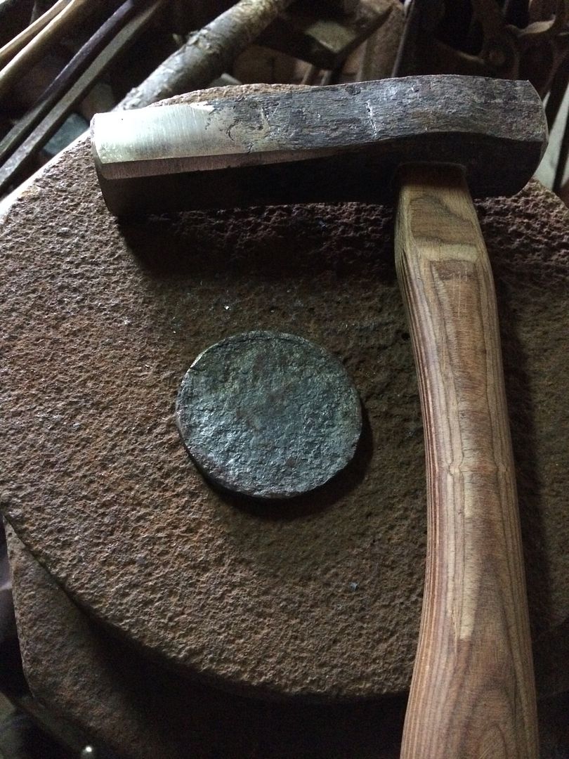

Tsuba work
From David :

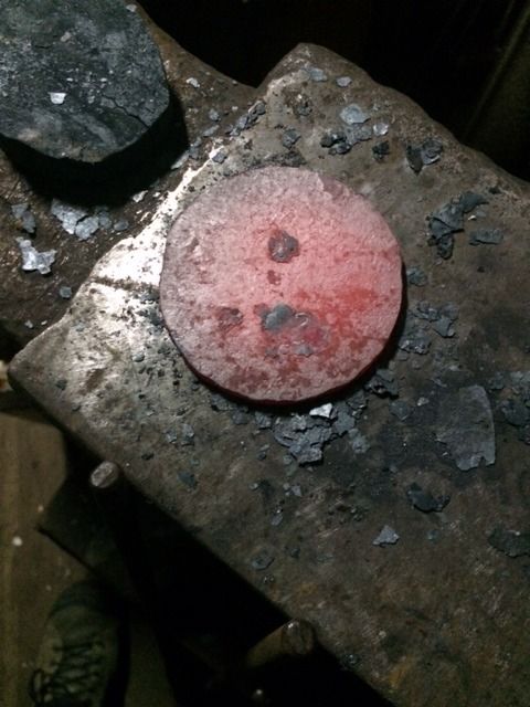

Working on the texture, then the rim...
Forging the rim causes the texture to become more pronounced and gnarly as it gets distorted while reducing the diameter.
The hammer that I've been using on the rim was a gift from Claude Beauchenville. Love it!
Thank you Claude!
Claude is another Artisian in the forge
He made that Hammer and gave it to his fellow Artisian
Great gift between two wonderful artists
Both of these men share a kindred spirit
Masters in the forge and men of true merit and steel
