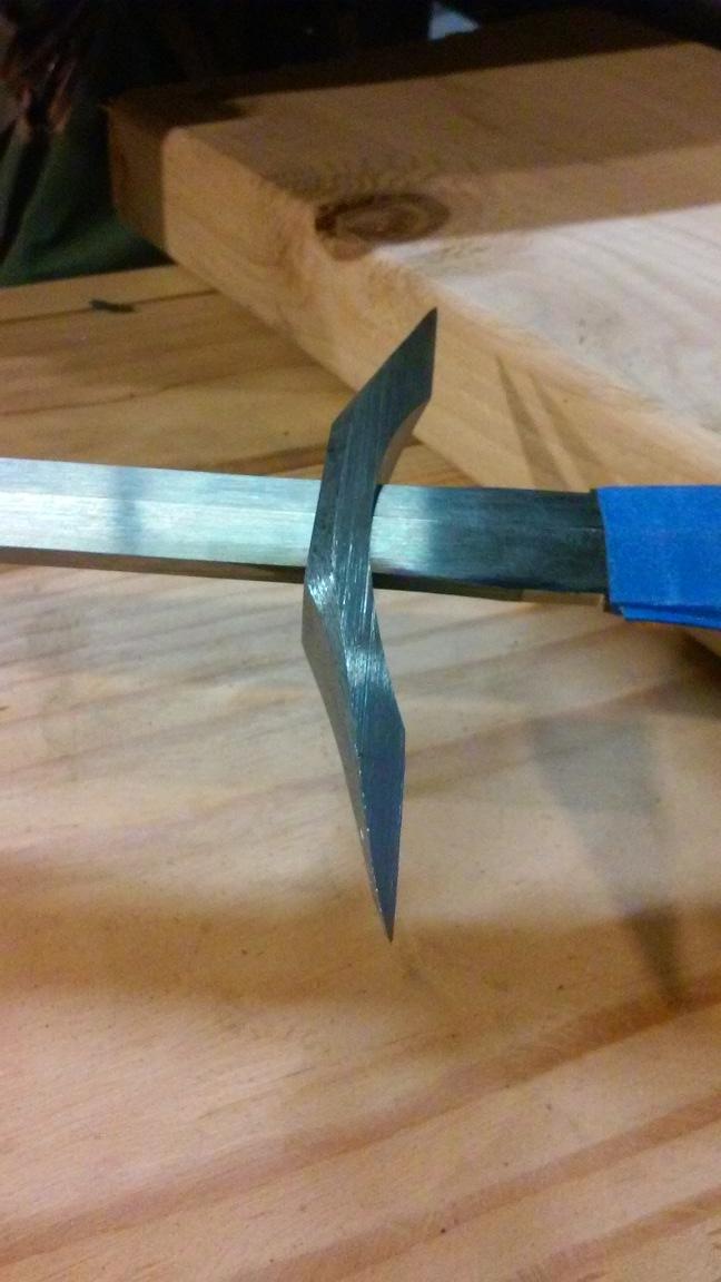

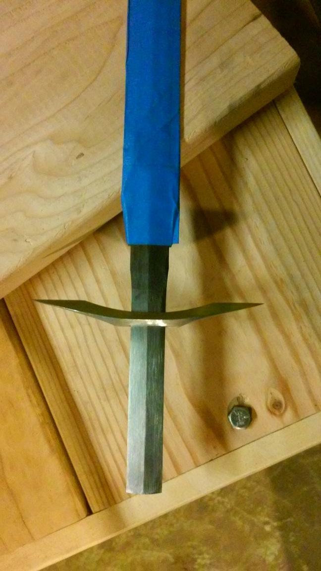

Getting cut while making them is my problem. Just last night I laid a finger pad to the bone, filing on a pointed wrought iron guard. So fail it wasn't even on a blade! They usually find a way to take a bite before they get sent on their way.![]()
