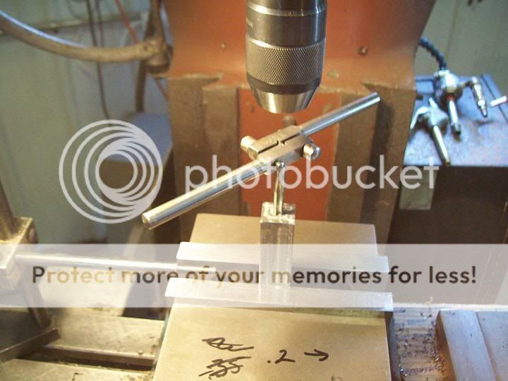

Next I needed to make a square peg fit in a round hole ;) :D

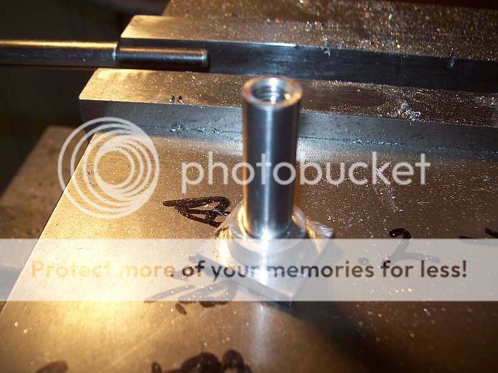

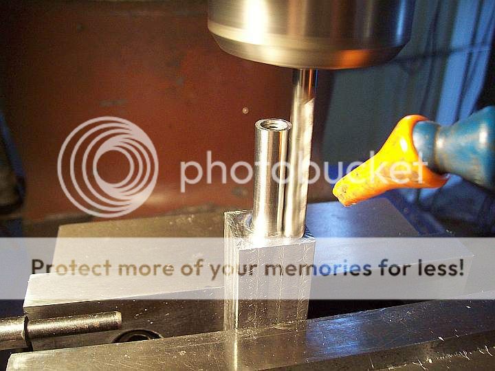

After I had my finial main shaft milled I needed to mill a flange .......
After milling was complete I saw cut the bar off leaving a little meat to finish.
Next I'll flip this over, punch a few drive holes, and turn the flange down to it's finished diameter

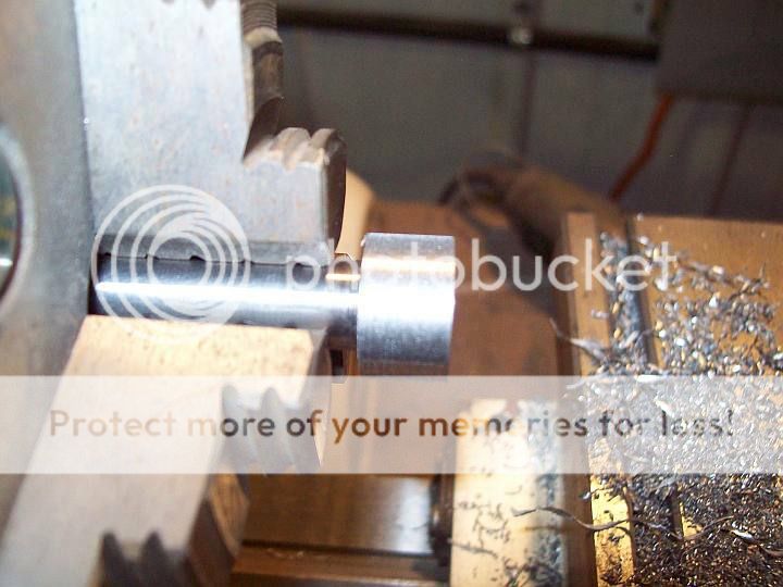

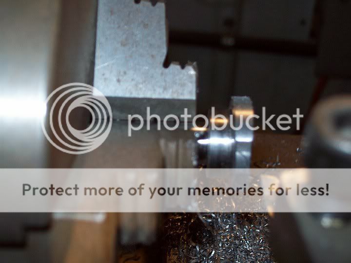

After milling the finial nut there was a bit of turning that needed to be done, specifically taking the major diameter of the flange down to 1/2"
After finishing that operation I set-up to drill a 4 hole bolt circle for a finial nut drive tool I'll be making
I'm down to mostly finish work on this part now :thumbup:

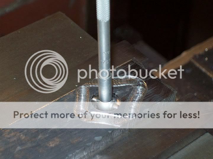

Next I set-up to make the insert for the pocket.
Before I could separate the insert from my main body of stock I first drilled and bored a nice tight tolerance hole for the finial nut body.
After that I milled a counterbore for the finial nut flange to sit in .........

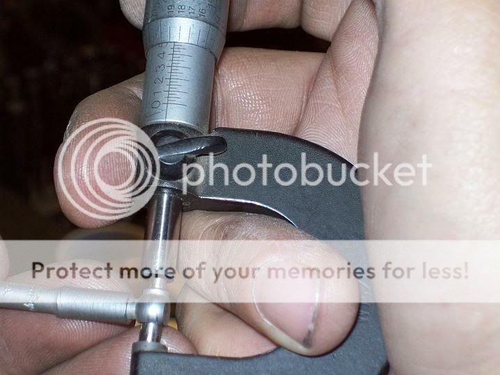

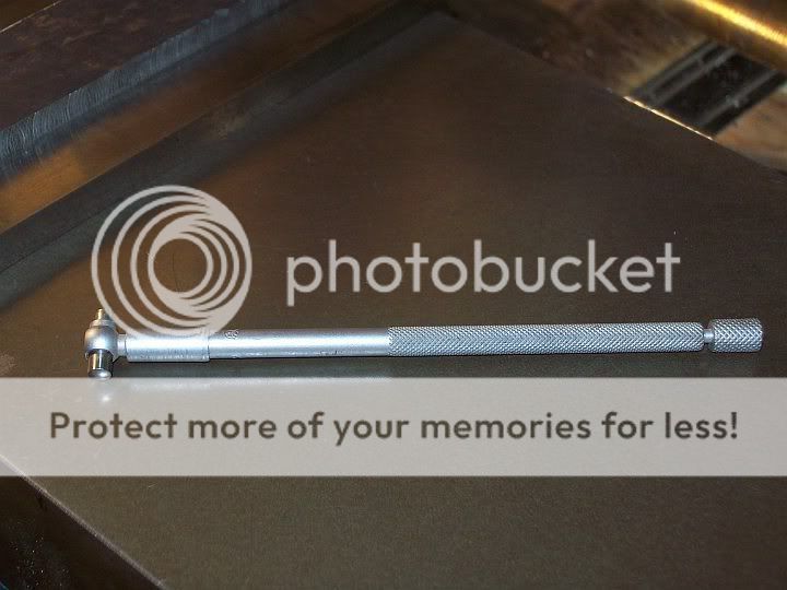

Here I'm checking the counterbore size with a neat little tool known as a telescope gauge. Some old school guys call them snap gauges.
After pushing them through the hole or counterbore once and only once ;) you can mike over the top of the guage to get an amazingly accurate hole size :thumbup: :thumbup:
