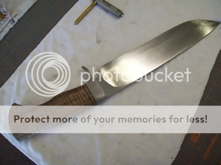

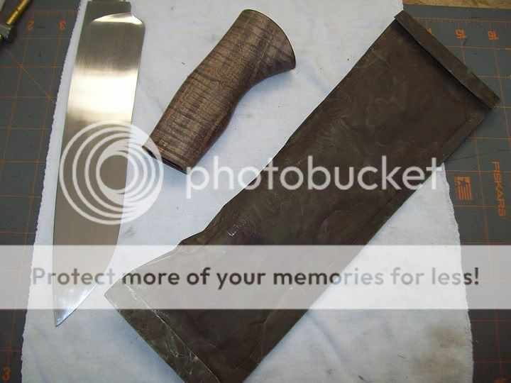

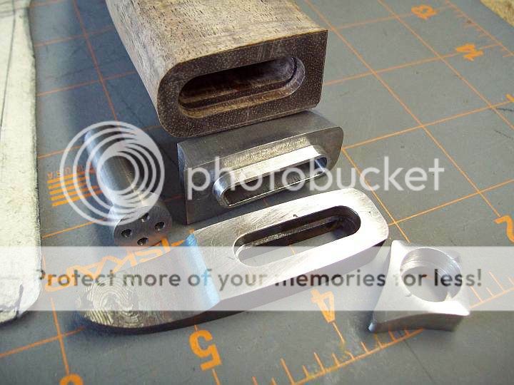

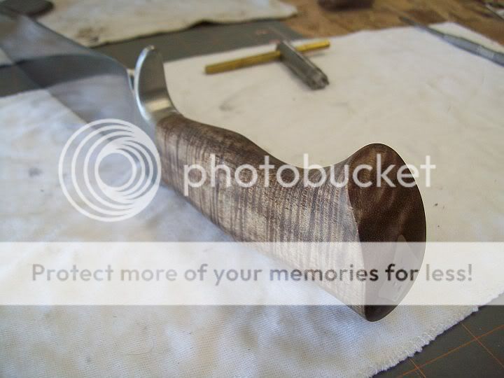

OK, since my last post I've done some sanding and refining of the lines all the way around.
Here's a couple of pics

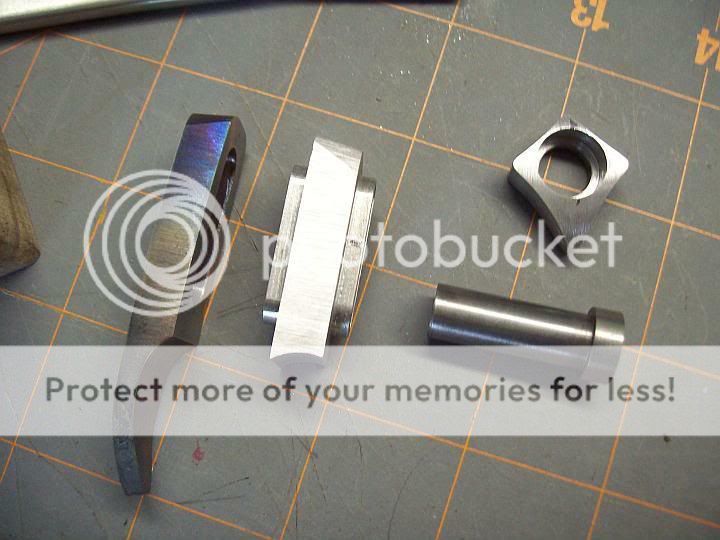

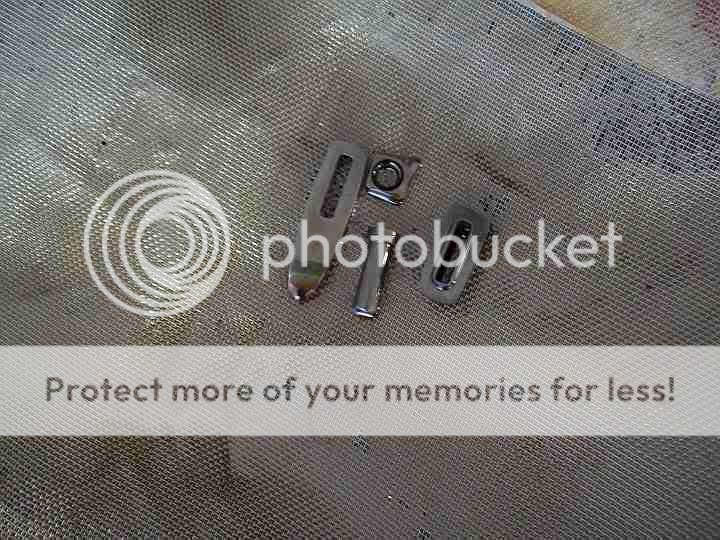

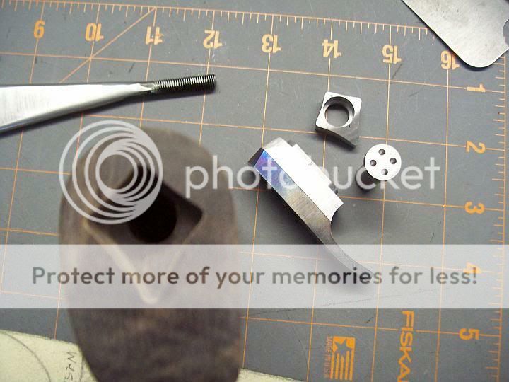

Before I could really start the finishing process, (etching and handle finish) I first needed to harden and temper the Damascus guard, spacer, finial nut, and finial nut washer.
These guys here ............. ;)
Since everything fits so close, I want to be very careful about potential pitting, and especially warping of any kind.
To prevent pitting I'm going to austenitize in a foil envelope.
To prevent any warping or movement I'm dropping my austenitizing temperature down just a bit (to 1475*F), and quenching in a little slower oil than the Parks 50.
I'll be using McMaster Carr High Speed Quenchant for this, which I've found to be noticeably slower than the Parks 50.
Here's the foil envelope with all of the goodies safely tucked away from any oxygen that could cause pitting.

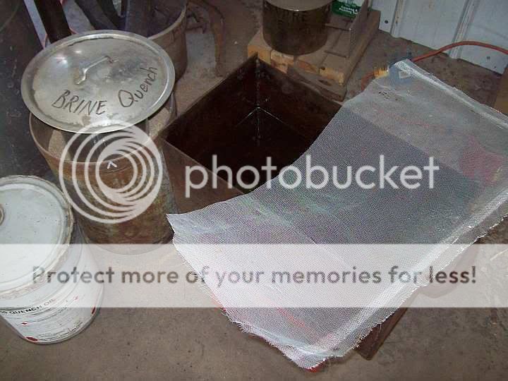

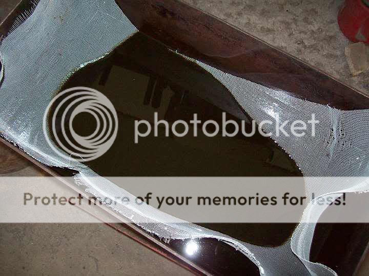

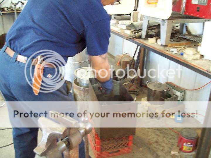

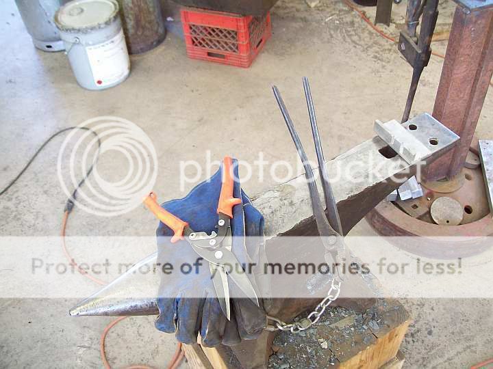

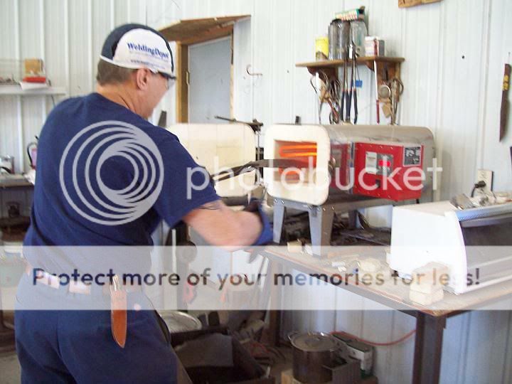

Second thing is to have everything ready and in place when that time comes. After the soak I'll pull the packet out of my kiln, very quickly snip the end of the foil pack off, then dump the contents into my quenchant. I put a piece of steel screen into my tank to soften the fall and give me the ability to agitate the parts until cool.
Here's a pic of the Quench Tank I keep my McMaster Carr Oil in, along with the screen I'll be using.........
And here's the screen in position ............

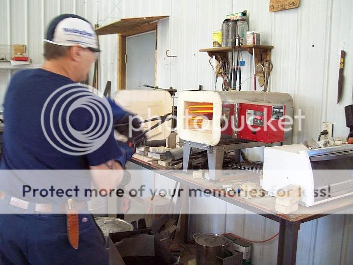

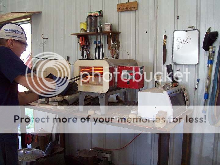

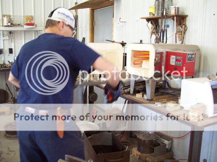

So here we go, into the pre-heated kiln for about 10 minutes ......................
And like I said.......... I have everything in place and ready for the quench
And here's the series of pictures showing the quenching process of the fittings.
I'm moving so fast it's a blur ;) :D

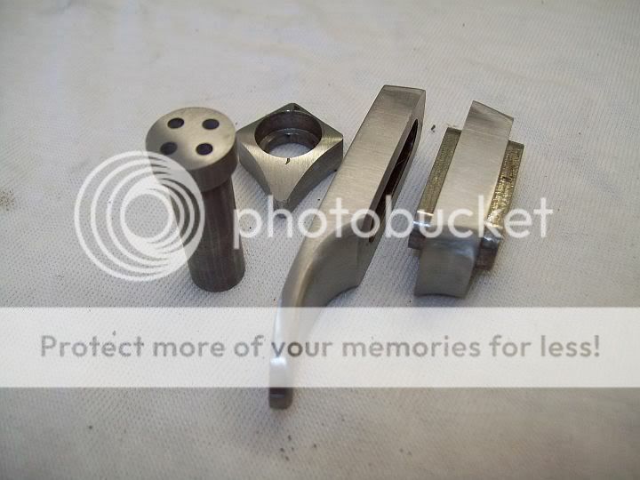

Nice and hard, no warps or pitting, and everything fits just as nice as before it went in.
I think they came out perfect !! :)

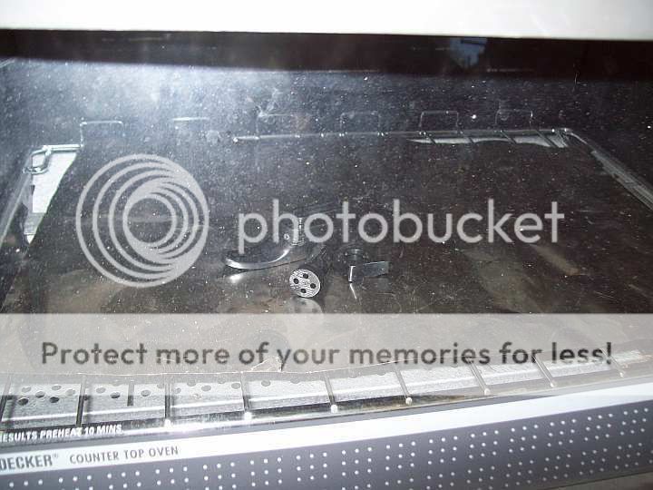

So it's into the tempering oven for an hour x 2
And that's where we're at, dinner time, 9/6/2011 :D :thumbup:
