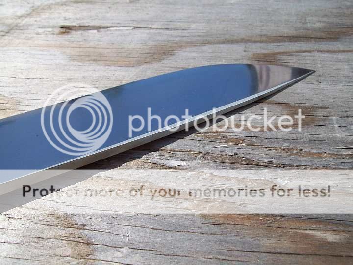

Here's a few pics of the knife, just after hardening and tempering of the fittings (you can still see the heat coloring in them). These pics were taken just before I started chopping and making the YouTube Video.
You can also clearly see the swedge. Just like we had planned, it starts at the tip and finishes as it blends into the large radius of the grind plunge.

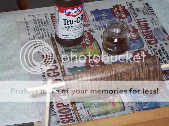

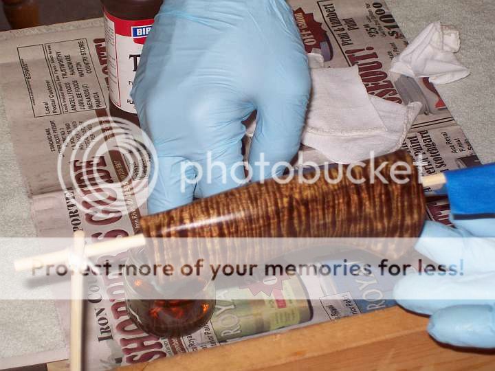

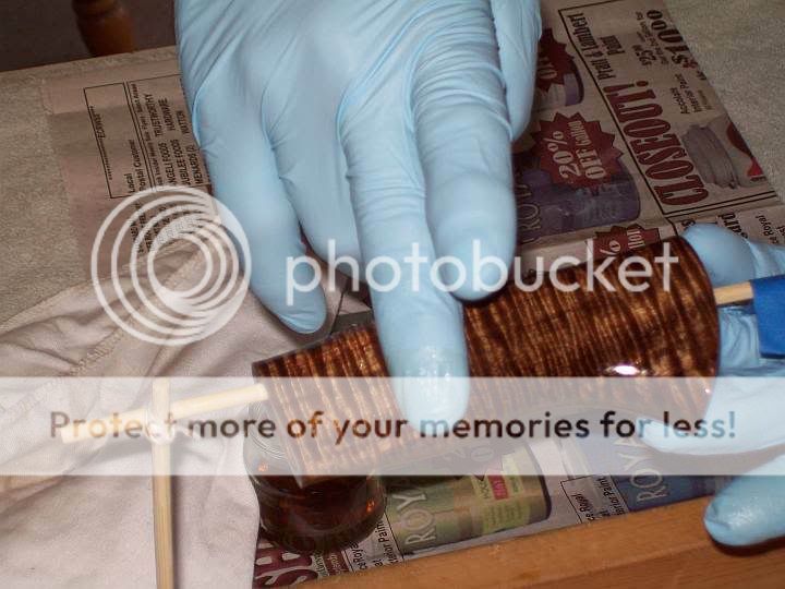

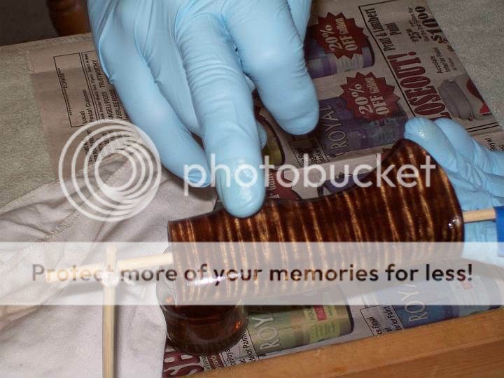

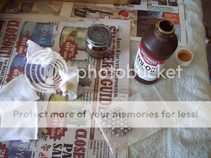

In regards to the AAA+ Koa handle, even though I sent the block out for stabilizing, I've found that most stabilized wood handle materials look much better, if they have a traditional gun stock type oil finish applied to them. I've been using Tru-Oil with excellent results.
I don't however, use it as it comes right out of the bottle, I find it much too thick to use as is.
When I'm getting ready to finish a handle, I mix up a small batch of 2 parts mineral spirits to 1 part tru-oil, applying ~ 5-7 very thin coats. I apply each coat with my fingers while wearing nitrile gloves, allowing each coat to dry overnight.
:cool:
I've heard a bunch of folks mention buying a bottle of tru-oil only to get one or two handles finishes out of the bottle before it thickens and hardens to the point where it's unusable, making ~ 3/4 of the bottle a waste.
I can't remember who told me or where I heard this tip, but it works great !!
After opening the bottle, it's imperative that you fill the bottle with something (I use steel ball bearings) to bring the level back up to the very top edge. You must fill it to the point that, when you put the cap back on, there is zero air space left in the bottle. I've had this bottle opened for well over a year now, and used it to finish at least a half dozen handles, and it's still the same consistency as the day I opened it.

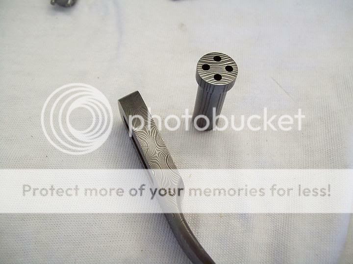

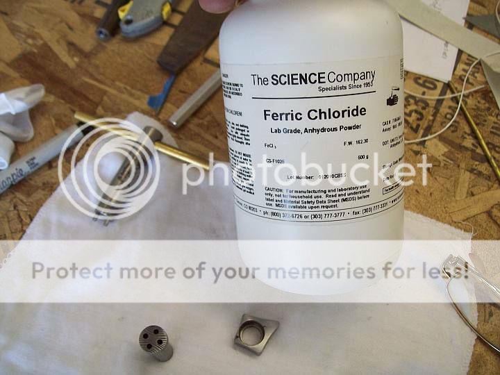

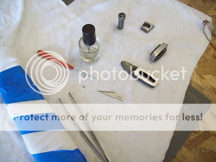

At the same time I'm finishing the handle I'm also etching the fittings.
Like many knifemakers, I use a dilute mixture of ferric chloride crystals and distilled water, about 4 oz. of crystals to 1 gallon of water.
To prevent my etchant from eating away the areas I spent so much time precision fitting, I paint them with a "resist". I simply use my daughters finger nail polish thinned out a bit with acetone .........
The guard, the spacer, the triangular shaped finial nut washer and the finial nut, are made using one of the very first "properly made" Damascus billets I made. The Billet was made while working, and learning to forge weld with Kevin Casey.The guard and finial nut washer are made from a 2 bar 1080/15N20 Turkish Twist pattern. The finial nut and the spacer are made from the same type steel, but in a simple straight pattern. I thought that would look great with the Ladder Pattern Blade and the heavily tiger striped like Koa Handle material.

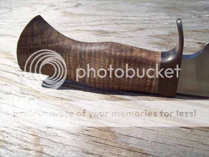

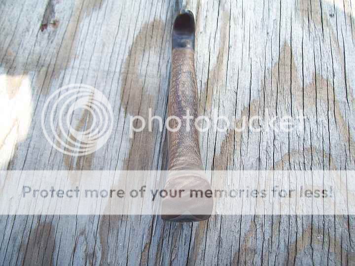

This Knife project is coming to a close. Since my last post, I've added several + a couple more ;) , coats of Tru-Oil to the handle.
Today I'll be applying some paste wax and giving the handle a final "soft cloth rub"

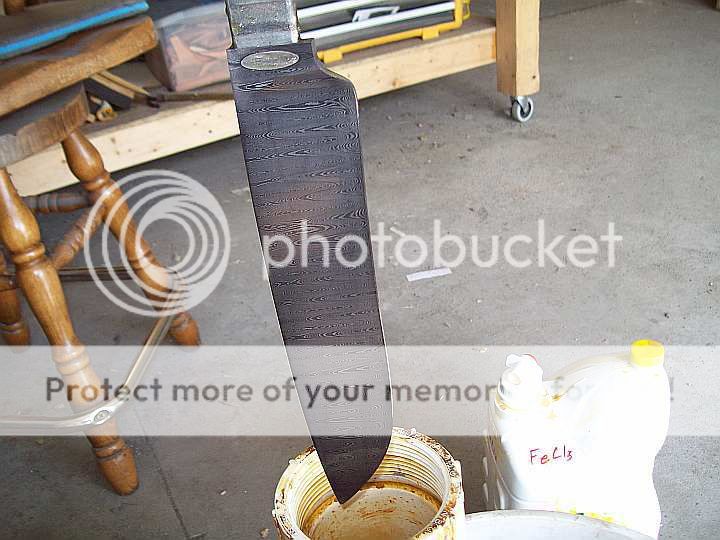

The Blade has been etched, as have all of the fittings.
Here's a picture of the set-up I use to etch long blades. Pretty simple, and from what I've seen other knifemakers use, it seems to be "standard procedure"
4" PVC pipe, capped on one end. Even though I store my etchant in a separate container, I've added a screw on top to my etching tube just to keep it as clean and gunk free as possible :)
Here's a picture of what the blade looked like about mid-way through the etching procedure
