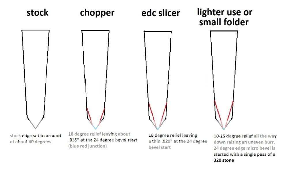

My utility edge is hand done and is pretty much a 'stock' bevel. Gaston444 explains the EDC SLICER edge bevel. As many know this is NOT the best bevel for chopping. I will be posting vids to youtube, then here of the ACK SLY II in action. From sawing with the sawback to chopping, handle strength etc. Stay tuned.......

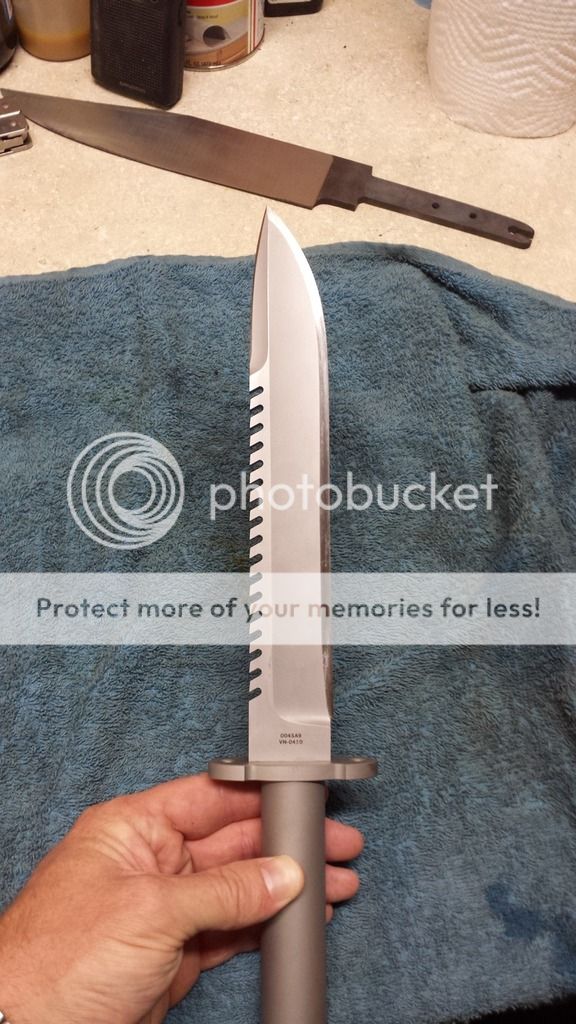

Yep, and Josh has been contacted. I'm sure i'll hear back from him, but, again, the degree of bevel the OP put on the blade is NOT best for chopping. Josh would know how well the blade was tempered after putting his "edge" on it. And we don't know how the edge looks because the OP has now gotten ghost on this thread, even though he promised pics none were ever posted. So we are left to take his words of the degree of angle of the bevel. Perhaps he should have spent his money on an axe instead of the ACK SLY II knife he purchased. ?
The OP did this very same thing in The Hollow Handle knife thread, made NASTY claims against Vaughn Neeley without EVER having contacted Vaughn, AND after modifying the blade, putting an impractical bevel on it. he BLAMED HEAT TREAT then, as well probably because he can't re heat treat after changing the geometry.
PHOTO CREDIT TO SAM WILSON ***
The OP gets no credit for anything he's implied in this thread from me, not only because of the fact that he's dissapeared, but his actions (lack of communication with the maker) just don't make sense.
