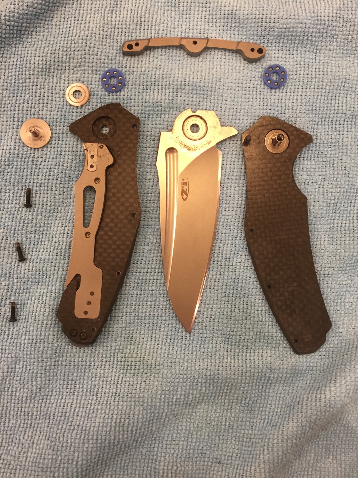

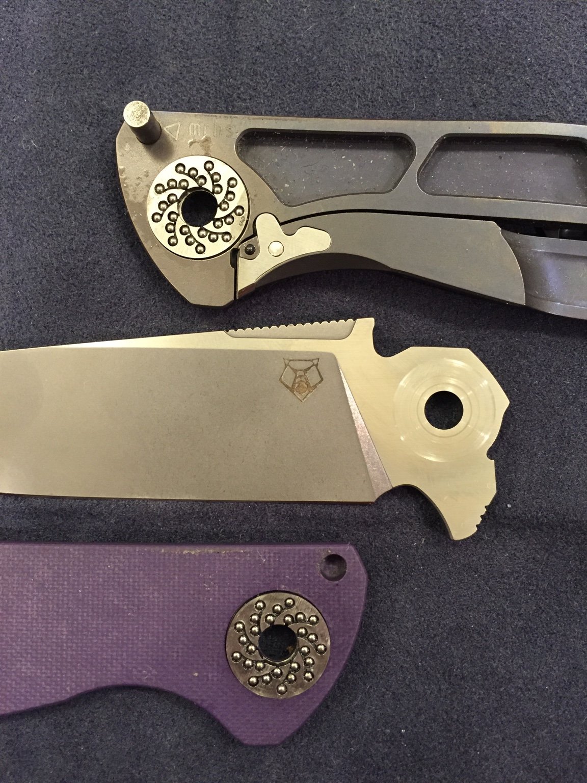

At the top, that little blue piece is not part of the knife, it is just a magnet holding the ball bearings (Wouldn't want to lose those :eek:)
Awesome pics guys, and really cool thread idea.
Using a magnet to keep the ball bearing from rolling away? Genius!!

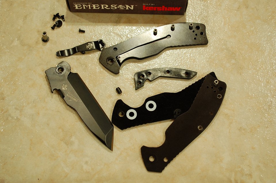

Took these just minutes after getting it..
Two screws hold on a CF piece that hide the frame screws.
The first frame screw looks like it was hand ground to make it fit.
The frame halves separated. Notice the bearing on this side of the knife.
A detailed look at the pivot. The white is some kind of thread locker.
Another look at the pivot and bearing. Note that the steel washer has a flat spot on the ID that matches a flat spot on the pivot to keep it from rotating. This also looks like it may have been hand ground. Also notice the bearing. It's different from side to side!
A close up view of the assembled pivot
Close up view of the bearing pocket.

How old is this 0999? It cannot be old right? Notice the dimples on the ball bearing track in the pocket in the last picture. Are they formed as a result of bearings pressing the ti frame? Are they causing any gritty action?
Those pictures were taken within just a few minutes of getting the knife, literally straight from the box, flipped a few times and then took it apart. I can't say for sure what caused them, but they aren't nearly as big as they appear (these pictures are larger than life) and you wouldn't know they were there if you never took the knife apart.

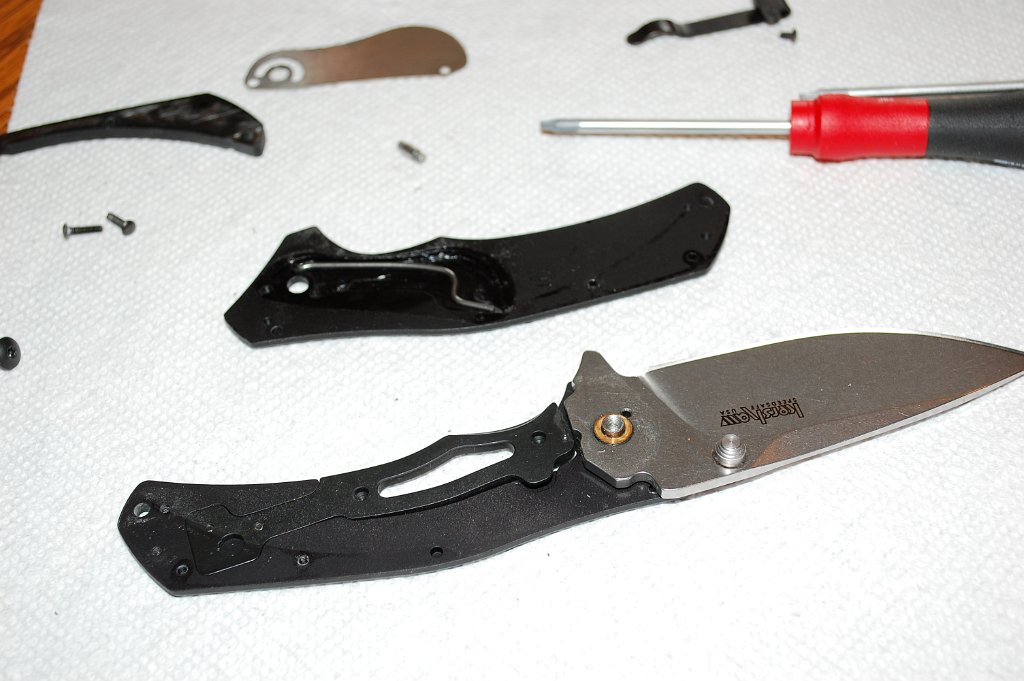

Great thread, I take apart every knife that comes apart and a few that didn't :) I used to post What makes my knife tick tutorials here who knows what happened to them, I know a lot were lost in the BF server migration in the early 2000s. I'll have to start doin' 'em again. It's also cool to see how you all lay out the pieces, some of you are very organized and others more haphazard (I'm somewhere in the middle myself ;) )
One last thing Cutlover, as good of an idea as using a magnet to keep the loose bearings together might seem, unless you degauss them before reinstalling them you risk the chance of the bearings now bein' magnetized attracting metal particles (ferrous) resulting in premature failure just my two cents. I just use a dab of grease or drop of oil, what ever I use to lube the bearings on a plate, it keeps them together and if you're using the same lube it makes it even easier to reassemble.

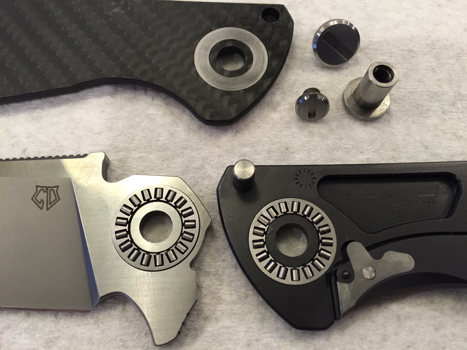

@MTNEER Which of the Shiro's faster & smoother, the one on ball or roller bearings?
The roller bearings are the smoothest Shirogorovs that I've handled, but the multi row ball bearings are not far behind.
They actually make a multi row roller system but I've only seen pictures.
