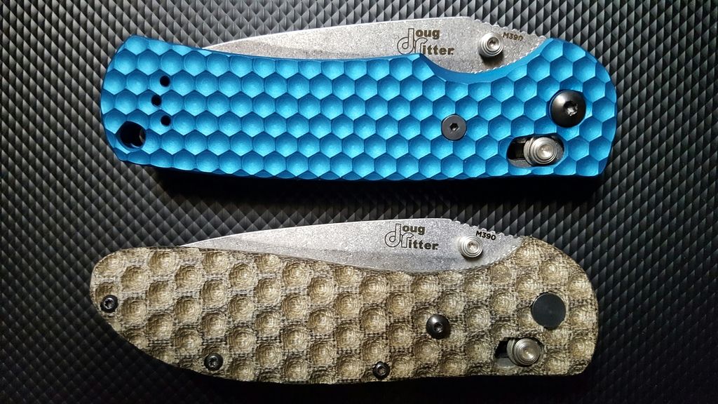

The new 560 looks very similar. Might be the same as the one photo above.
Ritter mini blade comes Stonewashed with M390 super steel. Mines came in oiled, no blade play and opens like glass. Don't want to take it apart.

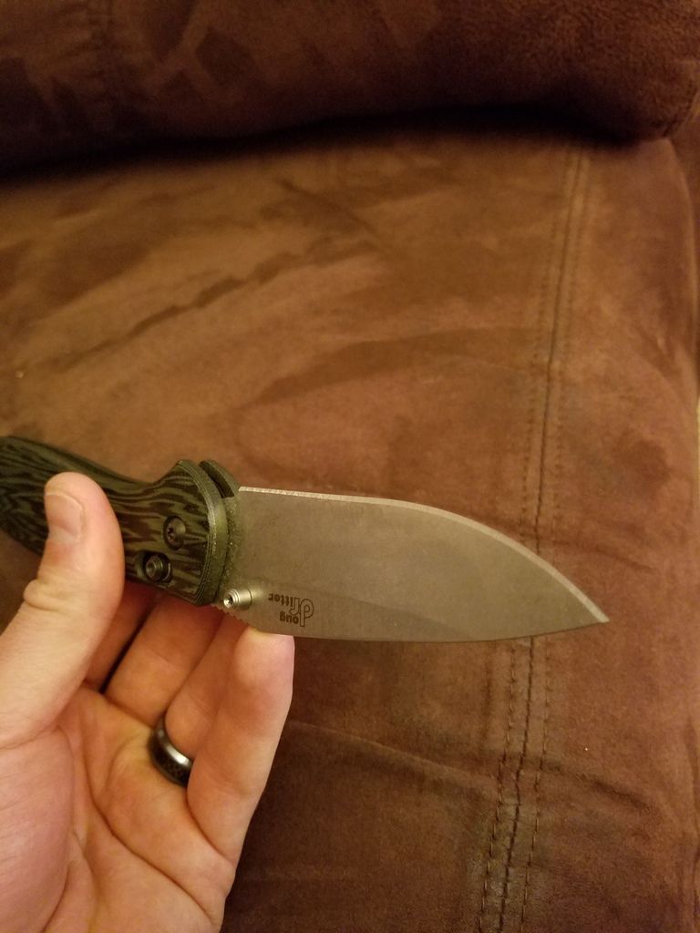

Do the full size Ritter's have a slight recurve, or did they get into the belt a little too much on mine when they sharpened it? I never noticed it on any pictures but looking down the edge, you can see it recurve just a bit. Just curious. It's not enough to bother me if it's not supposed to be there, but hey that may be on the blade design too.
Since the blades are hand sharpened/ground using a belt, there's always the chance for too much metal to be removed. Just took a look at my S30v Ritter blade, and it's got a minor 'suggestion' of a recurve, but you really have to look for it.
Can you post some pictures, please? It may just be that the cutting edge didn't clear the plunge grind, so there's a flair and a little more blade back there at the flair, inducing a moment of recurve. This is kinda the rule with Benchmade blades, even if it is slight. But to answer your question generally: no, the blade is not a recurve design.
Should not be recurved, it's designed as a straight edge. Just looked at my brand new M390, and it's straight. If I look directly down the edge, there is a *tiny* bit of waviness near the heel, but that's somewhat to be expected on a hand-sharpened blade.
I don't know if this picture shows it, but from what you guys are saying, it's faint enough it's just a product of hand sharpening. It doesn't bother me at all, I was just curious.
I can see it. Shouldnt be too hard to correct if you want, just spend more time on the belly, or grind the edge to level it and then reprofile (probably a big pain to do it that way).
I would keep the belly and grind the back end, with normal sharpening, if I wanted it removed.
