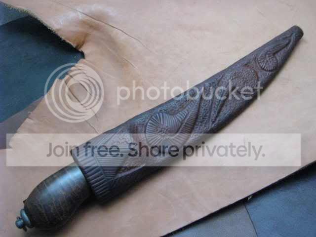

Ray Richard has been making some really cool looking sheaths and have been hoping to get him to make one for one of my knives. This might be a good one for that. They are pouch type sheaths, so I'm keeping that in the back of my mind with this one.

Are you holding the tongs with you legs while you hot cut, or having a helper do it? Looks good so far! Those sheaths are really cool too.
