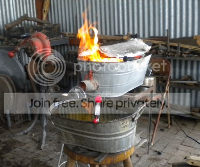

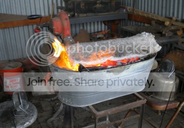

I used a candy thermometer to check the temp., of the canola, 120-130.

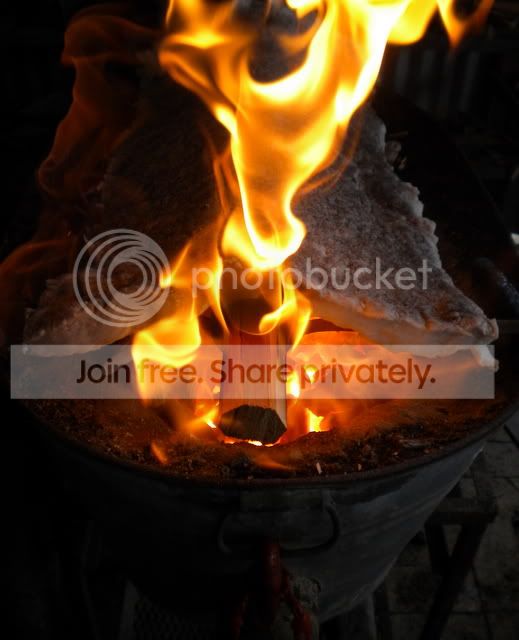

I checked the outside of the steel muffle for non magnetic, the curie point, 1414, with a magnet, while taking note of where it was at in the color spectrum on the inside of the muffle. The color inside the muffle is higher on the spectrum than the outside because of ambient light. Then, I brought it up a hair, 50-100 degrees, targeting 1475-1500,… a “salmon” color inside the muffle.

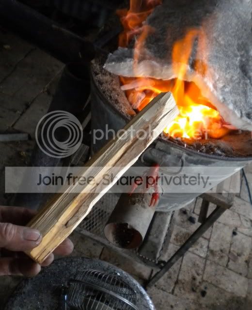

Just before I put the blade in, I inserted a piece of cedar wood to create a reducing atmosphere inside the muffle, making sure it was well lit before sliding it to the back of the muffle.
Next, I let the blade come up to temp., same color as the inside of the muffle, and soaked it for 8 minutes. Then I quenched it.

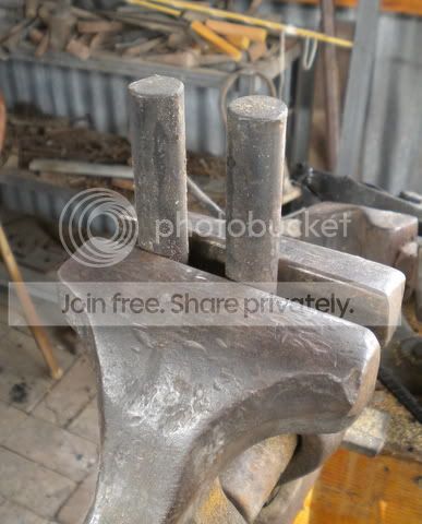

It took a slight warp towards the point so I over corrected it to the same degree in the other direction and brought it back to center with this bending jig.

Mister crawdad looks to be done perfectly. :D When I was at you place in 2010 when you hardened Don't blade I was shocked at how clean it was when it came out of the pipe. Having that piece of wood in the pipe along with the blade works great!
R, yeah, it comes out pretty clean, works good.

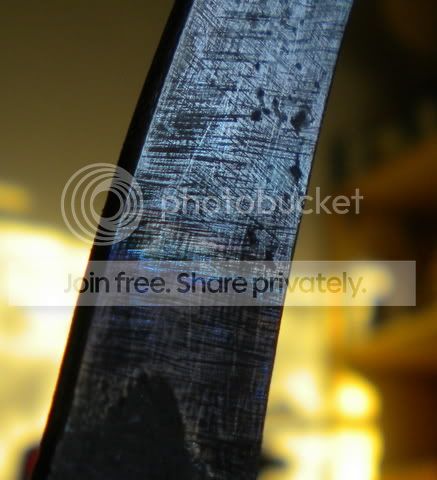

I’m going try and leave some of the burnt oil finish and heat patina from the “voodoo” part on the finished blade, at least a few traces of it.
Oh goody, more “process markings”… taking advantage of the steel’s “memory”!

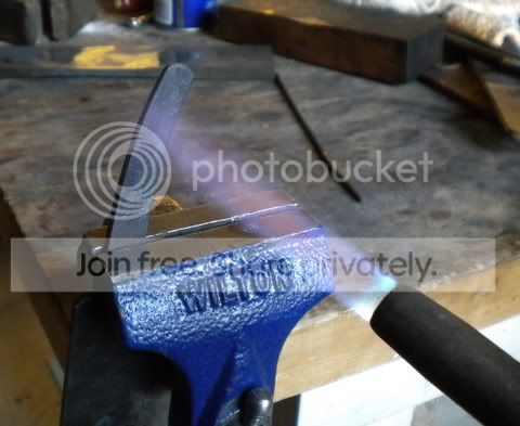

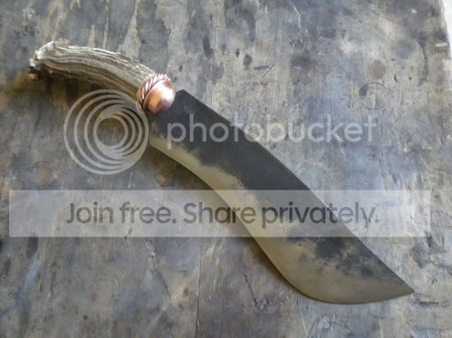

I did a some extra tempering on the tang this morning with a torch, using a vice as a heat sink to protect the edge. I did it in two stages. First on the back ¾, running it up to non magnetic, a dull red, and air cooling. Then, I took that section up to a black heat a couple times air cooling between cycles. This area needs to be soft so I can drill a hole for the pin, not sure exactly where it’s going to go yet. Next, I took the front ¼ up to where it just started to show some blue. I flex tested the front part and it was very springy and checked the back part with a file and it was soft.
I also put an edge on it and tested the blade,… good to go. :)

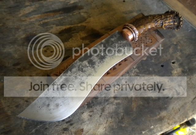

I worked on the finish a little just to get a better idea of what it will all look like,… although I won’t be doing the final finish and assembly until after Mr. Ray makes the sheath.

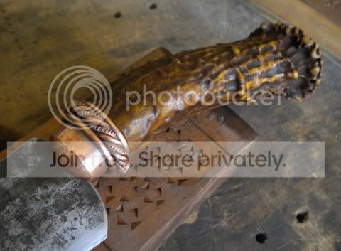

Did some hand sanding to the blade, leaving some of the hot patina. I also put a heat patina on the ferrule with a torch, highlighted it with some fine steel wool, and put one coat of Fiebing’s “chocolate” on the stag.
The next thing is to make some type of decorative end piece for the stag.
… starting to look like a knife.
