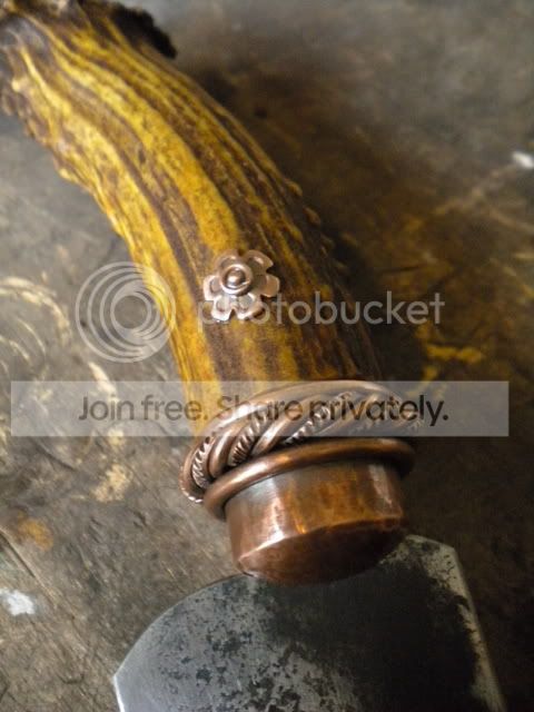

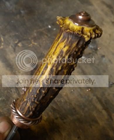

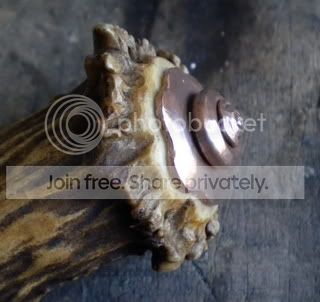

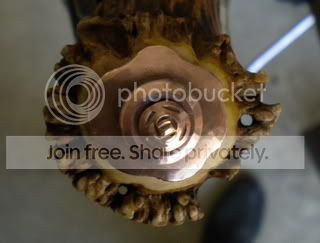

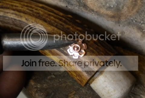

I got a little work done on the end piece fabrication today. It’s three pieces brazed together. I put a variation of my mark on the very end.
That end piece looks nice. I like that it compliments the stags crown overall, but has it's own flow. This is an awesome WIP.
I can't wait to see what sheath is conjured up for it. Thanks Tai.

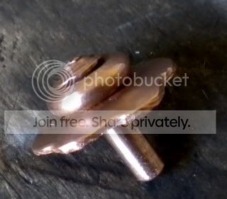

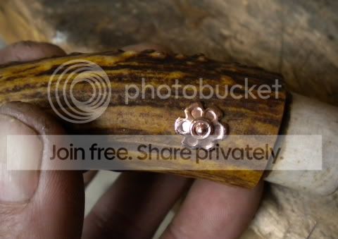

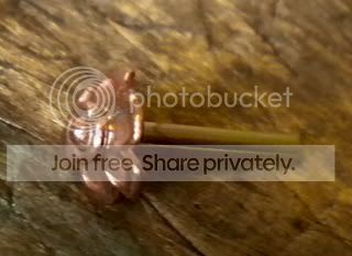

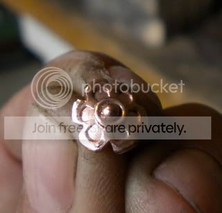

I'm going to try and do some work on a decorative pin for the tang today,... similar to the end piece.

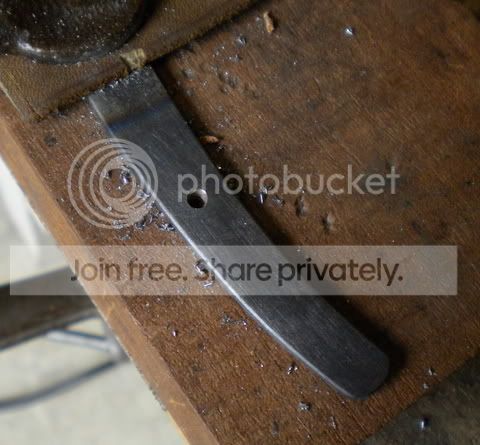

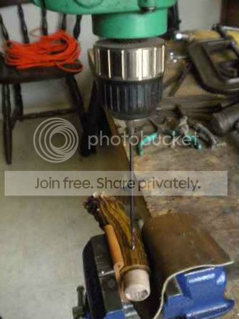

I find it a lot easier to drill a hole straight (without a drill press) using an extra long bit. It’s easier to tell if you’re off.
I used brass for the pin itself, because it’s a lot stiffer than copper.
Burnished over the stag for a flush fit.

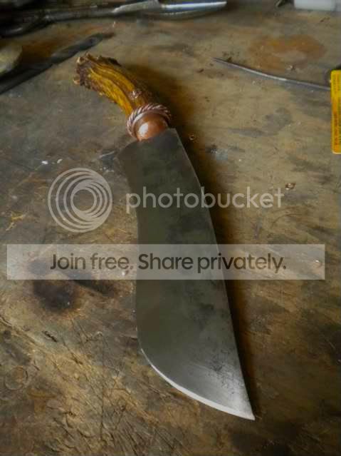

I'm thinking it might just be ready for my big buddy, Mr. yaR, to sheath up,... can't wait! :)
Thanks!
Traditional, “cutler’s art”.
Well,… “I know it’s only Rock and Roll, but I like!”
(It ain’t over until Jagger sings…)
(((… holding my breath until after sheathing, final finish and assembly, etc.)))
So far so good.,,, I’m thinking.

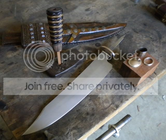

Had a student that saw the WIP come for a lesson yesterday. We made a ferrule similar to the one in the WIP. I think he might post some pix. We'll see..

That was me taking the class. Had a blast and learned so much. Tai is a great teacher and a very nice guy. Tai, I'm still traveling and won't be back at the shop for about 3 weeks. Have'nt decided on the blade to use with the ferrule yet. No pic of it yet. I'll see if I can figure have to take a pic with my camera and get it uploaded.
