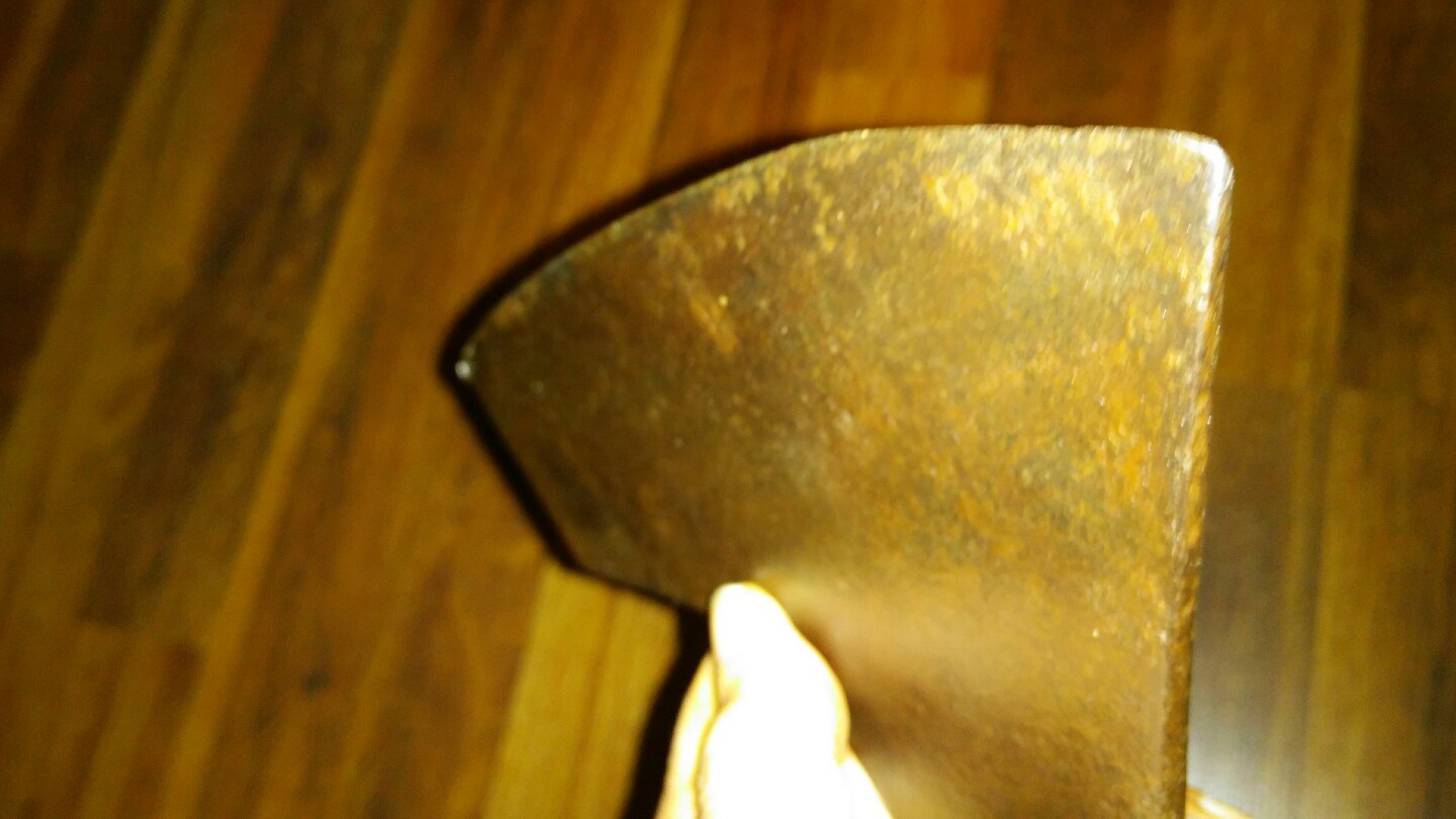

This axe is most interesting,and a Very uncommon shape.In Russia,virtually unknown.
The only thing that would qualify it as Russian is the eye,and that peculiar spur-appendage.However,those quite possibly came from Scandinavia(arguably(and MOST objectionable to the Russian nationalists),along with all the tool-making,and woodworking technologies....).
Alas,i cannot make out the letters at all...Not even wether they're Cyrillic or Latin script...Would it be possible perhaps to copy them on paper,even most approximately?
Meanwhile,the general shape of the axe puts me in mind of the Norwegian Laftebile,or similar:A very fine-bladed,wide axe with a straight-ish edge,for working on those wide flats on the inside of the notch in the Norwegian-scribe type log construction...A specialised tool originally,but was later employed wider and wider,spreading through Scandinavian countries....
(REALLY sorry,Agent_H!:)
This is getting interesting.
The first three letters are "LEA" and it possibly reads LEATIA .
Well,Sir,the Latin script speaks almost definitely of non-Russian origin...
The russian-like voluminous eye probably points Northward,to places where birch is the best a guy has for hafting an axe.
And that large-area,thin,but symmetrical blade toward the Lafte(sided beam) work(vs hewing)...
As usual,i may be as full of it as a Christmas goose,but something about it says Norsk...
I kinda class this type of tool as a sort of a chisel almost,a hefty one,like a large slick,it's haft used for added momentum,but the tool is a razor-sharp precision instrument vs a chopping axe.
As such,it's poll never did need to be overly beefy(the tool is frequently pushed by grasping with your palm).
And so,when someone carelessly pounded on that poll,it distorted,delaminating the probably rough,unrefined,locally-obtained bloomery iron tat it was forged from.

Agent_H,you're doing a heroic job...(to attack a goosewing with hand tools is nothing short of...).
The highs and lows of the landscape will,of course,affect the action of a sharpened tool(by changing the angle of cutting edge differentially).However,that is something that you could work with;i'd guess that it will be barely perceptible.
What would be a bigger problem is if you were to "roll over" that edge,as you file.As in (without meaning to) create a double-bevel on this strictly single-bevel device.
That would indeed be felt,as it'll translate into you having to change the angle of attack,thus loosing the support of that entire plane area,that chisel-like guides the path of hewing...
It Is difficult to tell from photos,but flat-filing is like that,there's so much less material right at the very edge,that the sheer weight of a file may cause you to dive it off....It is to be prevented at all costs.
I'm sorry if i'm misreading the details on these photos.
VERY best of luck on this in any case-you're doing great.
I can't tell exactly where the edge is but I agree with Jake that you want the back flat with no roll on the edge. You could get away with a very slight back bevel by changing the angle of attack but it's not really the same tool this way.
If you need to correct the back try using a long file like 14" or at least 12". Lay the file firmly on the back before begining your stroke. By bearing down heavy on the tang of the file and light on the tip you can quickly remove a small roll at the edge if one exists and you cared to remove it.
First of all, I appreciate all the help with the recondition of this thing because I do want to it to be in as good a state as possible. I'm a quick study.
Best way to judge that is getting a ruler or other flat object out and see where the highs and lows are. Pic 1 looks good, but it looks like pic 2 still has some waves in it? Ideally my ideal underside is like a spoon: Centre is highest, the side a little bit les. About 2mm so, or a little more then 1/16 of an inch? But it does look nice. I wouldn't worry about the pitting, as it should be fine. But I would worry about the waves, although that could be the photo or my imagination?
I reprofiled it flat at the edge to create the arc like the silhouette photos earlier. That I tried to keep my work perpendicular to the bit – like any axe before starting to set any angle – I think like what you guys are recommending?
Doing that left it flat and dull as a soup spoon but thinner in the center and actually as thick as a soup spoon at the heel and the toe.

In More than total agreement:That concavity is the Guarantee of flatness,serving like the hollow-grind on chisels et c.,it is there to make sure that all's flat,to help you avoid the rocking motion with your filing stroke.
Like on any single-bevel tool,most of material is removed from the bevel side.The "back" is only filed minimally,to assure that it'll meet the bevel to intersect it at the Edge...
I think the back of your axe is fine like that. No need to file out a concavity.

I appreciate your explanation of this Jake. This, the reminder of the bevel intersect, and the importance of not having any bevel to the back. That is what I was shooting for. It person, it doesn’t look like there is a bevel – I mentioned I am having trouble taking a photo very close.
The edge is shiny and for some reason I can’t get the light off of all of it enough but zoomed up it shows a bit better. I think still having so much more material at the heel and toe compared to the center is adding to the optics. Maybe a touch from sanding?

Yes,, as Jake said the concavity is to make sure you have no bevel on the back. Seeing that detail and the gentle roll heel to toe tells me that some smith really knew his stuff. I bet that thing will cut like a dream.
