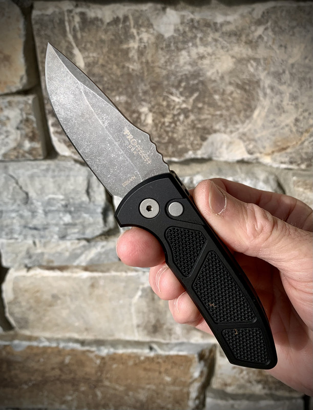

Somehow this found it's way into my pocket this evening!
