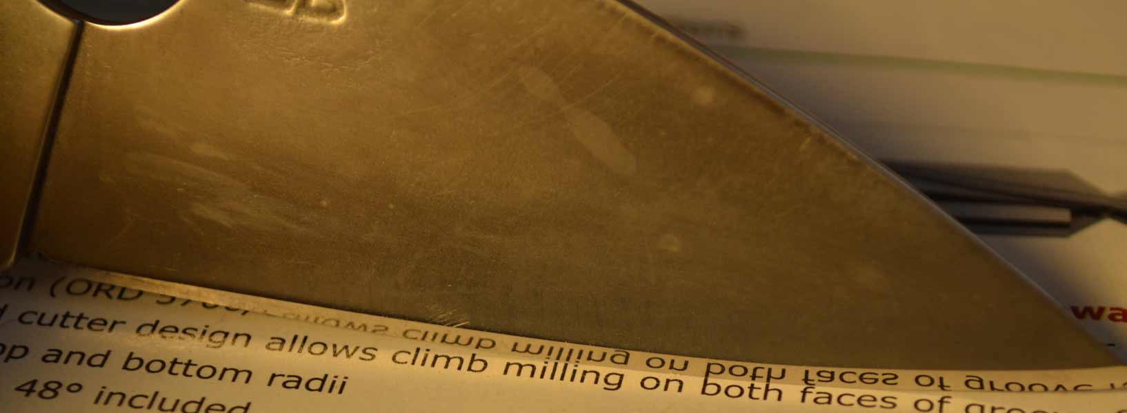

Review of sharpening a Spyderco Maxamet knife with the Matrix stones.
Thanks again to DeadboxHero for letting me have this knife for a few days so I could sharpen it. This is the first time I have sharpened anything harder than 440c ish blades, other than ceramic. Short version is it's a little slow to set the bevel but once that is done the rest goes just a bit slower than what I am used to. The finished results are spectacular!!!! I flat LOVE this steel. VERY hard, fine grained, and pretty much no microchipping which I find interesting since I usally have some with my other knives if I am not careful.

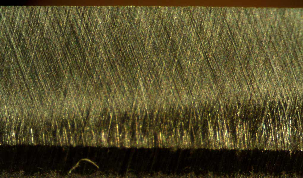

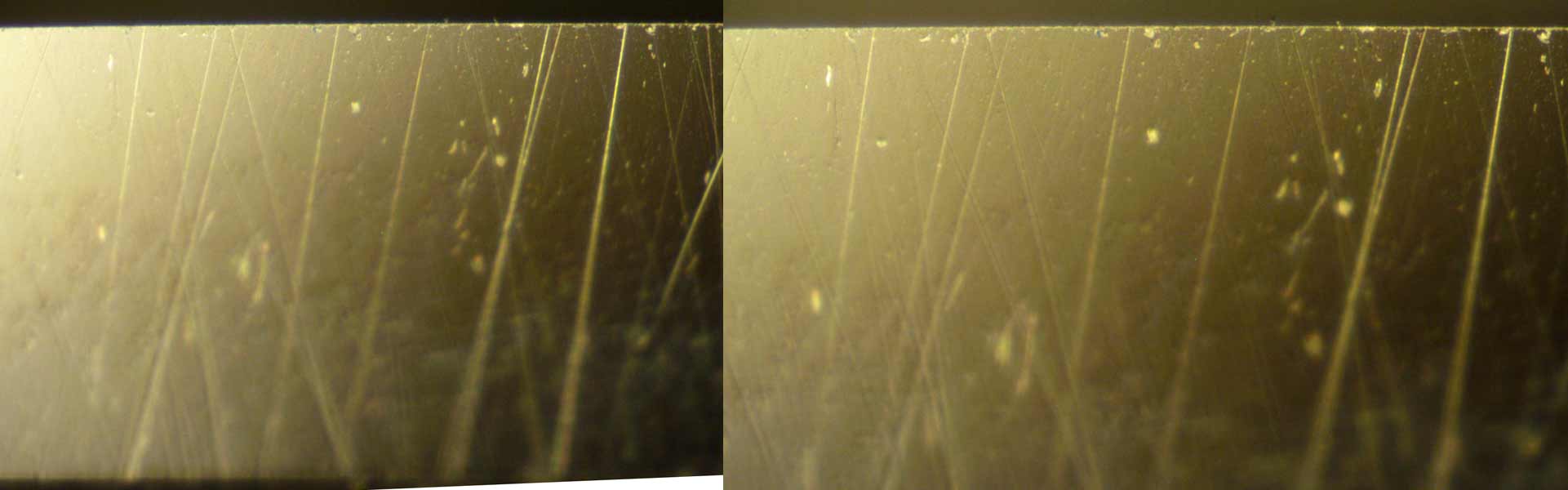

Ok, now the long version. I started out setting my Apex at 21 degrees and began grinding away with a little pressure, about double the weight of the stone and arm, with bidirectional strokes. Before I reached the apex I tried a 320 Alox stone just to see for myself what it would do, which was nothing. Back to the Matrix 300 but once I started rasing a burr I noticed some damage at the apex with coresponding scratches in the bevel so I switched to edge trailing strokes. Once I was getting a burr along the length of the blade I played with getting the best edge possible by using only the weight of the stone and arm and making only 7-10 passes per side of the blade. This made a big difference in the integrity of the apex and the size of the burr, it got really small considering it is a 300 mesh, 80 micon, stone.

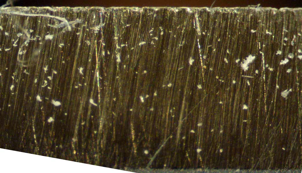

Bi-directional passes on the right, edge trailing on the left. Notice the scratches leading to the edge damage on the bi-directional passes from edge leading strokes. This is pretty common, in my experience, which is why I use edge trailing strokes. The bevel is about .075" wide.

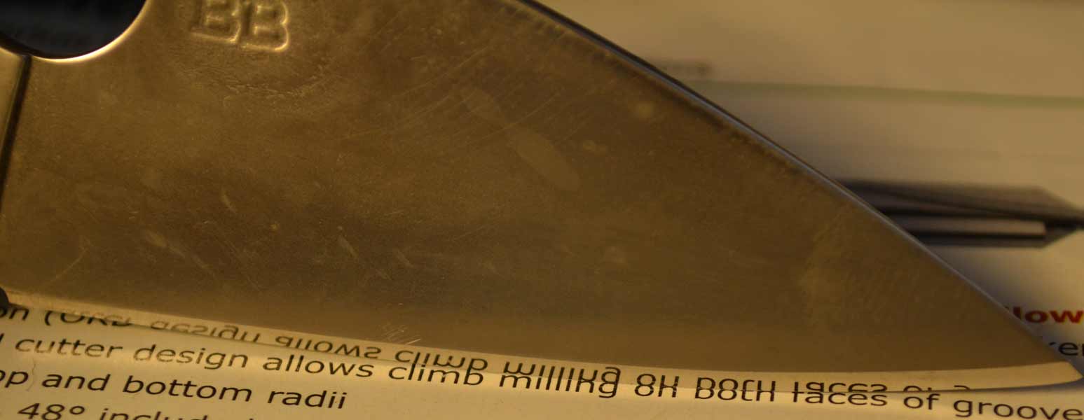

Here is the knife after I am done with the Matrix 300 stone, softer steels don't polish up like this at this point. It is still pretty rough but it sort of shaves even without removing the burrs with something finer. The microscope photos make the scratches look a lot worse.

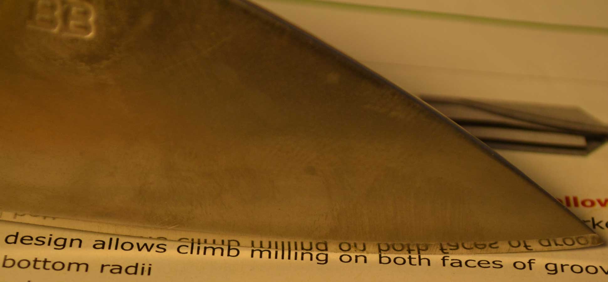

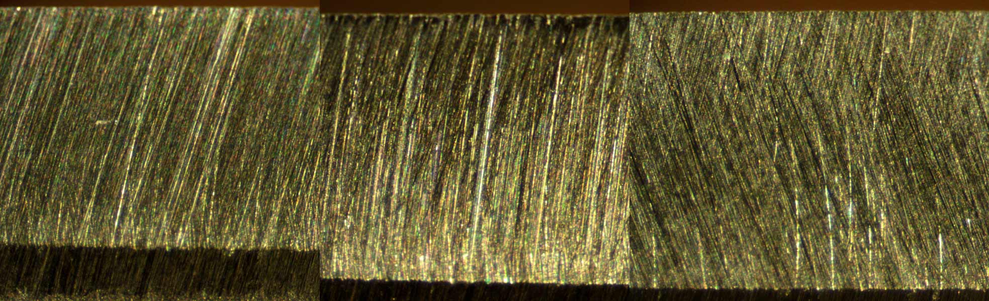

Next I spent about 2 or 3 minutes with the 650. It looks like I could have cleaned up the apex a little better but it turned out this was enough. Burrs are pretty minimal, especially considering I only use edge trailing strokes.

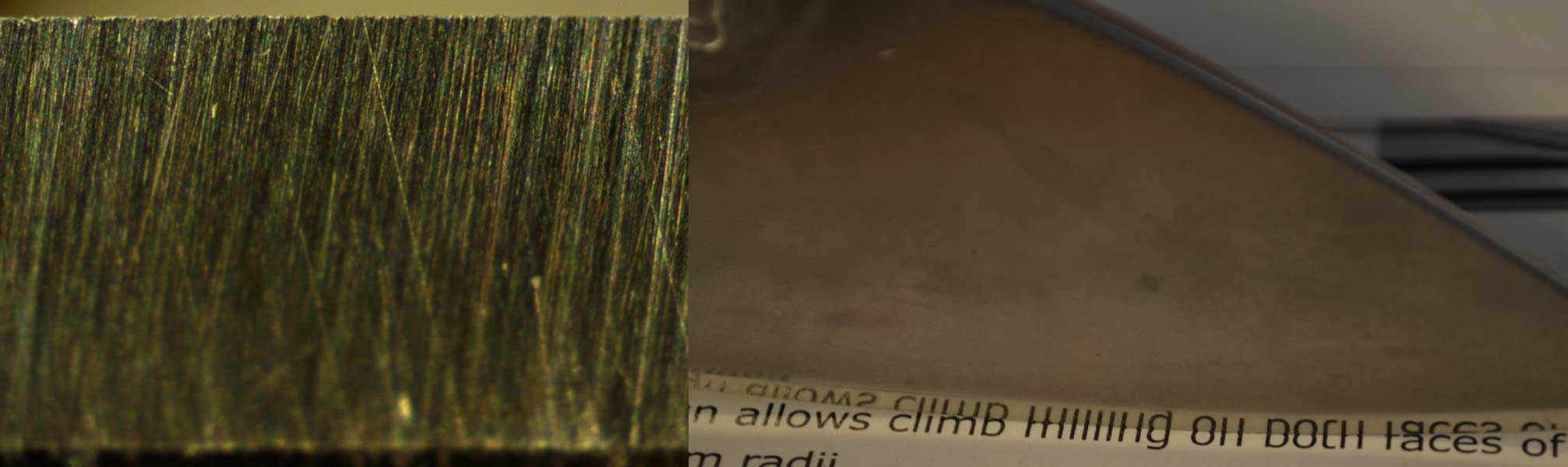

Afte about 2 minutes with the 1100 this is what I got. The apex is starting to look good. Burrs really can't be felt and it is shaving pretty well by now.

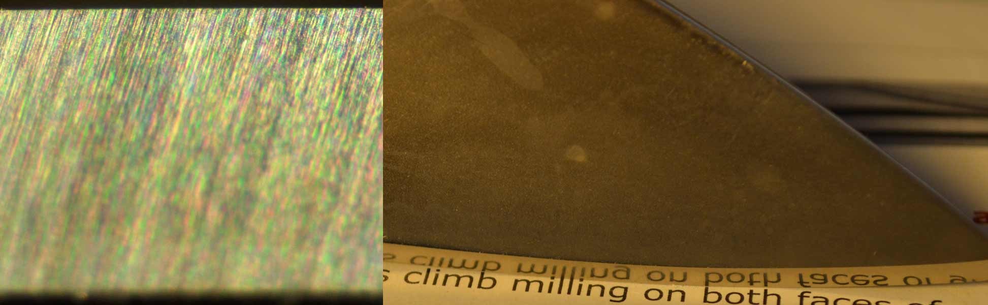

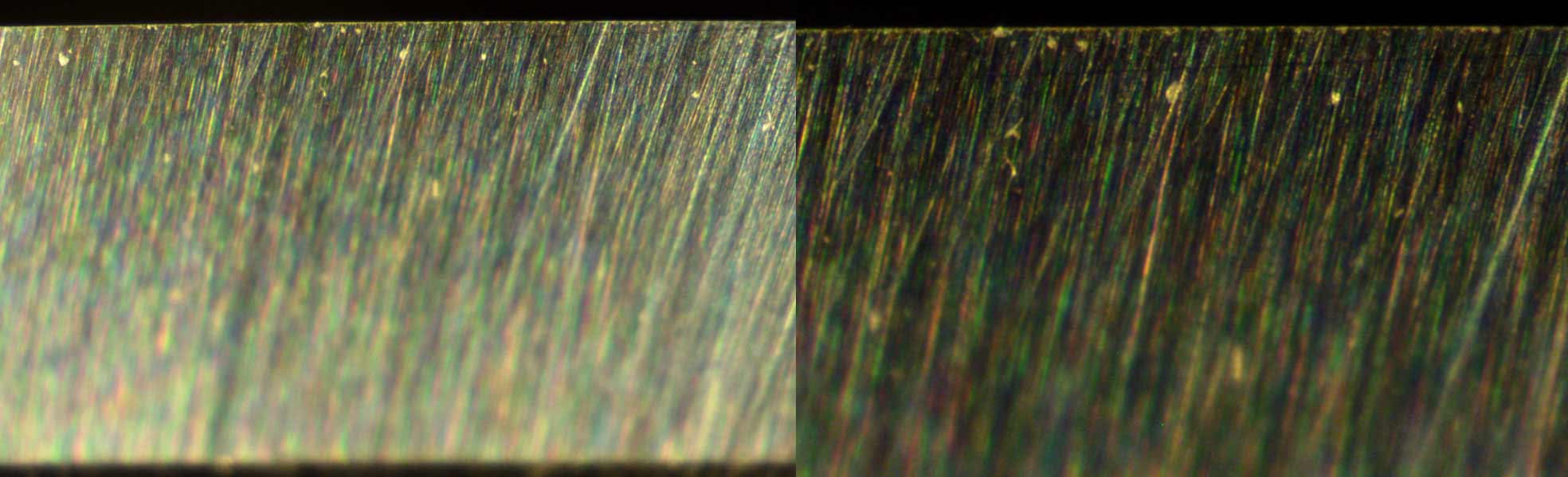

On to the 2300 stone for around 2 minutes. Photo are the same except the one on the right is a little higher magnification.

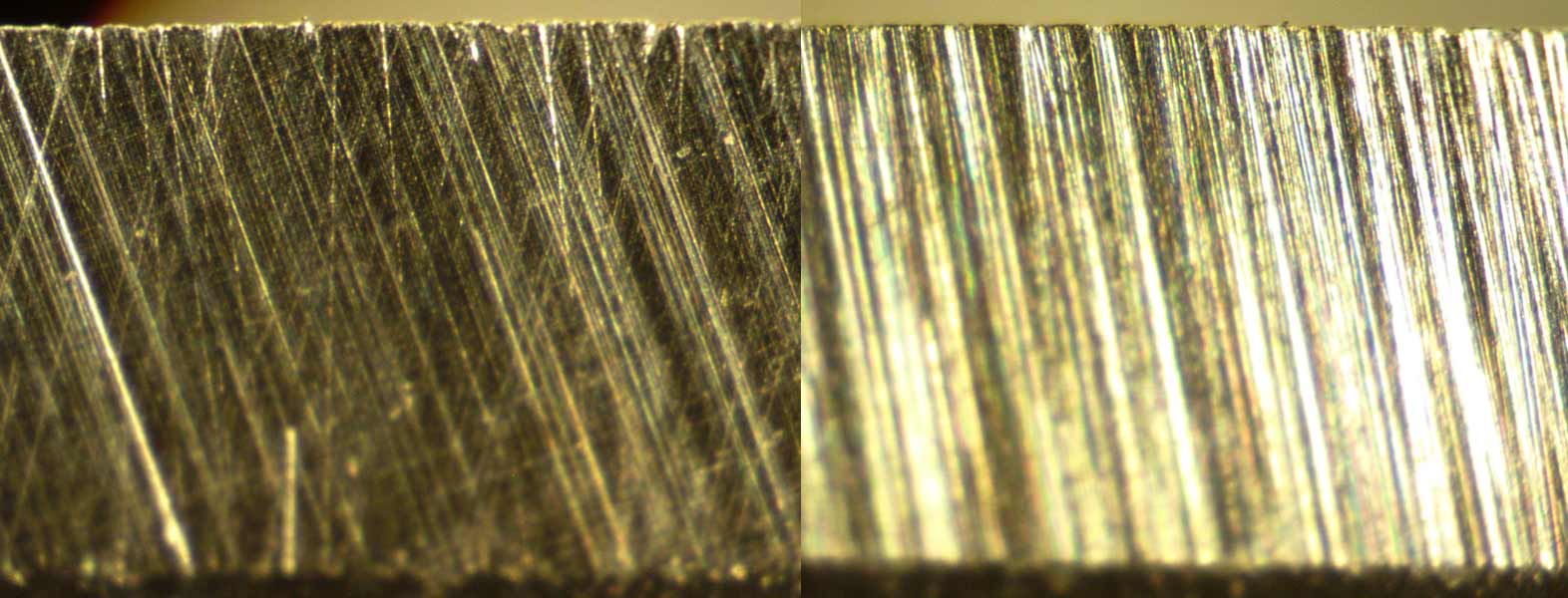

Now for around 2 minutes with the 4000 stone. This is where I should have stopped, but I have to find out the hard way. Again the photo on the right is just better magnification. If you look closely you can see the same debris in both photos.
2 minutes with the 9k stone, I don't have a 6500 right now so this is the next step. As you can see it is not working very well. Although it works for most of the surface there are a few deeper scratches.

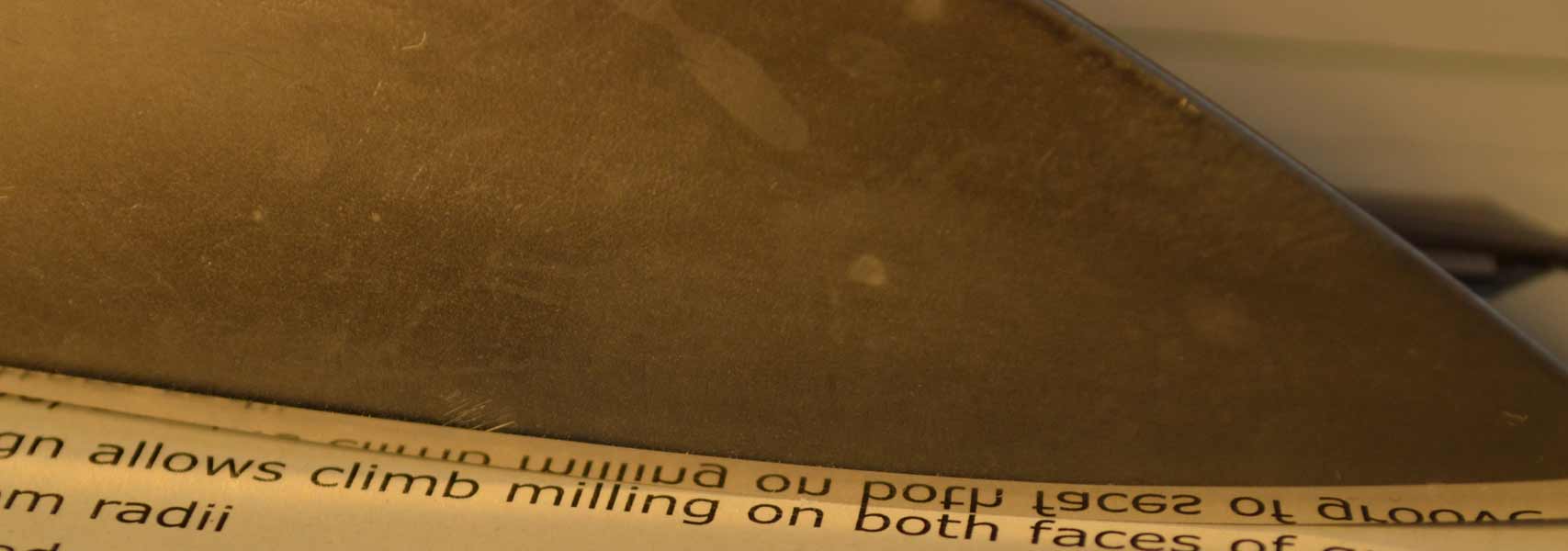

Here is the blade after the 9k stone and around 5 passes with a 4k, 5 micron, diamond loaded denim strop. It looks like all the strop did was roughen the apex, obviously the diamond was too coarse for this.
The last things I did was finish the knife off with the 4k stone to remove the scratches and then I stropped with a 4k alox loaded denim strop. I was running out of time so I failed to take any photos but the alox strop did smooth the apex just as I was looking for.

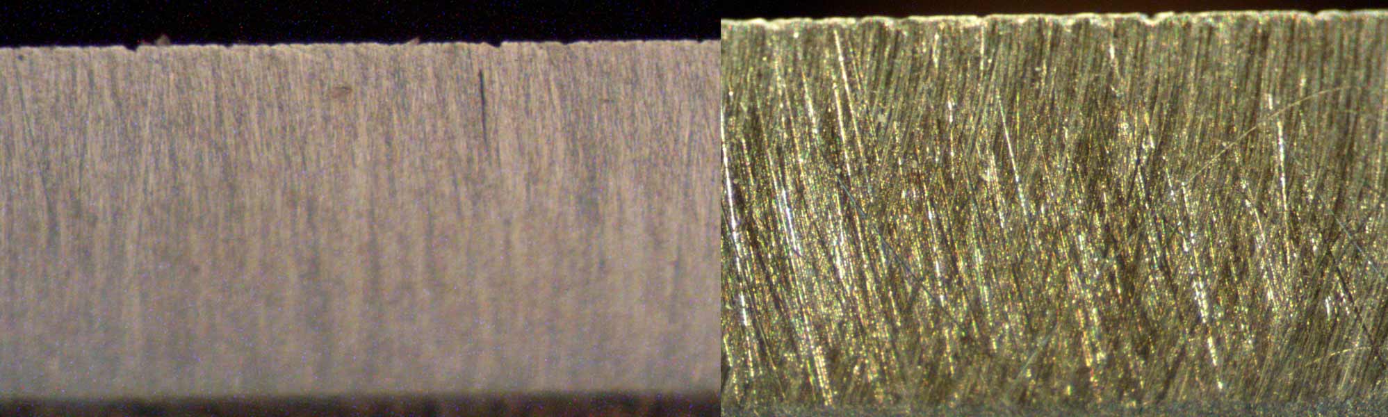

Comparison with Matrix stones and Venev diamond stones. The test knife was a CRKT 440c blade with a .06" bevel.

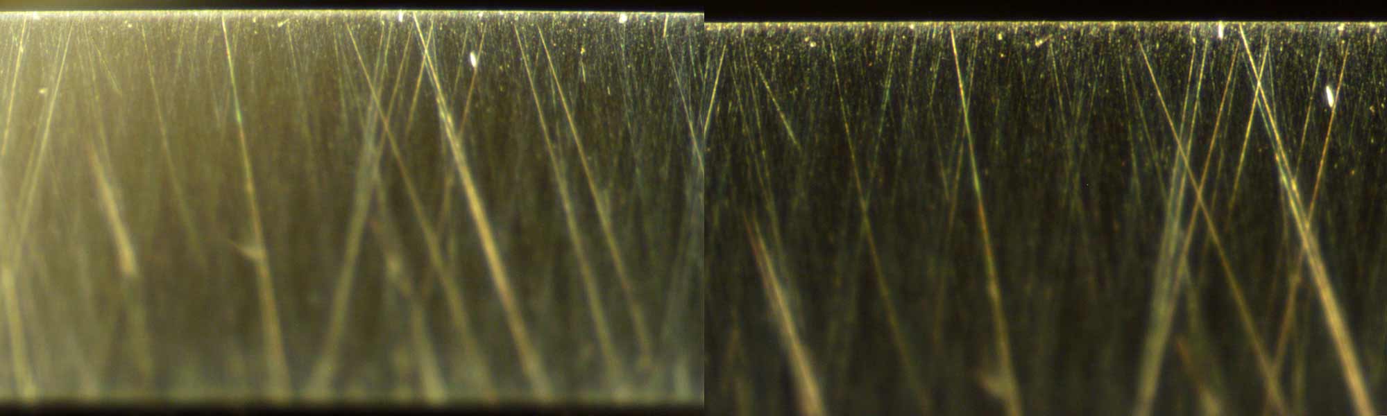

So I got to try a few Venev diamond stones that somebody sent EP to check out. The stones I got to try out are the F80, F150, F400, F1200, and F2000, which are 180 micron, 75, 17, 3, and 1.2. The Venev stones need a lot more pressure to work, pretty much the same as aluminum oxide. In fact the coarsest 2 stones didn't seem to cut much at all with light to medium pressure and it's not like the steel I was grinding on is all that hard. The feedback I thought was excellent. The biggest issue I found was with the aluminum backs, the bevels on the ends were around 32 degrees that came to a sharp edge, they are supposed to be 45 degrees with a flat on the end.
I was mainly interested in metal removal and scratch pattern, I really wasn't interested in refining the apex which is pretty obvious in the photos.
First off is the F80 at 180 microns. I thought this stone was too coarse. It didn't remove metal as fast as the F150 but left deeper scratches. Even when pressing down with about 4 or 5 lbs of pressure it didn't cut very well. The stone didn't look or feel like it needed to be dressed.
The F150 at 75 microns was my favorite stone. It removed metal about 3-4 times faster than the F80 did. I think for metal removal it is a bit better than the Matrix 250, which is 80 microns. The only downside is it created a very large burr when I apexed, around 5 times bigger than the Matrix 250. Since this stone didn't cut with reduced pressure it was hard to avoid the big burr. Matrix on the left, Venev on the right.
The F400 at 17 micron left deeper scratches, was slower cutting, left a larger burr and didn't have as refined a scratch pattern as the 1100 Matrix, which is also 17 micron. Matrix on the left, Venev on the right.
The F1200 is 3 micron but left a coarser finish than the Matrix 2300. Again I didn't think this stone cut as quickly as the Matrix stones that leave a similar scratch depth.
The F2000 is supposed to be a 1.2 micron but the scratches left were closest to the Matrix 2300 which is an 8 micron stone. As before it didn't cut as fast as the Matrix, it left a larger burr and I don't think the scratch pattern was quite as good. Matrix on the left, Venev on the right.
Same stones after dressing with different light. Matrix on the left, Venev on the right.
All in all I am happy how the Matrix stones compared with the Venev stones. The only Venev stone I liked better was the F150, which I am very impressed with. So much so that I am going to try making some phenolic resin stones too.

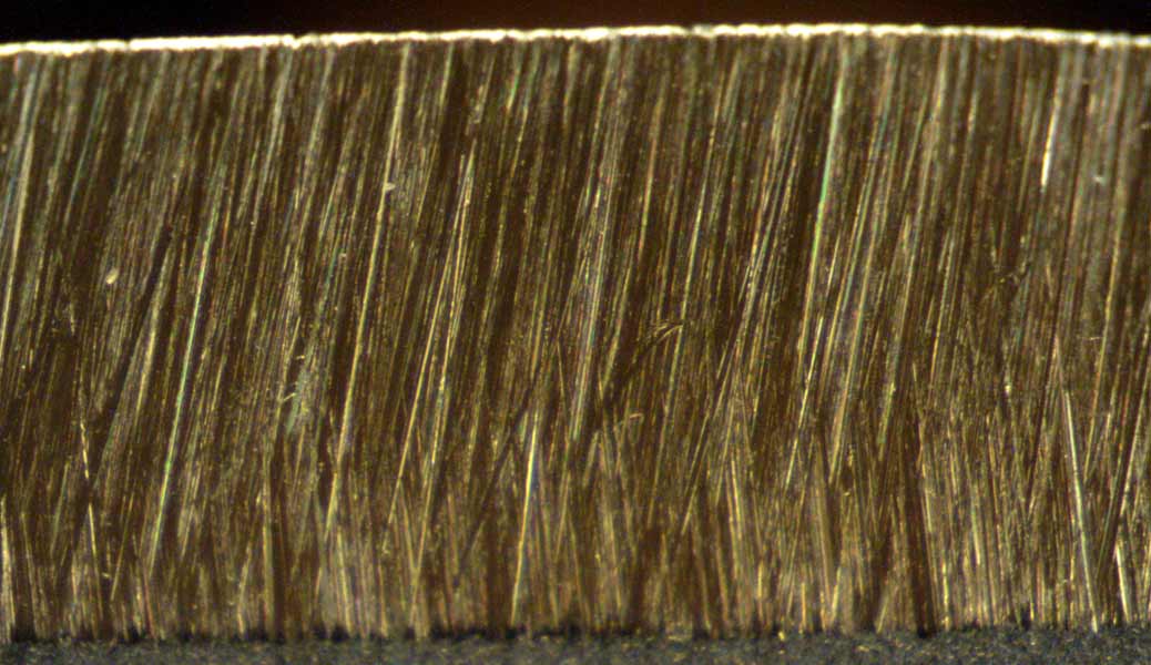

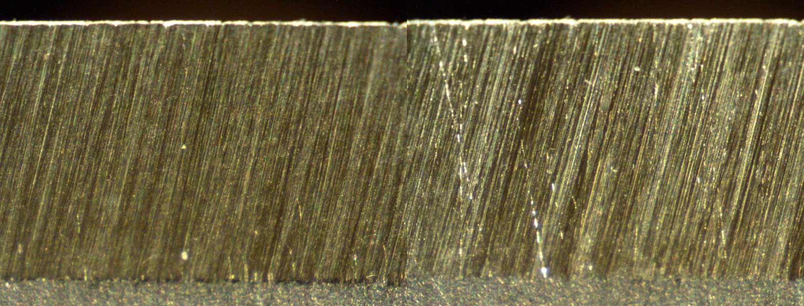

Thoughts on two Poltava metal bond CBN stones. The knife is a CRKT 440c with a .06" bevel.
Thanks to DeadboxHero for letting me try his F280 and F500 Poltava CBN stones. They are 36.5 and 12.8 micron in a copper bond. I am not impressed with the bond. It is a bit difficult to dress, doesn't hold onto the CBN particularly well and I wasn't fond of the feedback. I dressed both stones with the 55 micron aluminum oxide on a flat plate that EP uses for the Matrix stones with good results. You can see how well it works by how shinny the surface of the stone is, or isn't, as well as the scratch pattern it leaves on a knife and feedback. I think the aluminum oxide works better than silicon carbide because the silicon carbide breaks down faster. Anyway they responded well to dressing but the boost in performance was short lived. Between the Venev diamond stones and these I liked the Venev better because they were a little more aggressive with metal removal and I liked their feedback better.
This photo shows the Matrix 650 on the left, the freshly dressed F280 in the middle, and the F280 before dressing.
This is what the F500 looks like. Pretty much the same as the Matrix 1600, which is 12 micron as well.

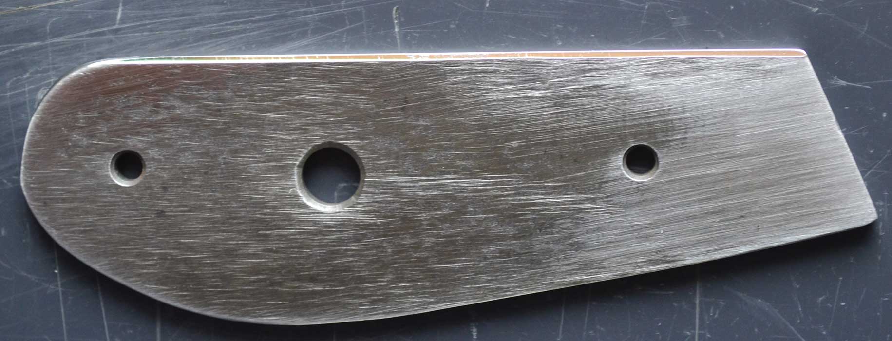

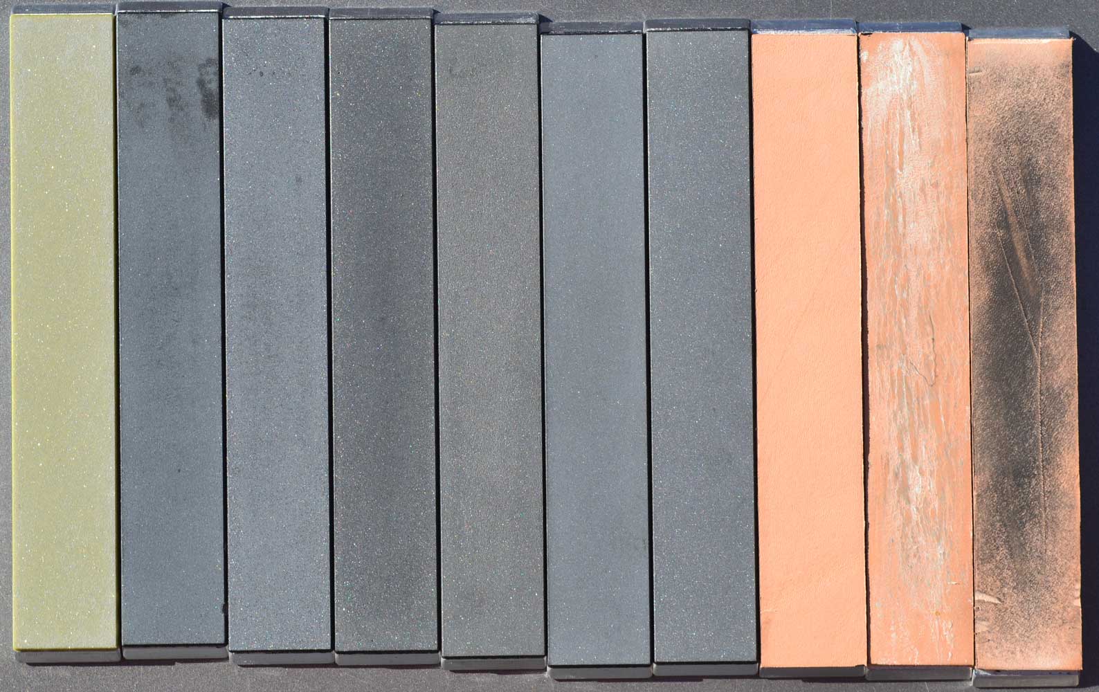

Just an update of sorts. I got some samples of 80 and 125 micron boron carbide to try out so I made 3 stones of each grit in different concentrations. The first steel I tried them on was CPM 4V at 64 rockwell and didn't like them, they didn't bite into the steel like the diamond stones do. A day later I went to a friends house for dinner and took my stuff to sharpen her knives since they were all about as sharp as old butter knives. All she has are Cuisinart knives so I tried out standard EP alox stones, Matrix stones, and these boron carbide stones. Funny thing is I like the boron carbide best for these knives, they work very well on the softer steel. Next I will have to try them out on a 440c knife I have to see what I think of them with steel of that hardness. No idea where this will go but I will be sending some off to add to the pass-around kit to see what others think of them.
Next up is a 110 micron diamond stone, the 300 Matrix is 80 micron, and for stock removal is works better. I will be trying out some coarser grits to see how coarse I can go before the performance drops off.
Last are some leather strops I made. This is just some .085" thick vegetable tanned cow hide I got from McMasterCarr. I tried bare, loaded dry with 2.5 micron diamond powder, and waxed with 2.5 micron diamond powder. I liked the dry with diamond powder best and it is definitly a possible next step beyond the 4000 stone. After stropping the edges are noticeably sharper, just don't do more than 2-3 passes. Next step is to try some finer diamond powder because the 2.5 micron is too small a step after the 4000 stone.
