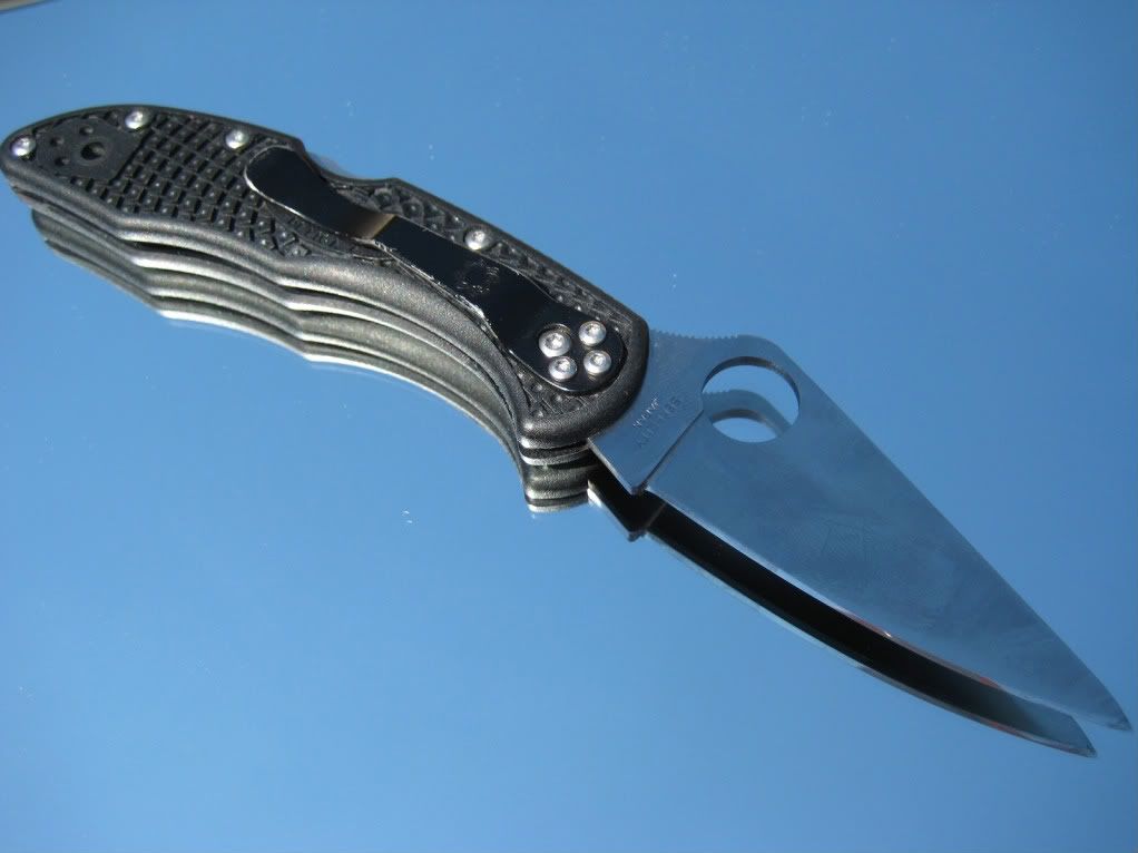

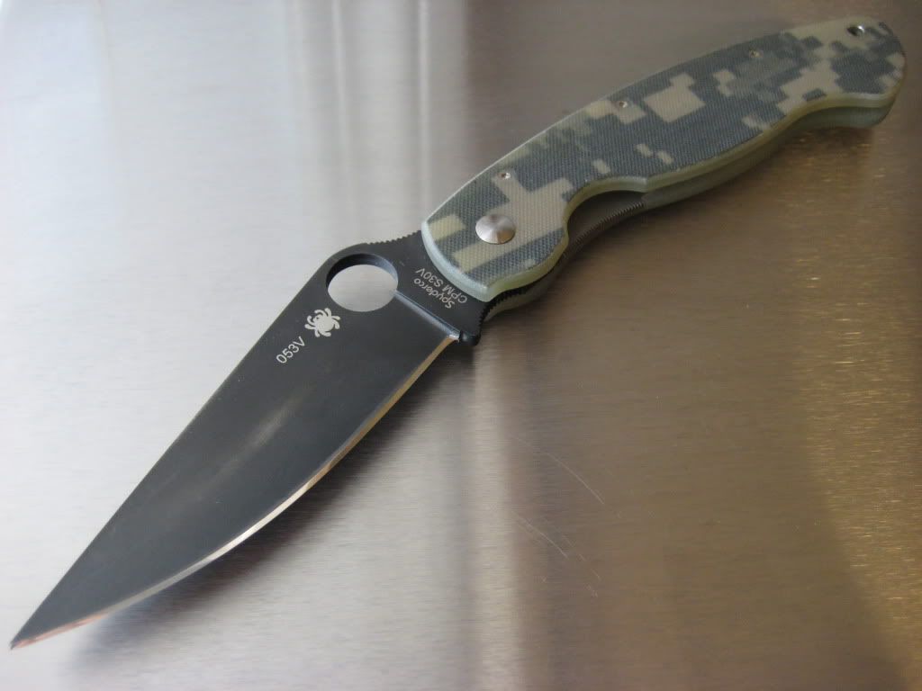

anyone have more pictures of knives done on ep's?
FFG Delica.
Military.
