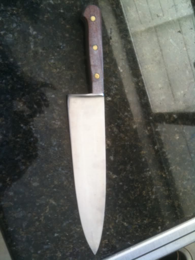

Based on feedback I decided to run home for lunch and play with the Edge Pro some more. I started with our "pizza cutter" knife. It is a very old Dexter 12" chef knife. It was used and abused by my father for many years. The edge was basically gone and there very significant chips across the blade. We used it to cut pizza because while it was very dull it was perfect to get through a pie on any surface.
Sorry for the poor pictures. The camera on my iPhone is pretty bad.

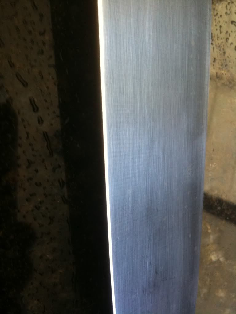

I spent about 15mins working to get a nice burr across the entire edge first on one side and then the other using the 220 grit. Before I moved to the 320 I did a very light single pass on each side to eliminate the burr. On the 320 I raised a bur on each side but it was much smaller. I finished with the 600 grit with the last round being very light single pass on each side. The end result was a much improved edge which would take hair off my arm. Pretty good considering I started with a knife that you could slam down on your arm with no fear of being cut. Here is the edge after the 600 grit. It still could use more time to even out the entire blade but it turned out nice for only 20 minutes of work.

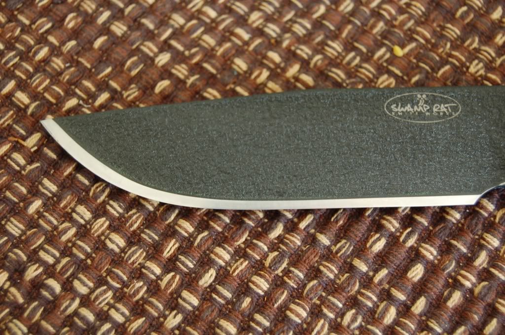

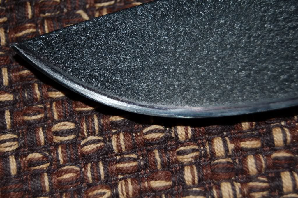

The bane of my knife sharpening existance has been my Swamp Rat RMD. The original edge was so blunt that I worked for well over an hour on my Spyderco diamond rods when I first got the knife. The end result, even at 40 degrees was that the primary edge was not even close to being touched. This picture was after grinding away on the Spyderco with the recommended light pressure:

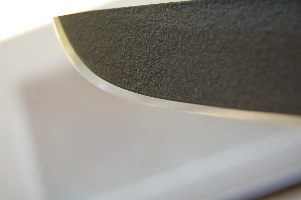

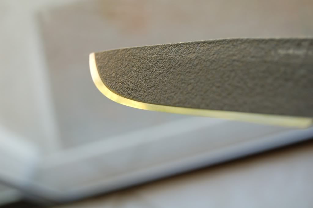

Today I worked though up to the 600 grit stones on my EdgePro Apex. The tip is still not all the way to the same angle but I touched that up with my strop after the Edge Pro. These pictures are at 600 grit but before I used my strop. After the strop the edge was frightening! Shaving hair off my arm by just touching the blade to the skin. Probably too sharp for the type of work this knife is going to do but it was fun in any case.
... and the beuaty of it is.... ANYONE can do this quickly and easily with an EdgePro! Yes, like any other sharpening procedure one does have to learn how to do it correctly. But it's not rocket science. It takes watching the video and sharpening a couple of practice blades. After that, EVERY BLADE YOU SHARPEN CAN LOOK LIKE THIS.
