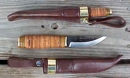

Does anyone make a Tommi pattern in stacked birch bark?
The only stacked birchbark (bark only, no stag, no frills, no colored layers, no leather) I find so far are
Aito Puukko with Bark Handle, the blade is stubby, not a Tommi profile (photos cropped per BF rules to hide vendor, PM me if you need the info)
Eräpuu - Tuohitako, the pommel is flared like a Leuku, not Tommi profile
Pasi Hurttila - Tuohipää, handle seems taller as does the blade, than a Tommi profile
Any maker crafting Tommis will fo them in birch bark too. Just prepare yourself to pay more, since bark handles are way more time consuming to make.
I've only seen one Tommi with a stacked birch bark handle. She's a real beauty, my friend received it for his 30th birthday from his mother.
image by JVoutilainen
It should be a simple matter to get one made. Find a puukkoseppa (puukkosmith) you like who makes Tommis. Upon making contact just tell him that you want your knife made with a birch bark handle instead of the typical birch burl.
Please take note that making this type of handle is a labor intensive process. There is a reason it isn't used in budget puukkos.
Here are some more birch bark handled puukkos to whet your appetite.
- Christian

Thank you Frederick89, Pasi makes a great looking stacked birch puukko. Im enjoying all the photos and education. Ive also discovered your posts on the bushcrafters forum.
Thanks for the pictures! and the link, those are beautiful and very useful at illustrating the handle shapes that Pasi Hurttila makes. I believe he also designed the Spyderco puukko. His stacked birch starts just above 2 Benjamins. I like his work.
The Aito Puukko with Birch Bark Handle, and the Eräpuu - Tuohitako with Birch Bark Handle, are both entry level, under $100. I prefer the longer more slender blade of the Eräpuu, and the unflared handle of the Aito.. fun stuff learning to spot all the differences in Puukko designs.
