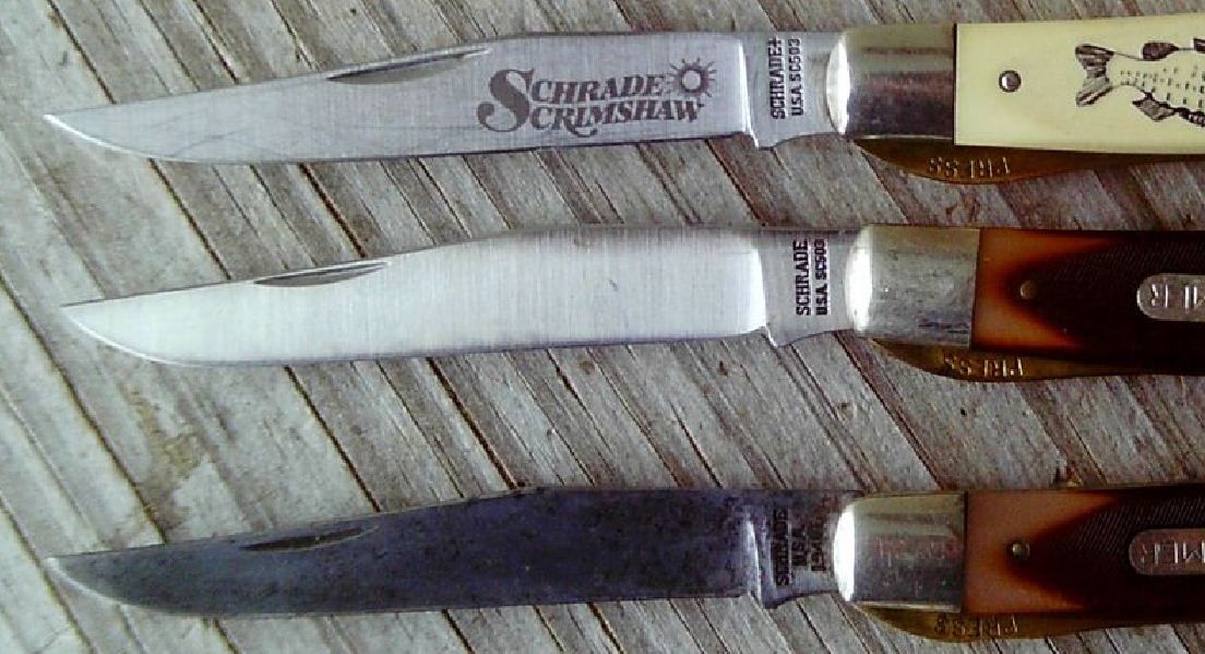

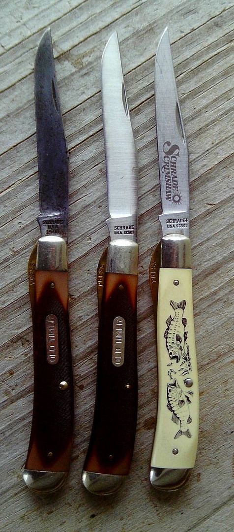

Left: 194OT, middle: 194OT/SC503 mis-stamp, right: correct Schrade+ SC503

Nice group. Depending on when and where the middle knife was acquired, it could be one of the famous "End Of Days" knives. When the production workers at Imperial Schrade showed up for work one morning in July of 2004, instead of time cards they got layoff notices. Production of new parts was esentially halted and a skeleton crew of workers was kept on until nearly the eve of the October assets auction with instructions that, "If it fits, assemble it", from the trustee in order to fluff the inhouse inventory of finished knives to the max. This resulted in a number of oddities emerging from the truckloads of finished knives hauled off by the two main inventory buyers, to be sold in boxed lots to resellers (many on eBay), and through their own respective stores. However, some oddities rejected from the earlier production were sent over to the in-plant employee store for discounted sales to employees. Early on, these usually had a strike or removed tand stamp. Apparently later they just moved them from the QC bins to the store.
OK, after prattleing on, the blade isn't misstamped, it matches different covers... earlier (prestainless) scrimshaw editions of the pattern. Apparently the frame/covers is misbladed. :)
Michael - sorry to ask this so you are saying that the middle 194OT is NOT mis-stamped, but having had OLD TIMER scales assembled to the knife? - it looks to be a Stainless - is the nail nick an indication of blade age - or purely the Stamping I cant tell the difference between the stamping - well yes I can they are arranged differently - but what is what - is above me.
Oh, minor details. Blades were made with the marks on them and then assembled. Not assembled and then stamped. Make sense? Like saying that car has the wrong tire, not the tire has the wrong car. ;)
What I noticed is the 194OT (bottom) and the middle one have the same blade profile and the nick is in the same place. The blade has spots of patina on the back and I believe it's 1095 (and it doesn't have the "+" after the Schrade stamp either). Notice the correct Schrade+ SC503 (top) has a different blade profile and the nick is in a different spot.
The 194OT/SC503 knife in the middle was purchased from a collectors estate and appears to be NOS so no patina but I think its carbon.

Ok, that's it!!!!!! It's the earlier pre-stainless SC503 blade fitted with 194OT covers! :thumbup: I had faith that the answer would be found in this thread!!!!!!
Thank you sir!!!! :)
