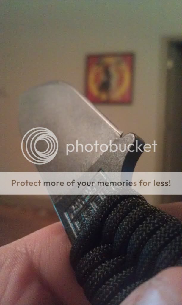

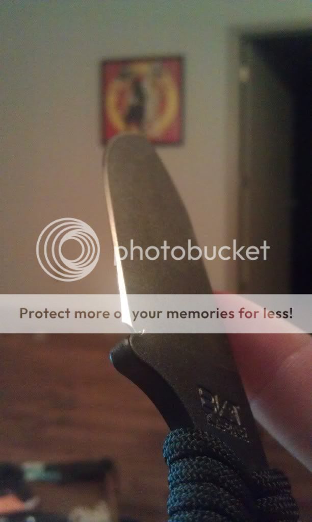

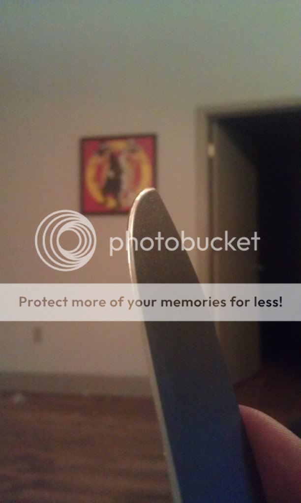

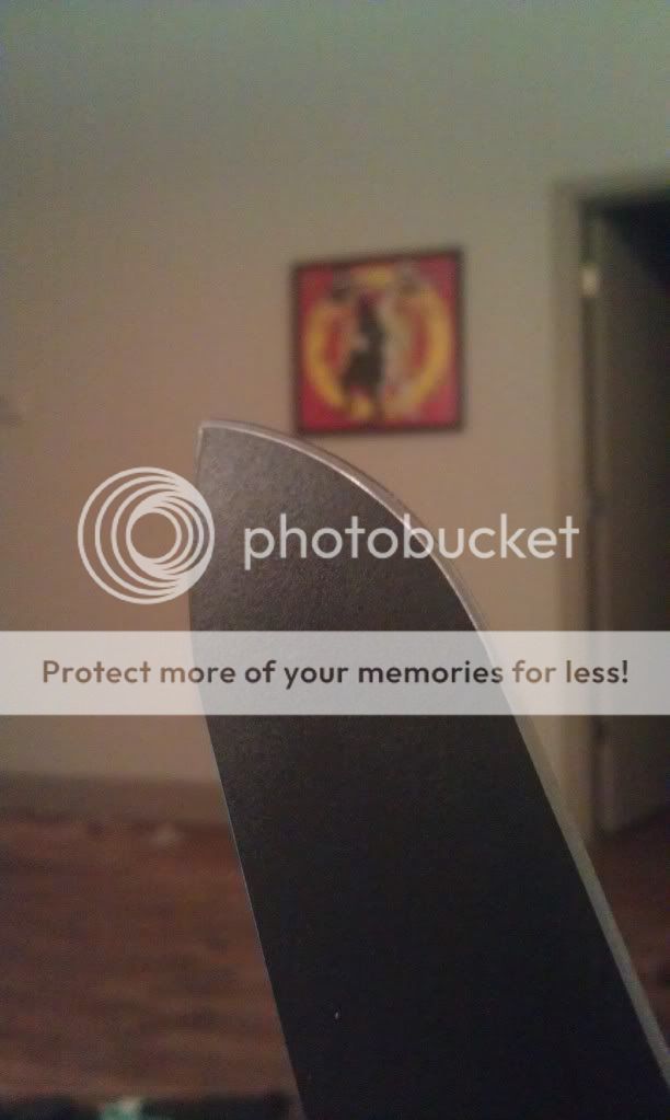

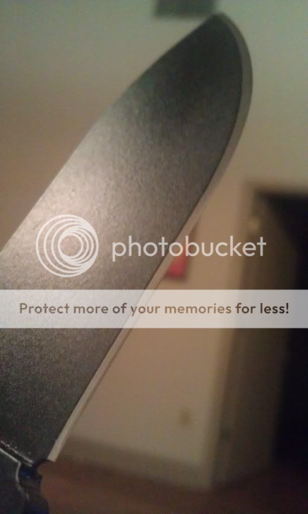

Ok, I do believe I am an idiot... I spent about an HOUR with my KME on one of my 14s...
As it stands, I still can't shave hair. I don't know what the hell I'm doing wrong.
I did drop it down to 18 degrees per side. I used the coarse, medium, fine stones. Then I stropped on green and black compound. I still can't frickin' shave. Don't know what I'm doing wrong.
Cbear, get a fine red india, some WD40 and learn to freehand it. You'll pick it up in an evening.
You may be flipping the burr back and forth from one side to another. A few passes on an India might remove it.
Did you try the sharpie trick? Also make sure your hitting the apex and forming a burr with each stone then removing it. At very worst you can send it to me :D to be sharpened
EDIT: on the 4th picture it looks like you still have a burr that hasn't been removed towards the tip. Try pulling the edge through some hardwood a few times to remove it then strop.
Did the sharpie trick... It seemed like I was hitting the whole thing.
I don't have an india stone, so that poses an issue. However I just pressed a bit harder on my strop and I was able to, after a few passes, shave the hair on my arm.
I'm on my phone so I didn't see it right away, but there is a burr in that pic. DJ is right. I'd color your edge with sharpie and go back to you fine stone and do a few passes on each side to see if you are removing it all. If you are removing it all, do some passes alternating sides with very light pressure. Do say ten passes per side. When you do the sharpie you have to look very close to make sure that you are removing it all to the very edge.
