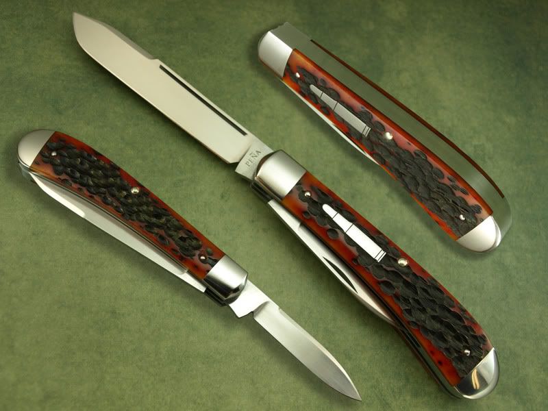

How will I ever be able to look at any other knifemaker after these..well there is one other Laredo-ite
If it is possible to fall in love with a knife, I think I just did. That is beautiful.
I'll arm wrestle you for that one. And another one that is about 3 1/2". I love this pattern with the spear blade.
Very nice set Enrique. :thumbup:
Wow, I woke up to the e-mail with the group shot this morning. One word: AMAZING!!
One more bullet and you could fill a revolver. Great job Enrique!!

Incredible knives, Enrique! Simply beautiful :)
Especially to me as I am a huge fan of R-1123s...

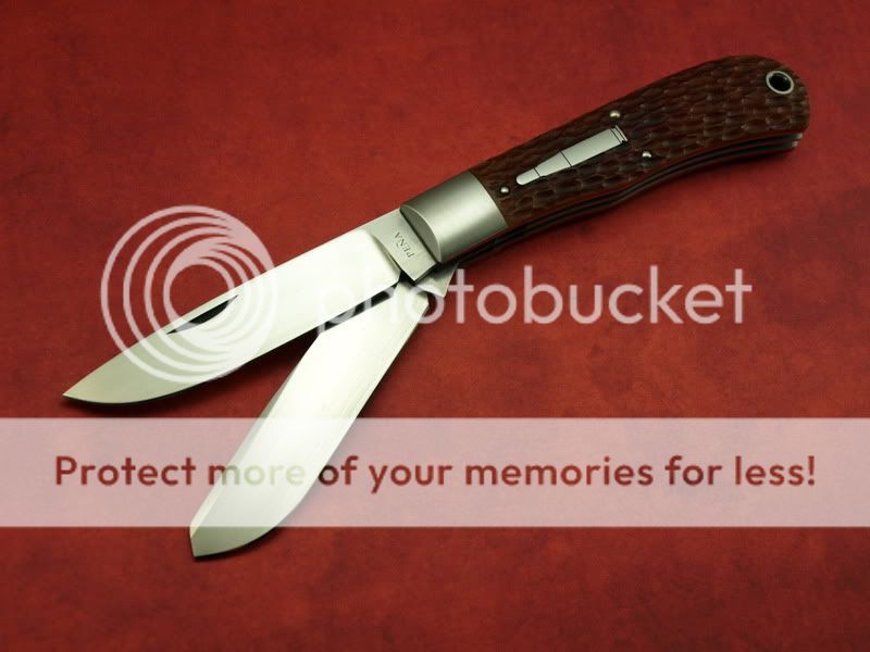

Hello to all. Here is a Remington 1273 hot of the bench. This one has some nice looking mahogany color jigged bone that was bought. It also has integral liners and bolsters made out of 410 stainless, which I really like how it polishes and also I think it is stiffer than 416 stainless. It has a very nice walk and talk and it is 4 1/4 inch closed. Just thought I would share. I'm humbled to say thanks for all the great comments that you guys always give me. Knife not for sale
Another stunning knife, Enrique. Love everything about it. :thumbup::thumbup::thumbup:
(please tell me I am getting closer to the top of your list :D)
Colin.
I use 410 for the majority of my knives and I can tell you your right about it being stiffer and takes a bit better polish. The drawback is that it does not machine as well as the 416.
Nice looking work!
Ken
Nice looking work!
Ken
It is harder to machine but I think it is worth it. This knife was not touched by the buffer and there is a big diffrence, especially in the handdle material. It was finished by hand to 6000 grit. Thanks guys for the comments.

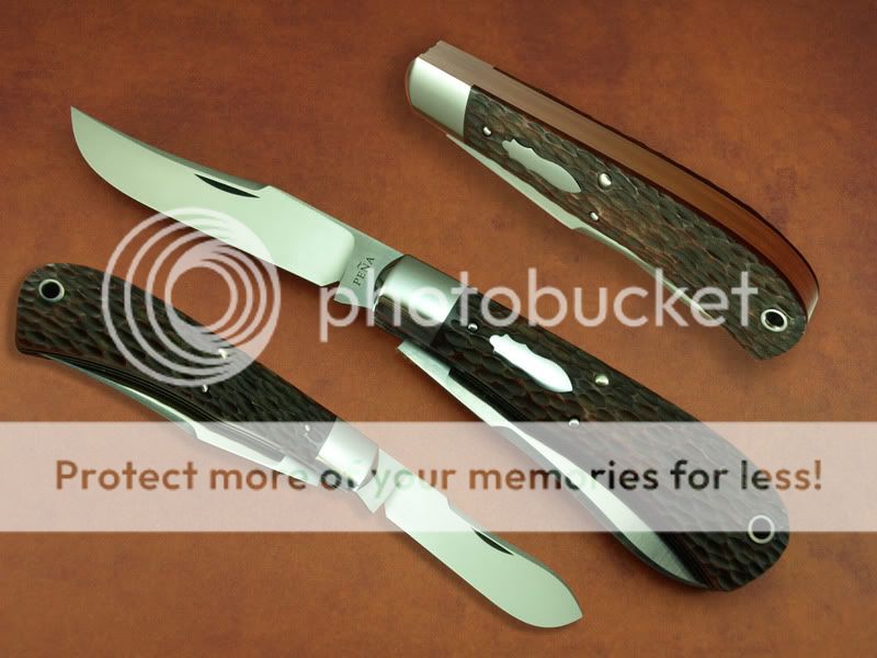

Hello to all. Here is another one hot of the bench. It is patterned after a Tony Bose knife with my own take on it. It has intergral bolsters liners with ground finish blades, my own jigged bone, double pinned shield and it is completlly finished by hand. Just sharing the photo with you guys. Thanks for all your great comments. Knife not for sale.
