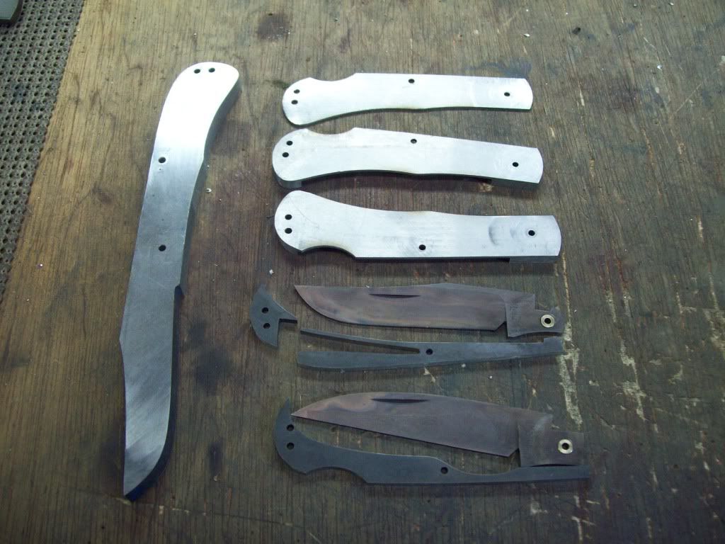

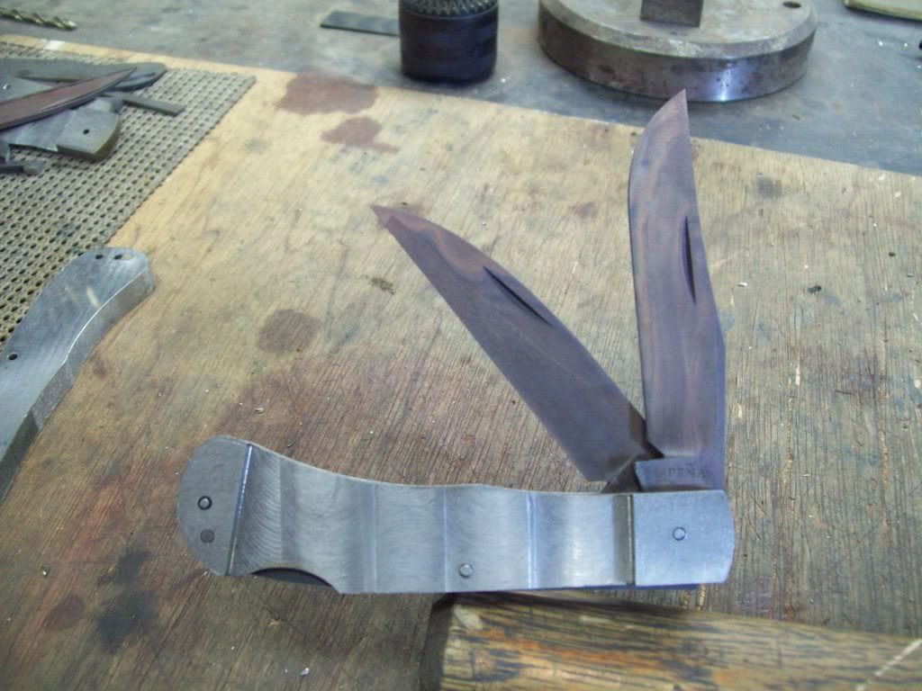

The sowbelly could be made to where it is a single blade lockback or make it like Ryu Kawamari makes them, the main blade is a lockback and the second blade is a slipjoint. I'm currentlly making a trapper that will be 3 7/8" closed with a clipblade that will be a lockback and a wharncliff that will be a slipjoint. It will be the first one I make and I will mark it with a "p" for prototype. It will not be identical to Ryu's knife but I did get the concept from him. I will get some pictures here soon.

Here are some pictures of the knife in progress. It would be nice if some of you that own some of Ryu's knife would post them. I really think his work is way way way up there and is hard to beat.

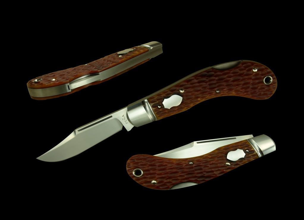

BTW, you've really been making some remarkably nice bone recently - great color (with nice variation within each scale) and great jigging. And that lockback saddlehorn is superb - one of my alltime favorite patterns.

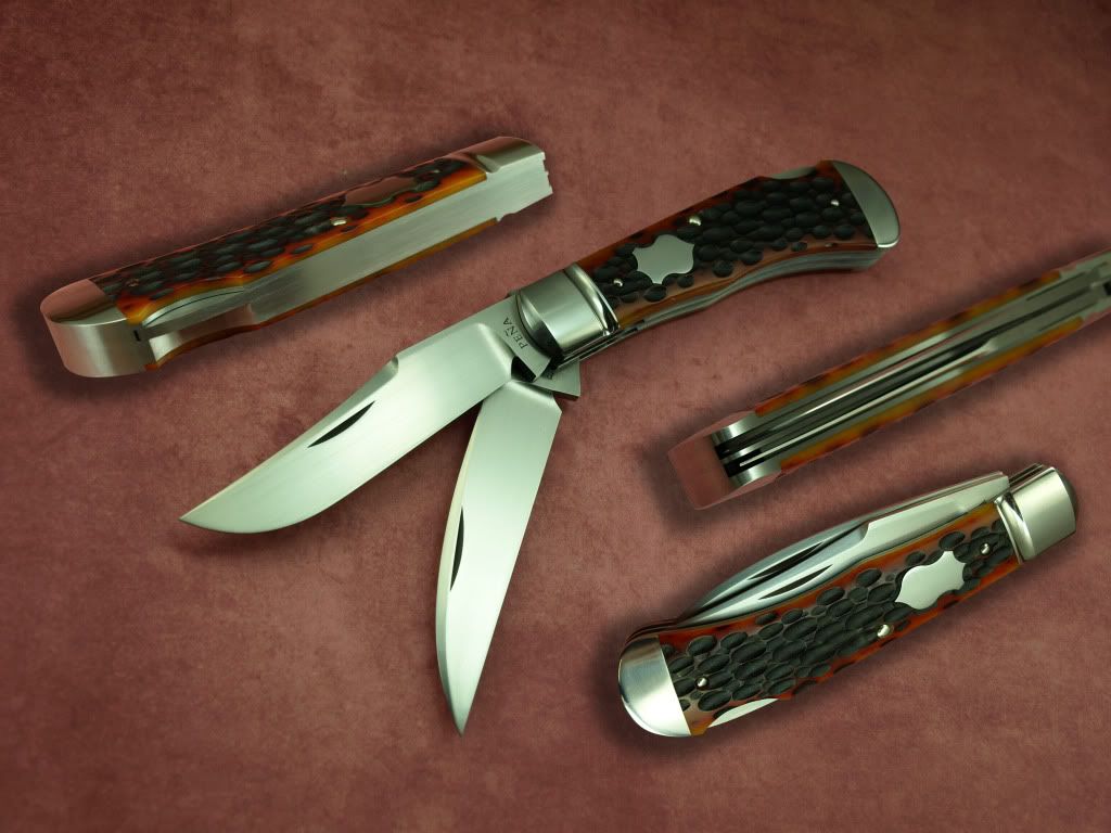

Hello onece again to all and thank you for your previous great comments. Here is my version on a Premium Trapper. I have a pattern of the Premium Trapper that Ryu Kawamari shared with me but I decided to do my take on it. and here is what it turned out like.
The knife turn out really nice as far as function and fit and finish. This knife is 3 15/16" closed. blade and springs are CPM154, liners and bolsters are integral made out of 410 stainless steel, shield is made out of 410 stainless steel and double pinned, blades have pivot bushings, the spine is really tight,flush in all positions and clean, nice action on both blades, the action on the clip blade is a lockback and the action on the wharncliff is a slipjoint, the handle material is my own jigged bone.
