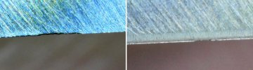

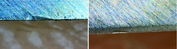

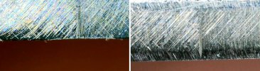

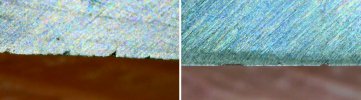

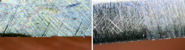

Then I put each knife under my $30 digital microscope and checked for edge damage. The ESEE 6 didn't seem any worse for wear, but the 18 DPS edges on the Izula and ESEE 3 chipped and rolled in few places. I was a initially a little disappointed to see the damage, but I remembered that I needed a strong magnification device to see the damage in the first place; none of it was visible to the naked eye.
I aimed to correct these blemishes with the black arkansas stone, and I honed each knife with alternating slicing strokes with light pressure. The edges noticeably became more prickly under my fingertips, and I took the knives back to the Bess tester. The edges that had previously been profiled to 18 DPS showed the most improvement. The Izula and ESEE 3 are back to push cutting thin paper and shaving hair.

Here are screenshots from my digital microscope showing the Before and After of the largest blemishes to the Izula and ESEE 3 from my novice tree stabbing. The darker strip close to the cutting edge in all the after pictures demonstrates that I was holding the knife angle a bit high on the arkansas stone and was basically micro-beveling. I didn't do it long enough to get all the edge damage out, but the edges are far more cleaned up and do not feel or perform as if they need more repair.
