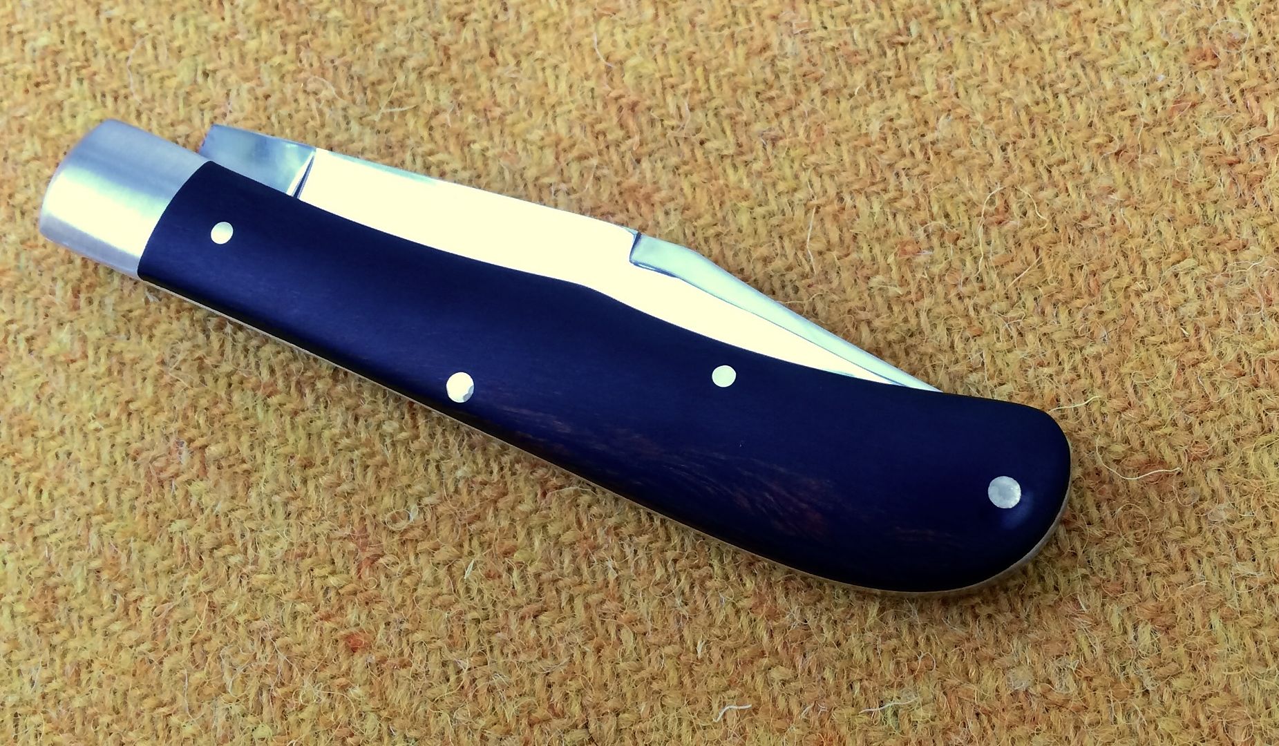

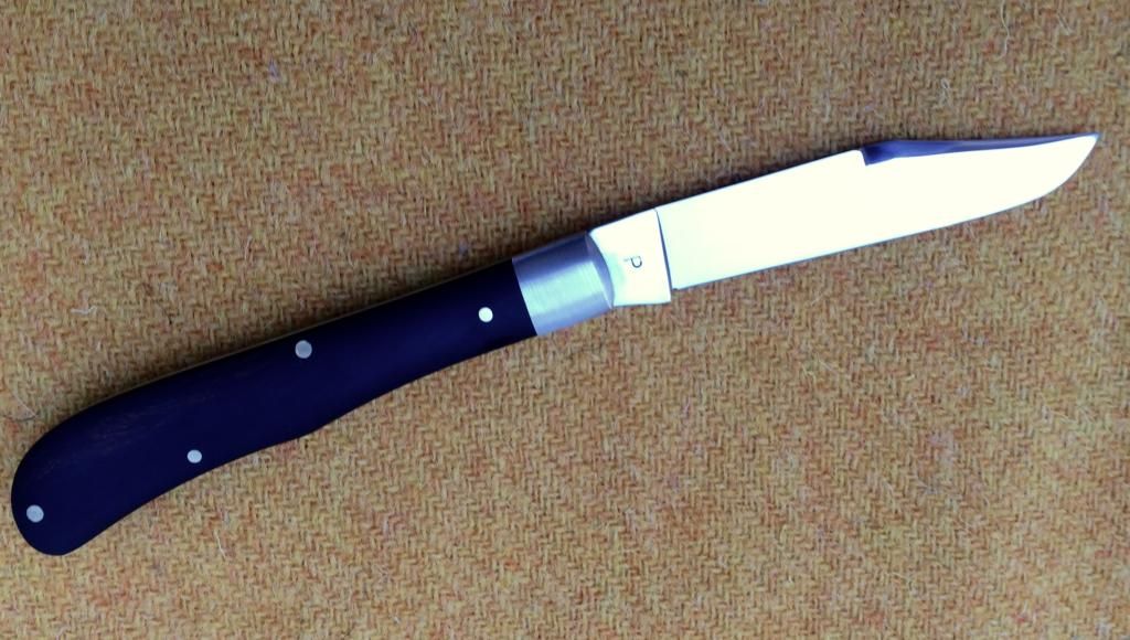

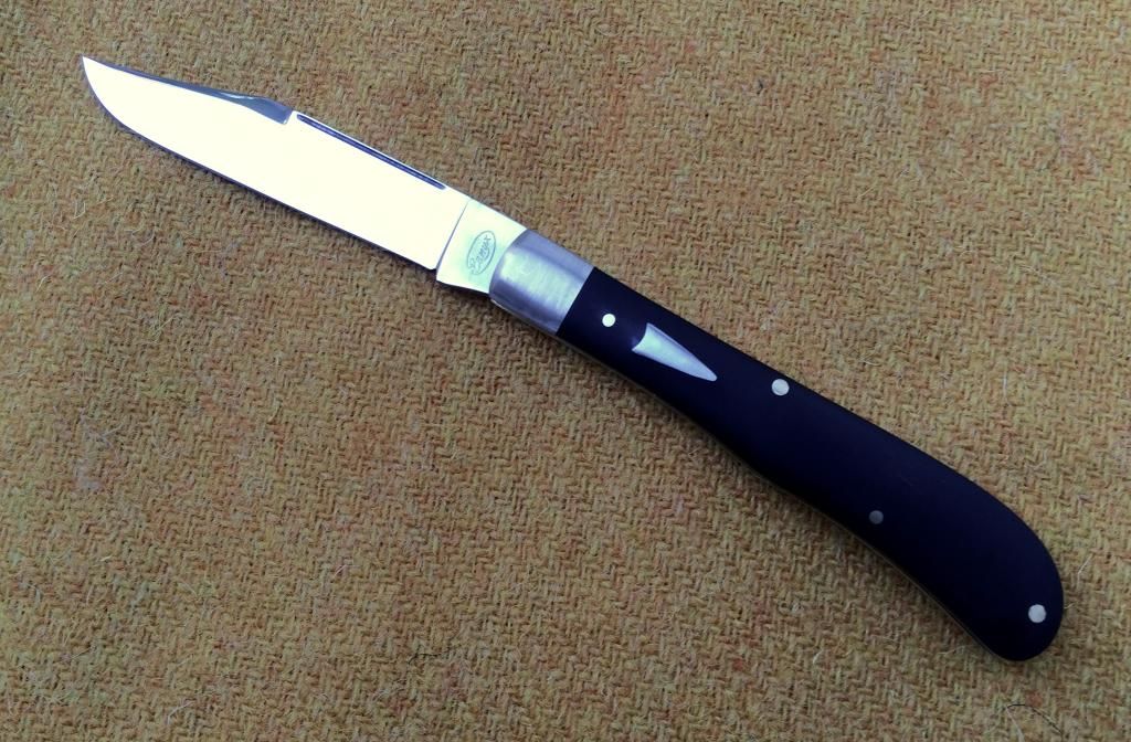

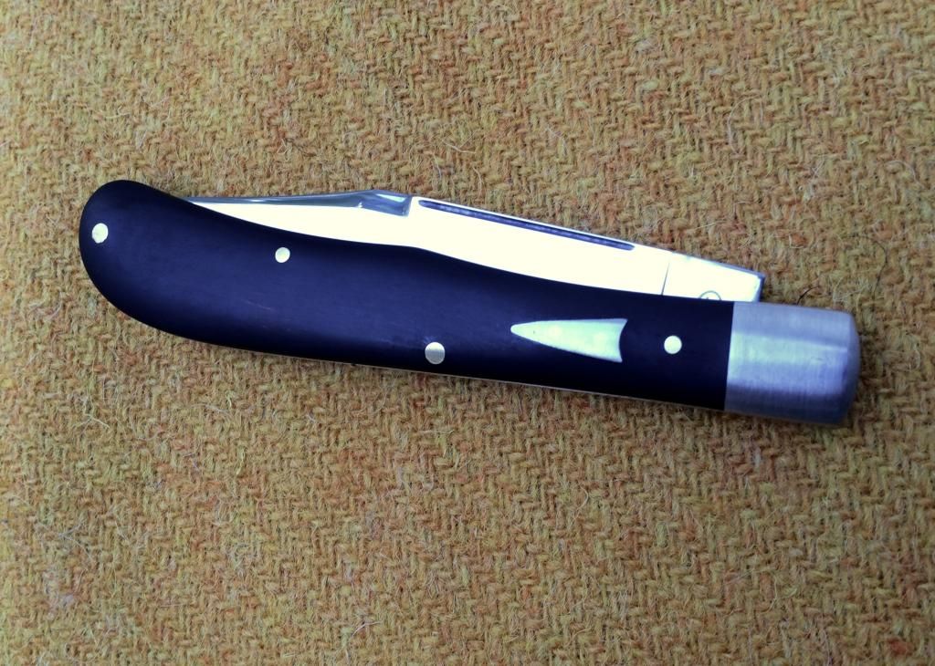

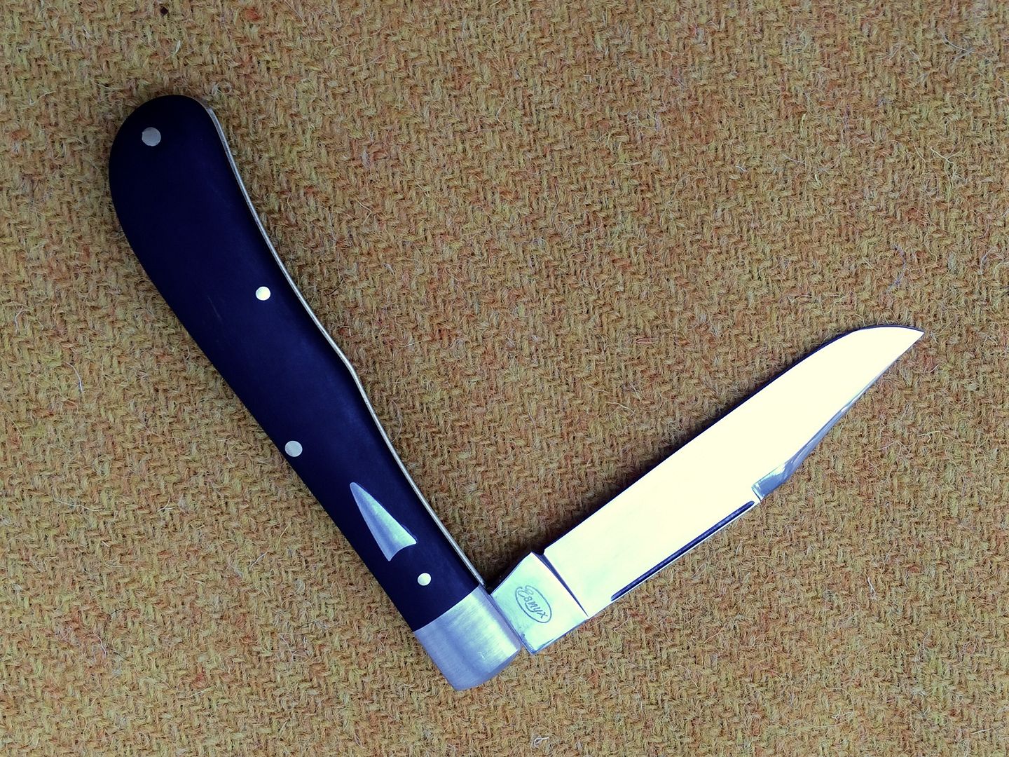

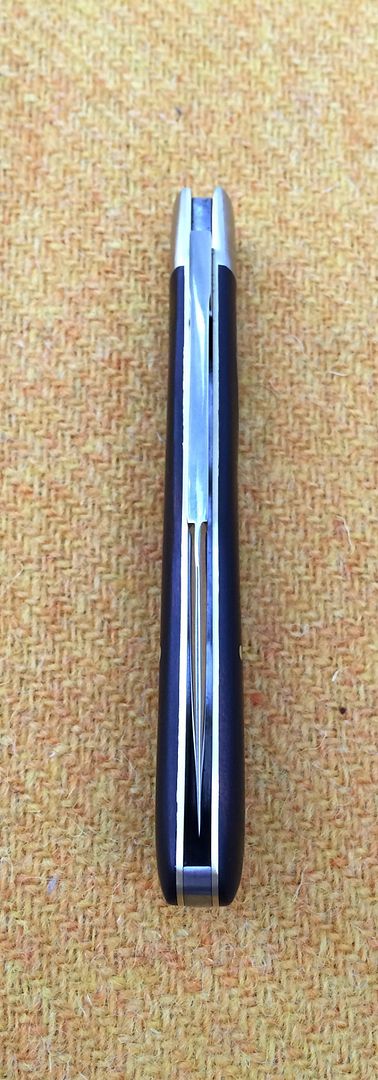

Here is my take on a trapper pattern. I finished this guy up a few days ago, and wasn't completely happy with it, so in my pocket it went! The knife is about 4" closed, with 1/8" 1095 blade and spring, dark Ironwood scales, double pinned shield, brass liners and scale pins, and nickel bolsters. This guy has a nice heavy spring and has a pull right around an 8, but I can still pinch it open on the longpull. This is a really sweet knife, but it has a little blade play that I wasn't able to fix without compromising the action. I just couldn't let it leave the shop like this, so i decided to keep it, and maybe gift it to someone at some point. Thought you guys might like to see some pics though, so, here it is!
What do you guys think?
Pattern's beautiful bud. You know how inexperienced I am when it comes to slip joints, so a question is in order... Now that I have a few beaters in my collection I know what blade play is, but how much movement and along which axis, takes a blade off the market for you?
I know it's probably a personal standard set by you, but in my reading I've come across blade smiths / cutlers that suggest some tolerances in slip joint design to be deliberately "loose" in order to function better in working environments. To draw a parallel, "loose" as in comparing an m-16 rifle to an AK47 platform; while the m-16 platform may be far more precise in its design, the AK47 is a lot easier to operate and maintain in a dirty environment...
Just wanted to pick your brain here, because if I remember right, these cutlers/blade smiths were specifically talking about the spring mechanism and not side to side wiggle...
Thanks guys!
Zach, what I mean by blade play, is that I can feel that the in the tang area of the blade is ever so slightly loose when I open it, hold the blade by the tip and give it a wiggle. Personally, I don't mind a little blade play at all, but I judge my work at a higher standard than my own tolerance for minor issues.
Thanks guys!
No doubt about adhering to a higher standard, just wondering where you drew the line on this particular piece. Thank you for answering specifics.

Evan this a nice take on a trapper, I can understand the feeling that nothing but perfect can go out. The scale are fantastic and so is the shield, though I could think of something little bigger. I also think that the knife could benefit a half hidden tang. Anyway you are doing great and improving in every knife.

Evan, you are doing great work with what tools you have thus far! :thumbup: Once you get a surface grinder, the light wiggle issue you had with the trappoer will be a thing of the past. ;)
