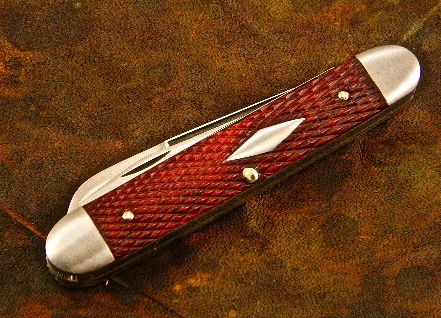

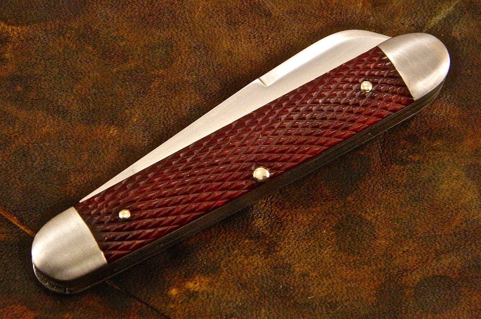

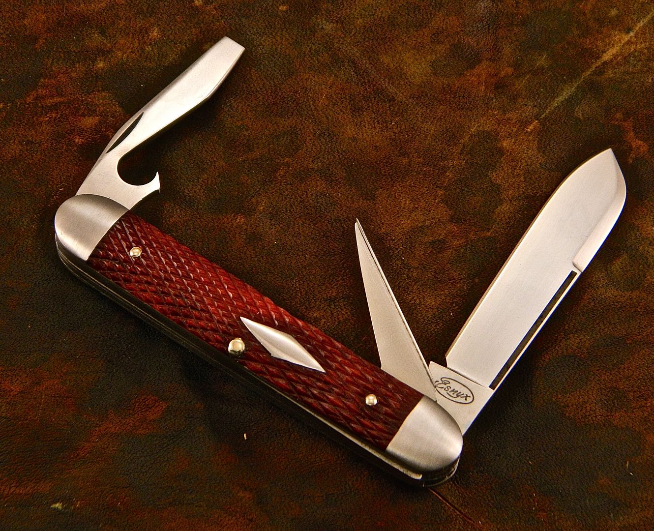

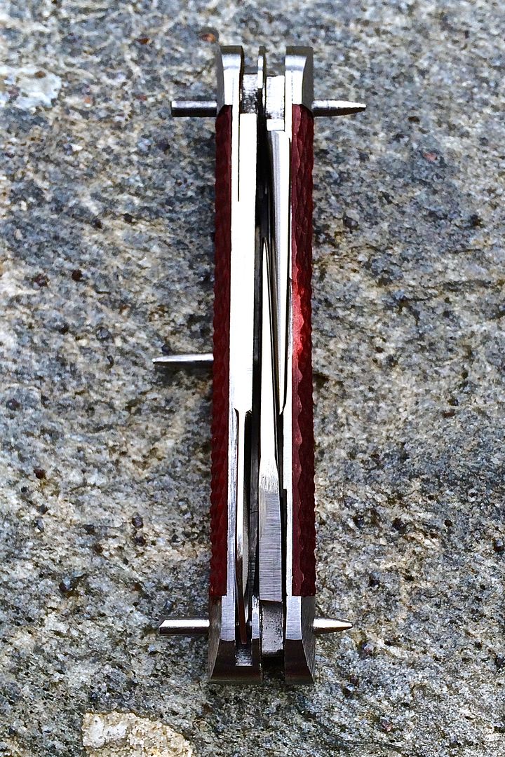

Here is a fun project I have been working on, a "work in progress" Cub Scout. Blades and springs are CPM 154, with stainless liners and bolsters, and personally processed, dyed, and checkered bone, with a closed length of 3.5". The deep red gives me the feel of the old SAKs, while the spear blade, bolsters, and pattern is reminiscent of an older knife. I based the main blade off of an old Schrade scout I have.
I feel like scouts are uncommon, albeit wanted, in production and/or custom knives today, and it is a favorite pattern of mine, being one I use almost daily. So, I decided that I wanted to make one that encompassed my favorite elements of the cub scout knife. This is my prototype scout, and will be going straight into my pocket when completed! More pics to come tomorrow, once I finish it out.
*the iphone pics don't do this knife proper justice
Constructive criticism is welcome!!
Wow, the immense detail and patience in that checkering is phenomenal, coupled with the modified sheeptsfoot/swedged spearpoint. The caplifter/screwdriver portion does look a touch long aesthetically compared to the other tools in the knife but I find no fault in that considering it gives more length and slimness/ease of accesibility to the slot in actual use. Great job Evan, can't wait to see it finished up~
Evan,
I am really impressed with your scout, and although I agree that the caplifter looks a bit too long and slim compared to other knives (GEC's, SAK's and so on) it's a purely aesthetic thing, and function is the only thing that really matters. I would rather have a sheepsfoot blade, but that's just a matter of taste. Very nice work. Your progress is impressive.

Having seen this knife (and a few other pieces of Evan's work), I can tell you this is a fella to keep your eye on. :thumbup:
That thing is absolutely stunning in person! I don't think the caplifter is overly long at all. And the checkering on that bone must have been hours of work.
Evan, we want pics of the finished knife buddy! :thumbup: It looks awesome! :D
This is some terrific work done. Real impressive...get me on that list!
The "snakeskin" effect on the scales must have tested your patience...but will def be something that will be a pleasure in hand and use.
looking forward to the coming pictures and progress.

When you see larger pictures of the checkered bone, they look impressive enough. When you see the knife in hand and you know the checkering was done by hand, that is an astounding feat of patience. Top notch.

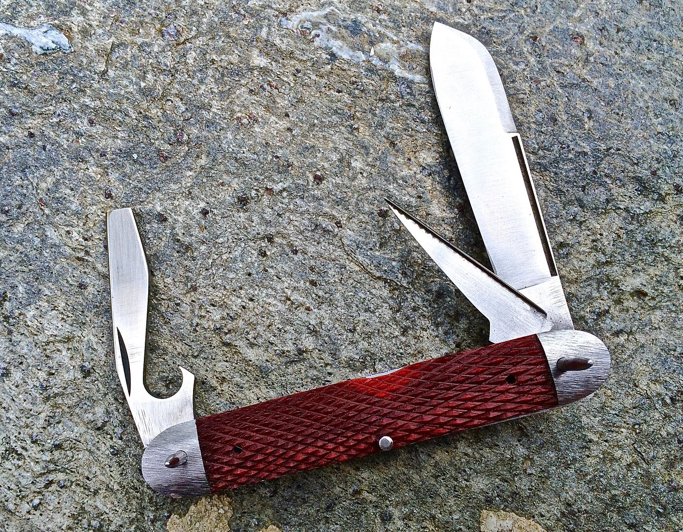

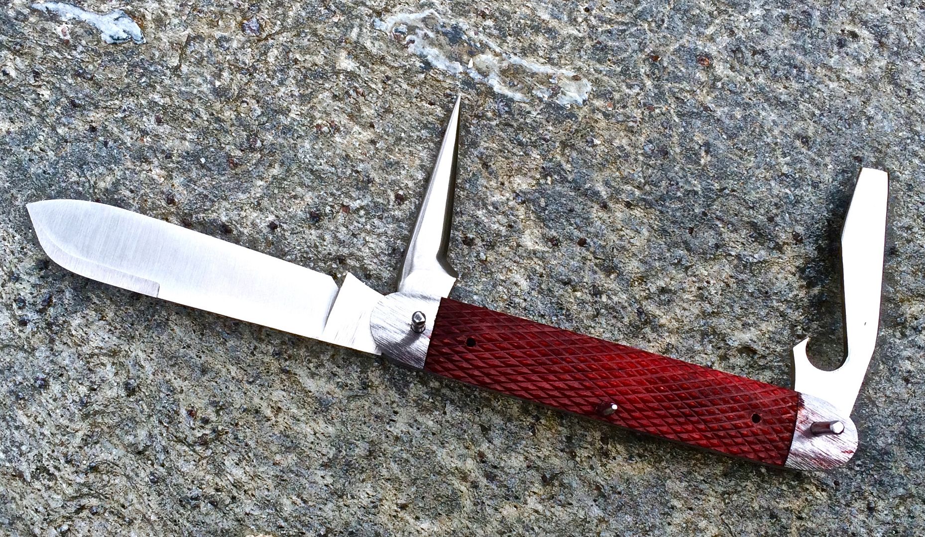

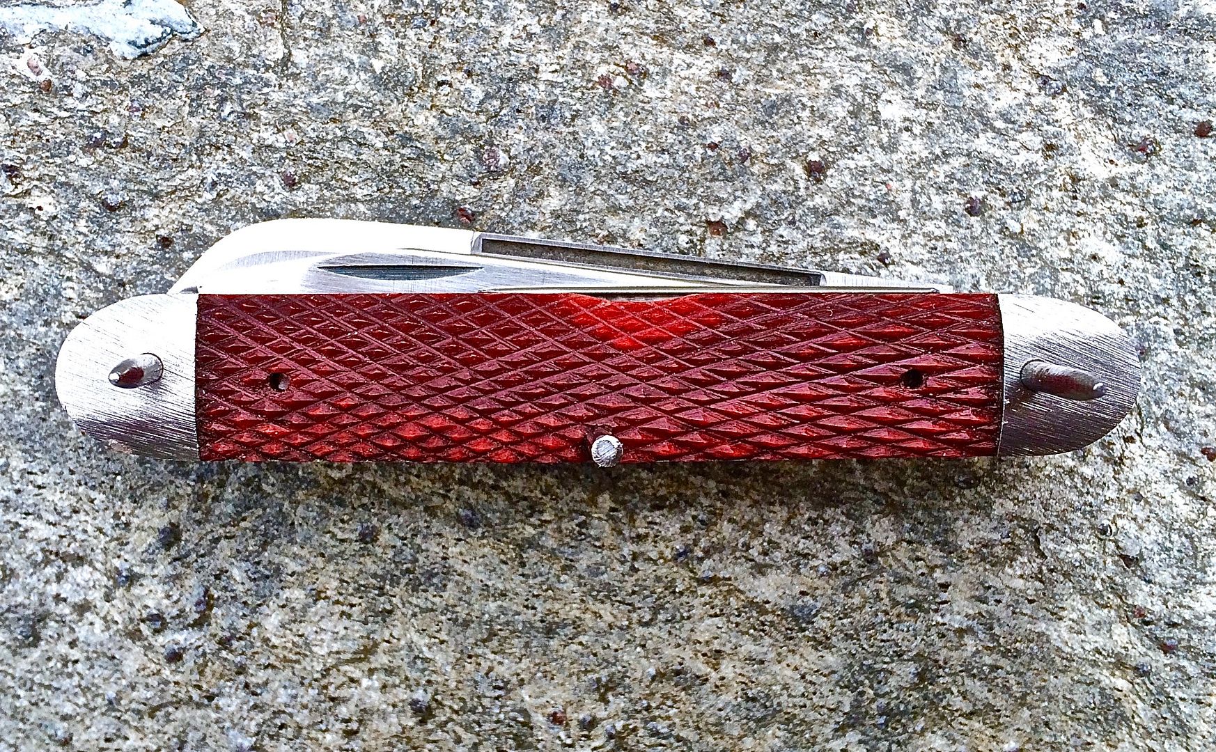

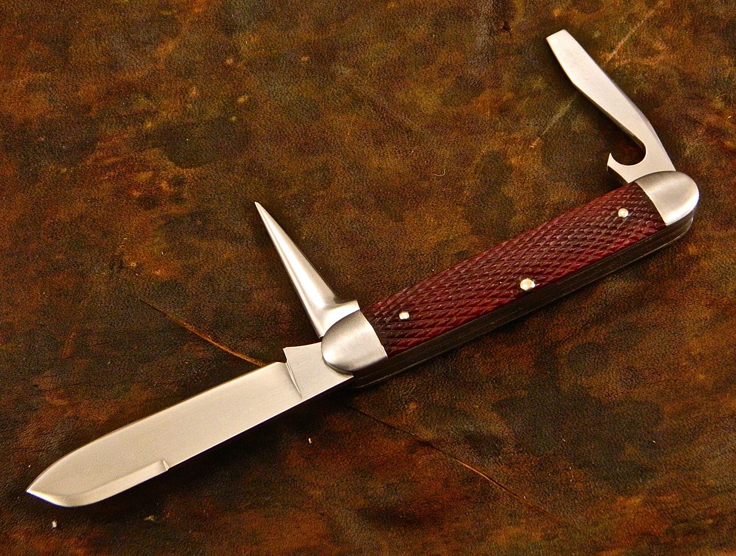

As promised, here are pics of the completed cub scout.

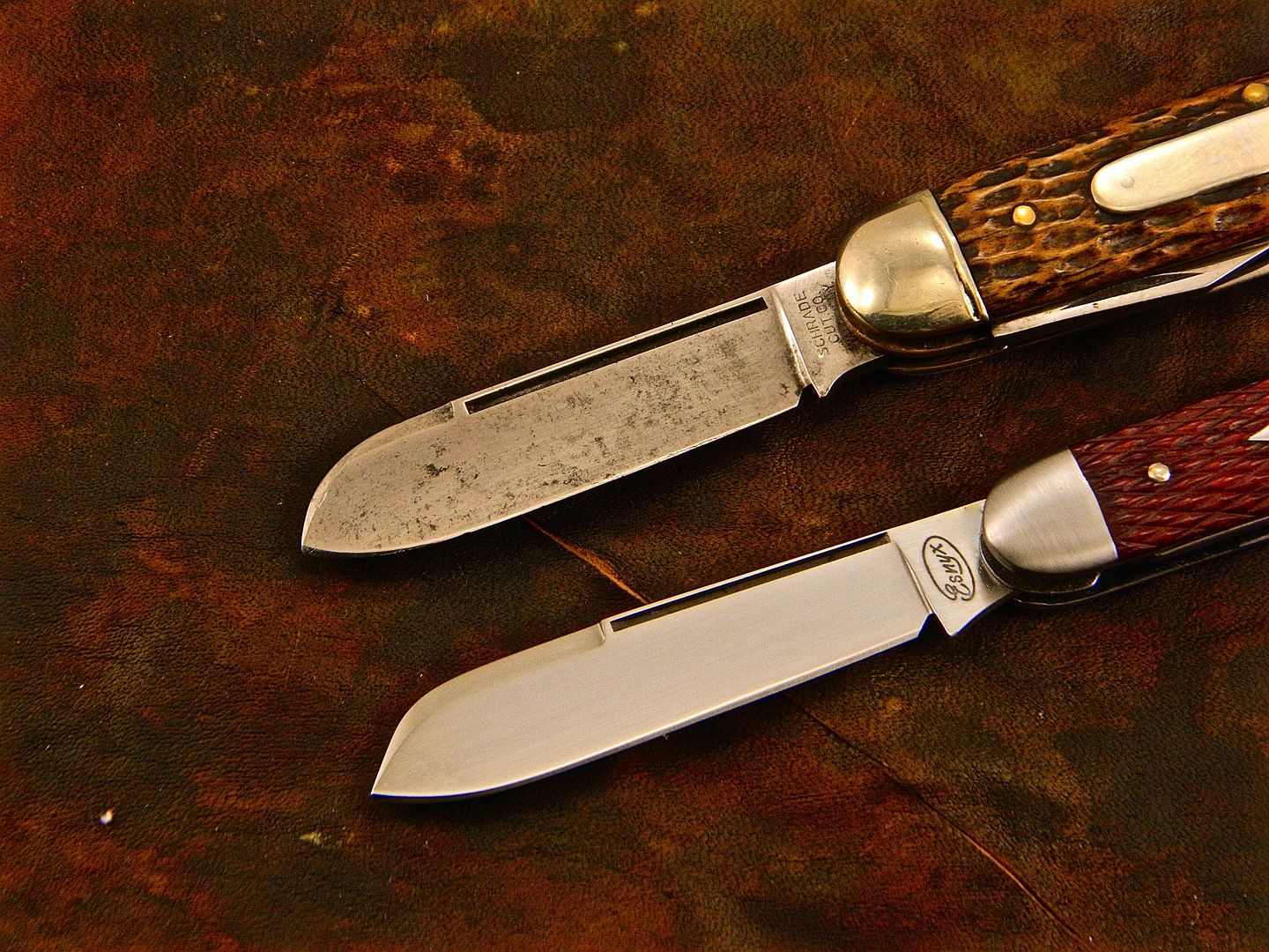

I based the shape of the main blade off the the spear on this old Schrade scout.
Fantastic! Great job, Evan! :thumbup: :thumbup: I might have to choose this pattern when my name gets pulled from the hat ;)
What's the width of this one?
I love the three blade/tool idea. Really had everything you need and nothing more.
Ding dong daddy, that is nice!
Love the hand checkering, Evan!
