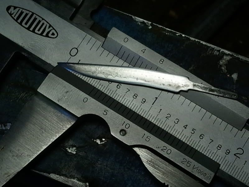

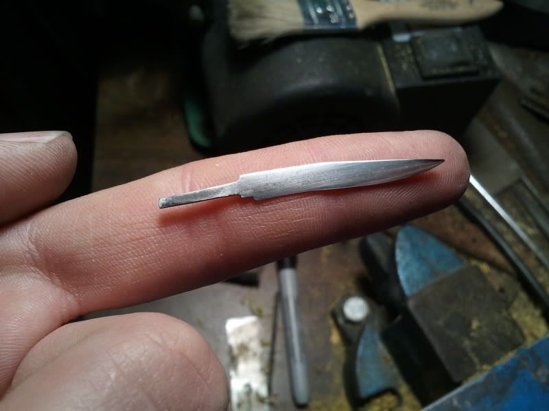

Since you said it was ok Daniel, here is what I have going on. First up my mini for the KITH.
Totally botched my first blade, I may try to salvage it still, but turned my efforts to this blade. W1, .025" at the ricasso, fully distally tapered and sortof hamon.
Using RyanW's standard unit of scale...
I may try to redo the HT the hamon didn't come out the way I had hoped.
Still undecided if I am going to do a full D guard or an S guard with this one.

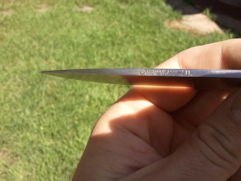

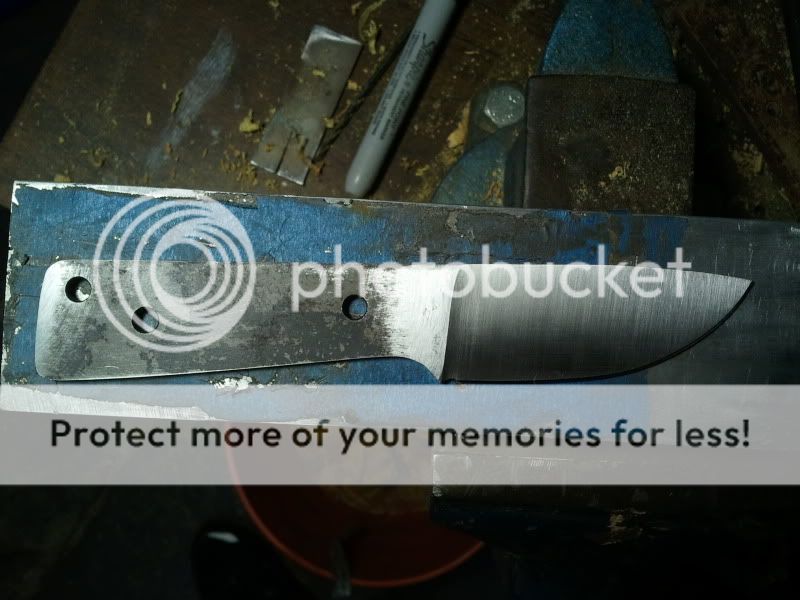

Here is my M. Wohlwend DIY knife WIP.

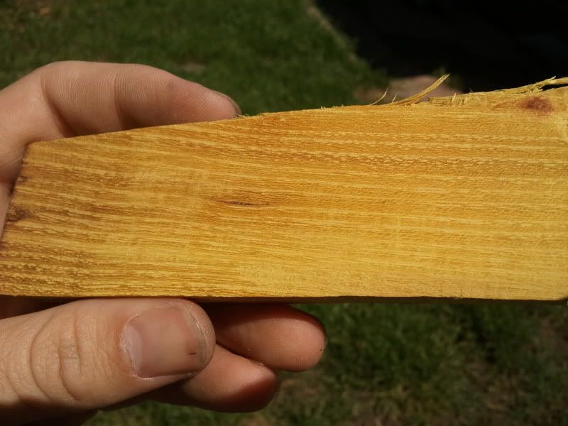

I dropped the point a bit, the perfectly straight spine just was a little to rigid looking to me. Removed forge scale from the rest of the profile and ricasso. Scales are going to be Osage Orange and pins will be mild steel blued on the ends. I hoping this wood does ok with checkering and doesn't destroy the cutters, it is some super hard stuff! I'm going for 1911 style scales since the shape is similar and the location of the thong hole just adds to it.
Let me know what you guys think...

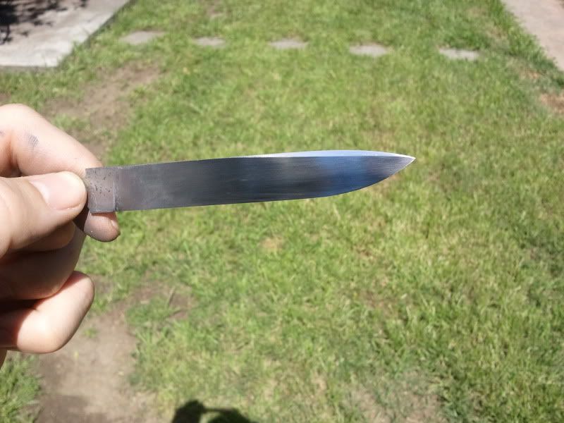

Lastly, here is a heavy duty Fin & Feather I'm making. More for like salmon and geese than grouse and trout. 1/8 1084, ~4+" blade, my first attempt at a hidden tang. Bronze guard, snake wood handle.

Xander those are looking good! That osage looks like a nice piece. I think the idea of a checkered 1911 style grip sounds too cool on that handle, that is going to look great! That is the best handle idea, you better hide that one or you may be forced into full time knifemaking!
The mini is looking sweet too! I bet that hamon was tough to get at all on something so small! Very cool and lots of skill goes into something so small!
I really like the salmon/goose knife :D awesome! I can't wait to see the guard on it. That will be a nice one for just about everything. The snakewood sounds excellent, that is one of my favorites and will go great with the brass guard. I'd like to see more brass on knives in general.

Hey, thanx Daniel! That Osage came from DanCo's brothers house and he sent me a 4x4x10 block, so I have plenty! I hope the scales come out nice, I'm still debating scorching the surface of the osage before I attemp checkering.

The mini hamon is a bit tough, but I make a very thin refractory clay, like the slip coat for a full sized knife, and shape the squiggly line with an exacto blade. I'm going to redo this one so maybe I'll snap a few pics.
I really enjoy making the minis. Yours is still my favorite I made! I was a model builder for years so the transition to making minis was pretty natural. I really enjoy figuring out how to make certain things at that scale, the challenge really captures my attention.
The Fin & Feather is another favorite pattern of mine. I have a real soft spot for bird and trout knives. I may commision one from you Daniel. This one I just beefed up a bit, more of a small hunter, but still able to process small game. Some makers call this size a "SGK." The bronze I have, you may remember, is of controversial origin. I don't want to open that bag of cats again on here, so I'll leave it to that. Anyways I have slotted it and am doing some fitting to the tang. Still working on post HT sanding right now to bring the edge to final thickness. Still don't know how I want to shape the handle either. I need to make a broach for it from some scrap.

Cool, scorched osage looks nice. Texas Osage!
