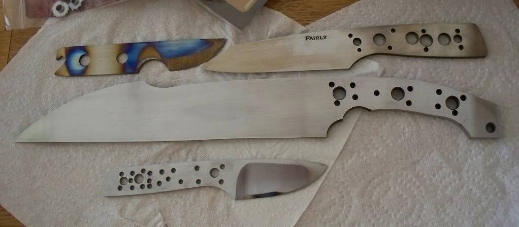

The top three are my current batch and they are almost ready for scales to be glued up. The bottom one is another edc variant that is ready for heat treat.
Drill hole info... each knife has some holes for tubing or something like that (pins, chainrings, screws...) . The smaller holes around the tubing holes are for "glue rivets," they get filled with epoxy and add a lot of strength to the chemical bond. I sometimes add holes to lighten or balance the handle, it just depends on the knife. The Ti knife is getting huge flared Ti tube rivets and is light as is so it doesn't get any holes besides the rivet holes. Each knife will be rough sanded on the handle area for maximum adhesion strength.
I once drilled out all the mechanical fasteners from a knife and froze it then tried to knock the scales off by hitting them with a 3# sledgehammer on the side bolster area, I couldn't get them to budge! The G-Flex epoxy I use is the very best I know of and really works great, I have flexed a few knives in a vise and the scales stayed perfectly attached.
