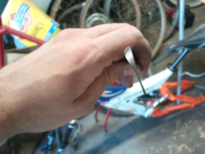

Thanx Daniel, and everyone for the kind words! I just finished resetting the edge and stropping/lapping to bring it up to shave ready. It cuts a free hanging hair with effortless swipes and I managed to fillet 4 slices off the hair in the same spot! This brings my sharpening skills up to a whole new level, I used the most basic supplies to do this as well, newspaper, plain untreated leather, 1200 and 2000 grit paper and a litte CrOx (green polishing compound) on denim. All stropping was done as a paddle strop or bench strop using my precision surfaced India stone as a backer. Granite or marble tile works well too. I took some better pics of it in natural light too...
Daniel, I love fixing old razors and if you ever just want yours done send 'em my way. Horn has been used fo a long time and it moves a ton! Usually some neatsfoot oils is all that's needed to keep it from cracking, I think Mark Knapp had a post with info about using horn handle materials a while back.
