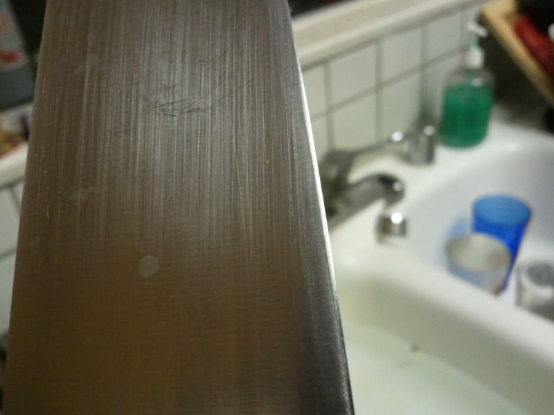

This is only rough ground to 50# right now, still some blending to do is areas, but its pretty darn close.
I had a second rough profiled blank from the bar I cut to get the first one and decided I should heat treat two while I have the forge going. Hopefully both of these will be finalized for heat treat tomorrow and I can burn 'em on Thursday.

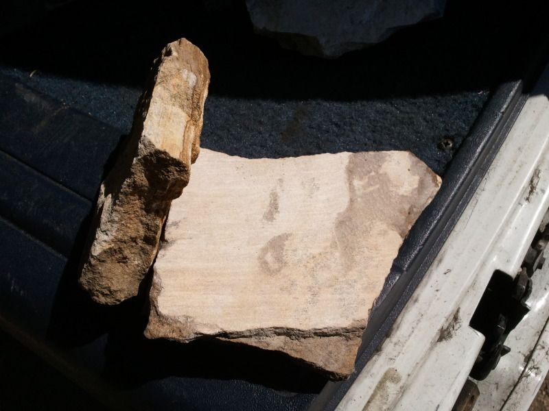

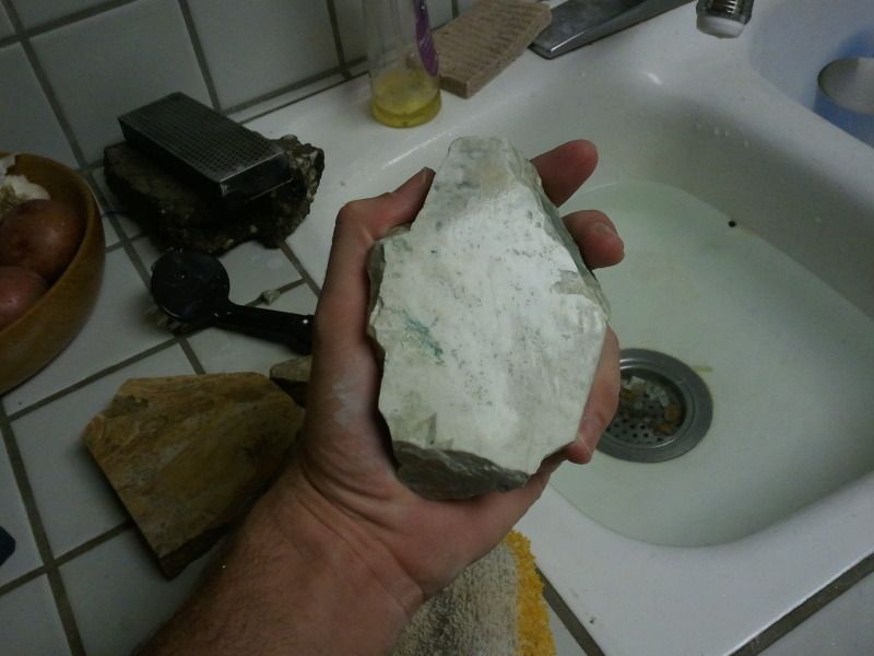

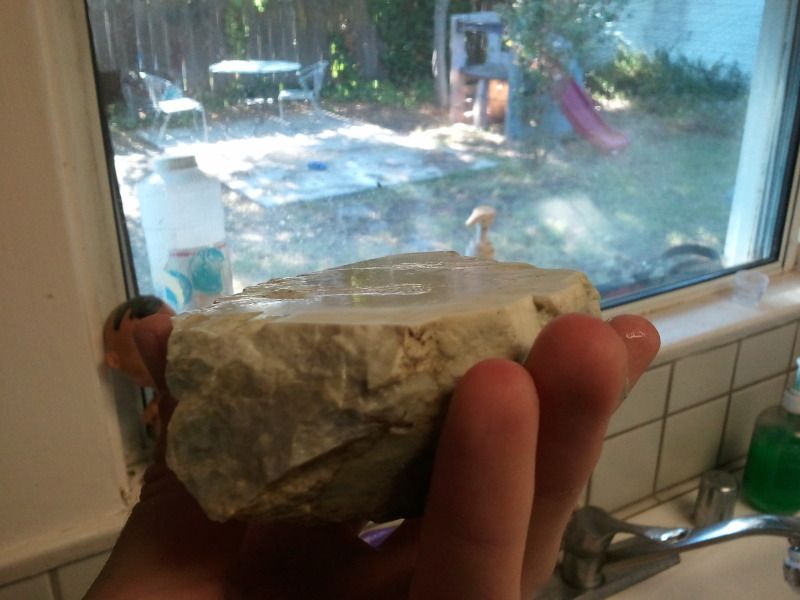

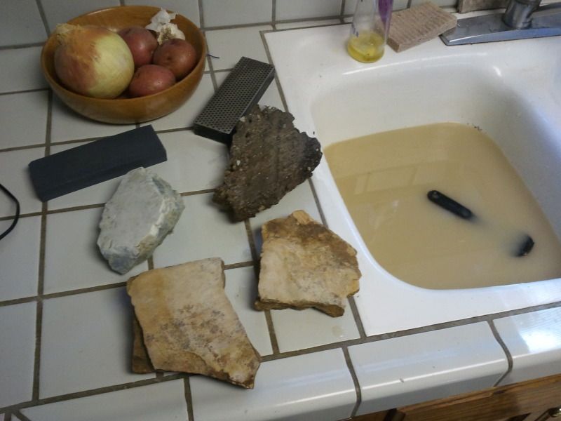

I have been wracking my brain to try and figure out where I can get a piece of natural slate (or some good hard chert) to make my own hone from, don't want to drive to the hills just for that. I think that would be awesome to shave with a razor I made and honed on a hone I made. Daniel, do you happen to know what the "slate" flag stone used for landscaping is? Maybe I can dig through that stuff and find a small one to start and test out.
-Xander
Sweet!!!! Those are looking awesome.

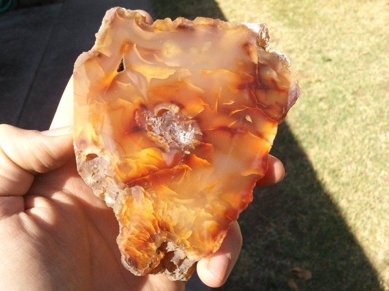

For something like chert I would check out a rock shop, you can find a slab for cheap I bet. Chert is microcrystaline quartz so flint, agate, heck you name it could work. Jasper too, I think a lot of the good Japanese stones must be jasper. I have a huge rock saw I need to finish setting up so I can cut some slabs myself.
Slate is just that, it is essentially mud that is fossilized or shale as that is known. I could imagine it could make a good slurry for a stone but that is just a guess. It is pretty soft but the cleavage is nice for making flat objects.
I'd consider a piece of agate for a hone, I bet that would be nice.You should be able to find something solid for cheap. I pay 1$ a pound for clean but not good looking agate slices out of the local rock shops random junk" pile, a 1# slab would probably do the trick.
Just guessing..... I know my rocks but am not too sure what makes great sharpening stones.
I do know you can buy slabs of the good arkansas stones but that kind of defeats the purpose. I'll look in my site books and see if I can find you a local source that you can collect from.
