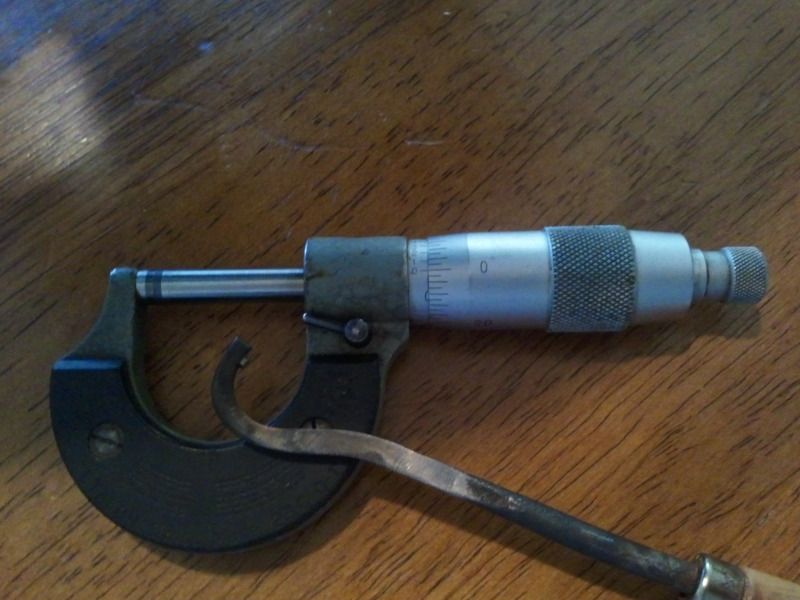

Just came in from the shop! I got a wrench made (twice, lol!) for your mic Daniel, and got it calibrated too. I also did comparative calibration to other mics and calipers. Its a very nice little mic, I'm gonna keep an eye out for another Etalon for me! I wanted to calibrate it late like this when the temps are closer to what you have there right now, it was 66* in my shop. Unfortunately I was unable to repair the clutch on this mic, so your going to have to use it manually for comparative measurements. It doesn't lock on a measurement. So tomorrow I will put together a case for it and find some info to go along with it.
This one doesnt have the normal vernier scale of 1-9 above the barrel, but it has half marks between the whole numbers on the thimble and a vernier of 1-4. So you take your thimble reading, and add it to the vernier depending on which side of the half mark. I haven't found any pics for reading this type on the net, so maybe I'll take some pics and write out some instructions if you want. Its not hard, but if you haven't used it before it can throw you for a loop. I also adjusted the thimble clutch to be pretty light, its the small knob on the end, it slips at a certain torque so you can get accurate, repetable measurements.

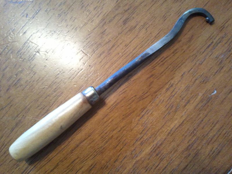

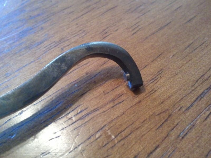

Sinlge pin spanner wrench. Fully heat treated and tempered from an old file. It acted like 1095 in quench tests, so that's how I treated it. 5/64" pin made from an old drill bit so if this one ever fails you can replace it. I just super glued it in. The inside of th hook is finished pretty smooth so it doesn't bugger up the shank.
-Xander
