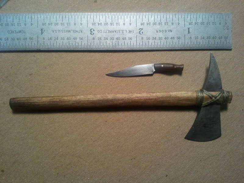

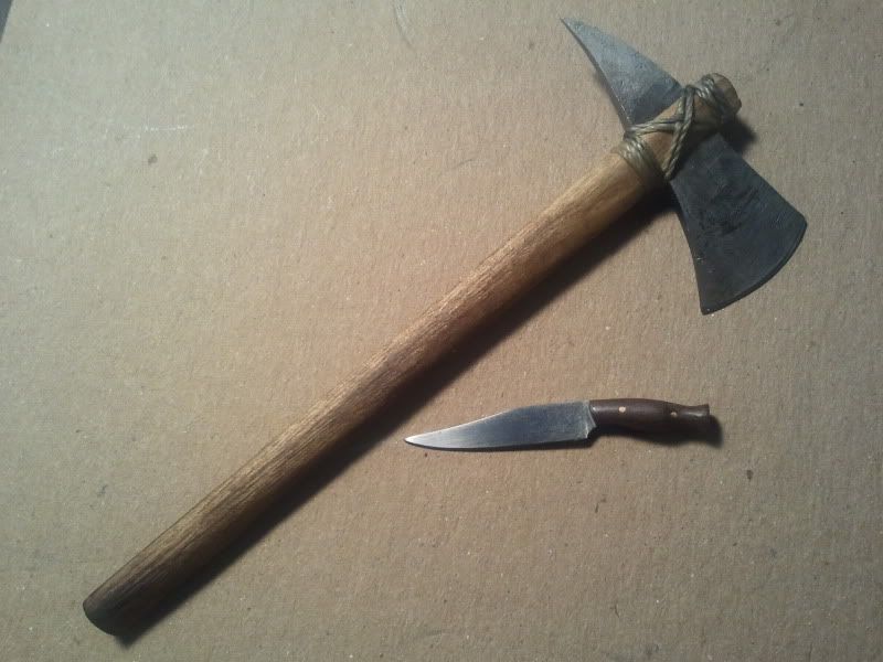

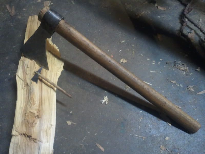

Oh yeah, I made a tomahawk...
Forged 1080 head, fully heat treated. Hand split and carved haft. Shaving sharp!
-Xander
OK now that is badass! :cool:
Just classic! Killer job and very cool that you forged it.

The bowie is in 1/10 scale, and the hawk is 1/5 (same as your USM3) so not quite a good match for each other. I'm going to start on a belt knife to go along with it in the same scale. I have plans to try and forge a mouse hawk with spike poll from some 1084 I have in .250x1

Now that is cool! You had me too, I thought it was big.

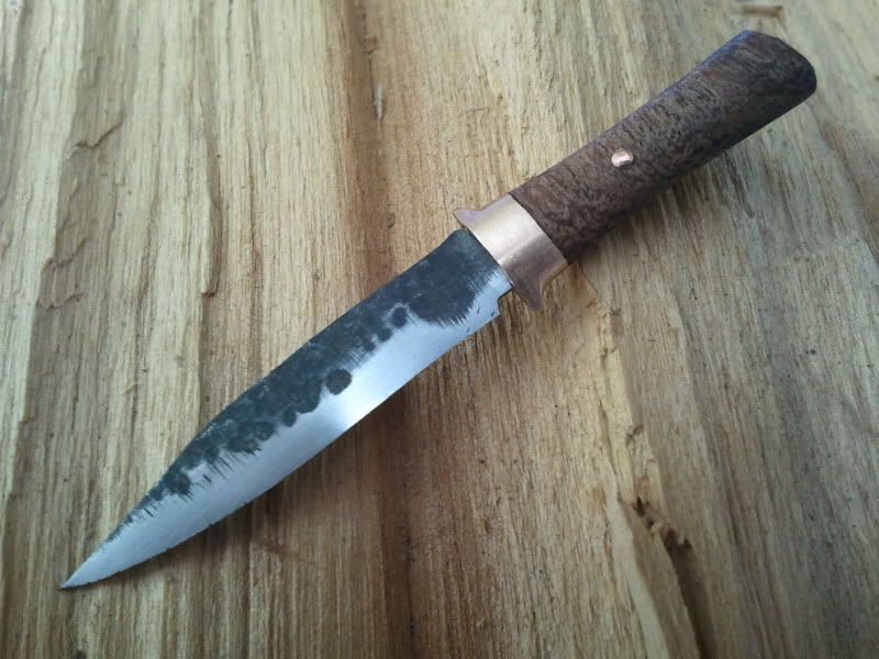

Here's the brut de forge belt knife to go with the hawk.
1/5 scale
File steel blade, forged
Bronze guard
Texas mesquite handle
Copper pin peened and domed (fully functional too!)

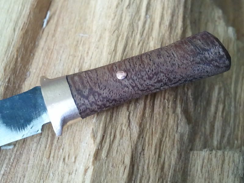

Hammer finished face on the guard, one small gap I just couldn't get closed up, but overall fitment is good. You can see the dome to the pin here too.
-Xander
Very cool! The mesquite is killer, nice looking material. Awesome job on the domed pin too, that must have been tough! :cool:

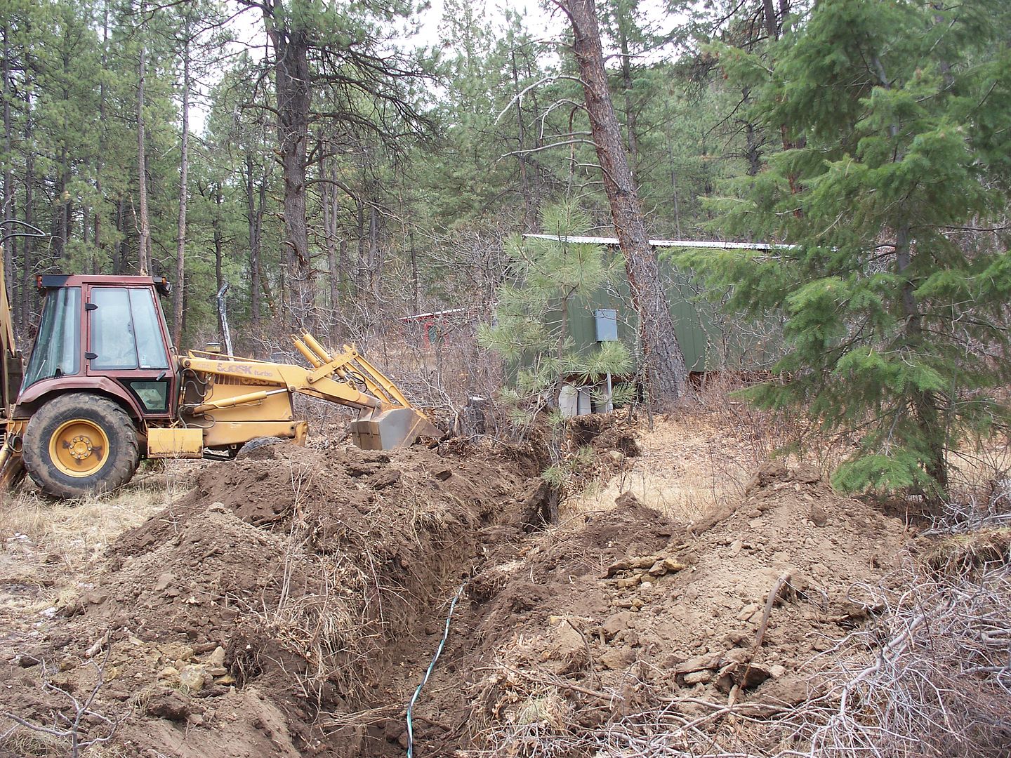

Trench dug... big enough for a small boat! OK maybe not but man it is massive... pics in a second.
Thanx! Peening that .040" pin sure made me pucker at both ends! I'm glad I have a 2oz ball peen just for small stuff like this!

I bet! Do you have a pin spinner? Looks killer!

To me it looks small in the pic but it is BIG! 4:45 here... no inspector yet... I can't wait to get this done! Maybe they will show up tomorrow before it is covered but I'm pretty sure they are supposed to be here today. Either way the trench is dug so that part is good! :D

No pin spinner, I dome all my pins by hand with hammering. Its how I learned to peen and I think gives superior holding power by swelling the shank below the dome as well as mushrooming it over. Pin spinners mostly just mushroom the end like a head on a nail. Also I had to peen both sides of this installed, normally you peen one end and feed it through to cut it off and peen the other end. But this wire was too small to clamp and peen, it would have folded over.
The mesquite is from my bud DanCo in Texas, amazing how much it looks like a burl on that scale. It was a pretty nondescript piece I cut it from, but I cut it across th grain, so the grain is actually running from side to side in the handle.
