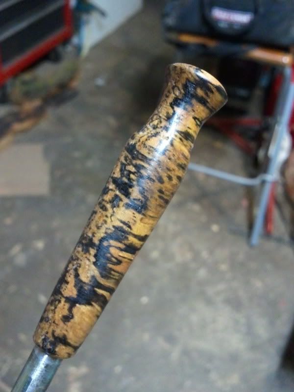

Check this out, this is some spalted pecan wood I got from a downed tree at Kevins house, this stuff is crazy! The spalting is just so figured and tight patterned, unlike maple at other that just get long black lines running through them. I turned this handle down last night for a project I'm working on and it has only the first coat of Tru-Oil on it.

That's damn nice X. I've got some spalted tamarind laying around but it doesn't have near that amount of spalting in it. Is that going to be a handle for one of your scrimshaw tools?
Thanx Matt! I really was hoping to find a little spalting when I got that wood from Kevin, but when I split one billet and saw this I knew it was going to be some cool stuff! This handle is for a companion tool to a marlingspike, called a pricker, its basically a smaller and finer pointed spike with a handle for working with small cord and larger sewing tasks like leather or canvass sails. I use a 2mm lead holder for my scrimshaw points, but that's not a bad idea!

Holy crap Xander that looks AWESOME! How did you turn that ? It looks like it was done on a lathe.

It was lathe turned, but not on my lathe! Rather than set up my wood lathe for this little project I drilled a hole in the block I liked, put a steel mandrel in it and chucked it in the drill press. I took my live center and set it in the table under the wood, brought the piece down and locked it in place, then I used a piece of angle iron for the tool rest. I made a mini verticle lathe, basically. I roughed in with a 1" bowl gouge, cut the groove with a 1/2" gouge and smothed with a 3/4" straight skew. Sanded and burnished on the "lathe".

Wow Xander that is cool! Killer spalting and cool technique.
local wood too... really nice

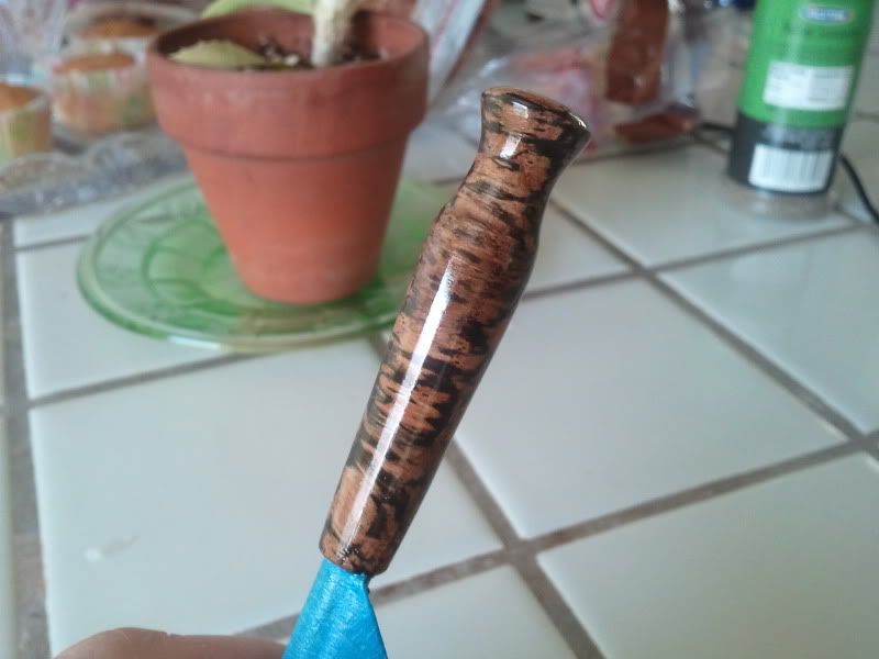

Working on that spalted pecan handle today some more, its finishing out very nicely! I just put coat #16? on and its looking killer. I am going to cut the shine back to a semi gloss/satin sheen, but that doesn't mean I can't enjoy the high gloss build up this finish gives! Still a few more coats to go, I'm expecting 20 coats minimum, maybe more.

looks like liquid! incredible finish
It reminds me of a coffee with cream just added, very cool
I'm impressed, and to think that came from Kevins yard, wow!

I just finished up that spalted pecan pricker a few minutes ago. It came out pretty good, I think. I really like the satin shine compared to the high gloss for working, but the high gloss just looks so killer! I didn't completely dull it out, but its still good looking.
