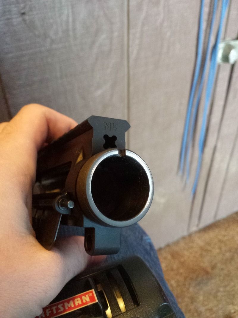

Working on my dad's newest AR today, blue printing the upper receiver for him. It's only about 10 minutes work, but he hasn't done it before.

This is why I like to blueprint the face of these receivers, even a quality machined forging, the face is not perfectly square to the threads. I'm about halfway through this one, you can see the silver areas that have been removed so far.
Now the barrel will seat square, the bolt will align with the barrel extension perfectly too. If you're running iron sights, this will help keep your windage adjustment right in the middle too.

Daniel, the concept is exactly the same, taking parts and machining them to blueprint dimensions, rather than leaving them in blueprint tolerance dimension. That upper is one of the worst ones I have seen myself, I've seen worse online though, but in reality it's something like .0025" out of spec. It's face is now true to its bore. I will post up pics when they are done! I fully plan to put them under the lights and take good pics too.

Do you measure the gap with shims?
Tolerances are interesting. .001" each way can be huge, I can press fit a .25" pin in a .249" hole and it will drop right through s .251" hole.

The truing of the upper is just bringing the face true to its bore all the way around. How far out of spec isn't a concern, I just go until I have a nice even silver band all the way around it. Sometimes that takes just a couple minutes and other times (like on this one) it takes longer. But it's all trued up now! The barrel extension (similar to a tenon on a bolt action rifle barrel) is actually a separate piece that it threaded onto the barrel and is what slides into the receiver, is precision ground and the shoulder is true to it, then a barrel nut slides over the barrel capturing the shoulder against the receiver face with the external threads of the receiver. There is some tolerance built into the barrel nut, so if the receiver is a little off it still holds it securely, but the barrel might be a couple thousandths in some direction. Doesn't sound like much, but to move the bullet 1" at 100 yards, the rear sight only has to move 0.008"! So "tolerance stacking" is something to watch out for and can cause issues even when all parts are in spec. Can even make a gun non functional!
