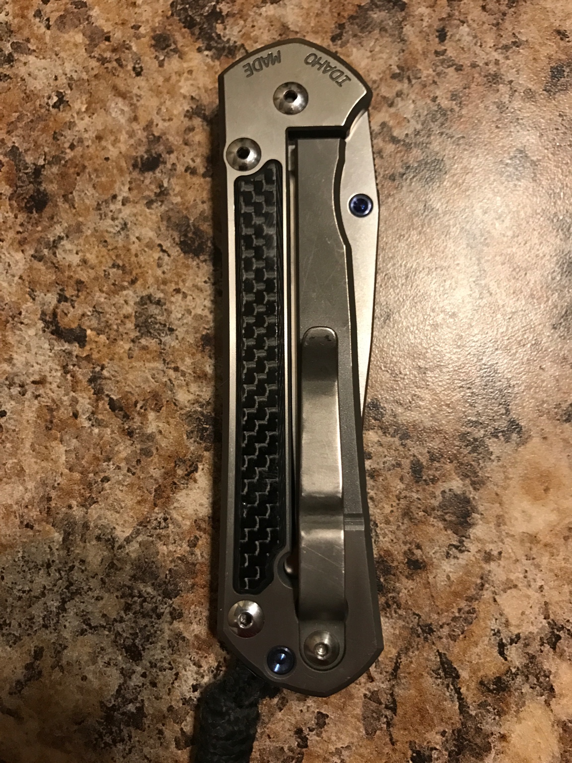

Here is the back if my Carbon Fiber Inlay
Sebenza. Notice a difference?

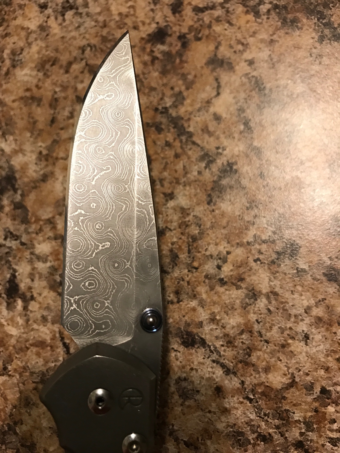

The Damascus blade looks off as well. Here is one of mine. The blade in the eBay one the etching just stops. Doesn't look Authentic
