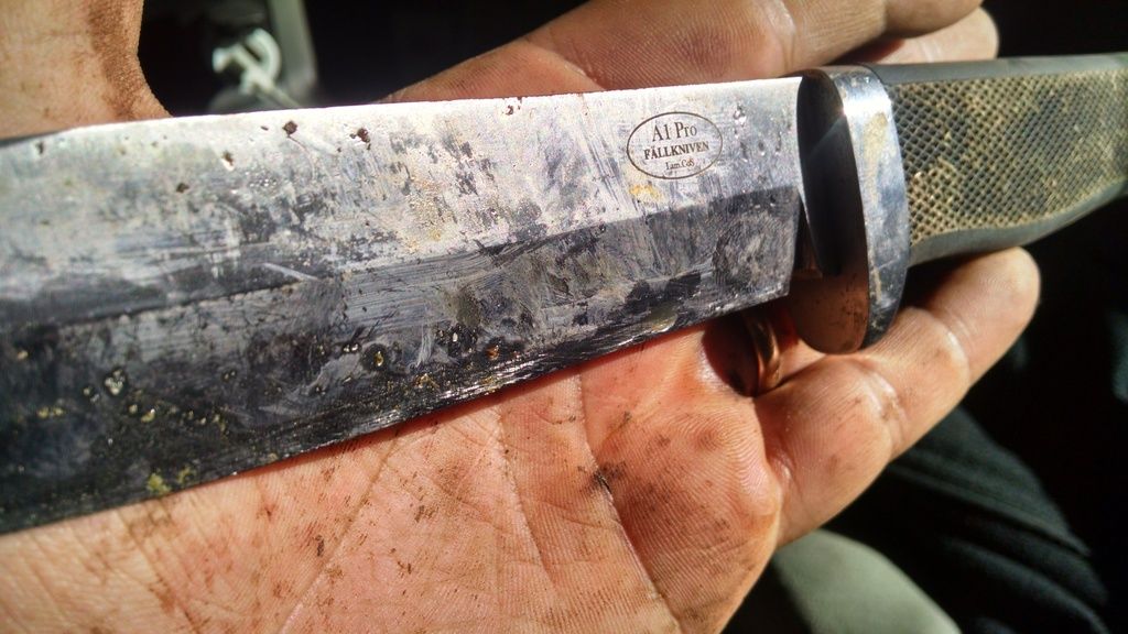

The factory edge wasn't great.
It came with a small ding in the edge.

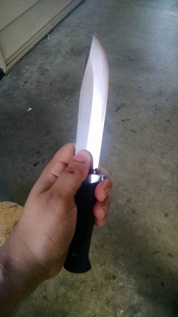

The geometry is more acute then the regular A1 and it was able to shave hair good.

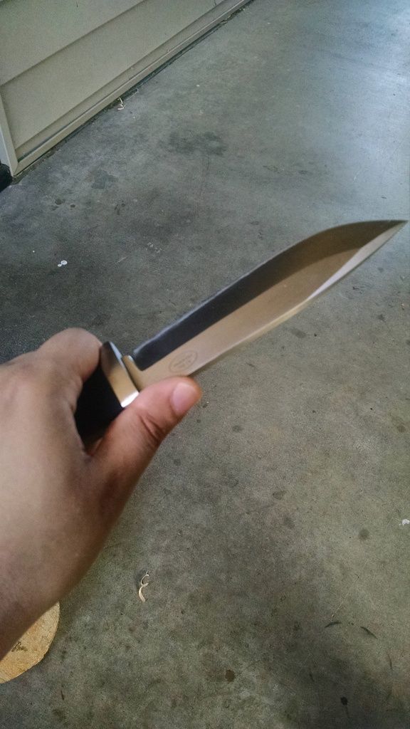

The geometry is very similar to the regular F1, which has the convex start at the Lamination.
The A1 Pro has a flat saber that transitions into a convex at the Lamination. You can see the rough machine scratches were the microbevel bevel starts to form the apex.
This gives the knife an even higher potential from sharpness then the regular A even with the more robust 7mm spine.
Stronger and sharper, wow

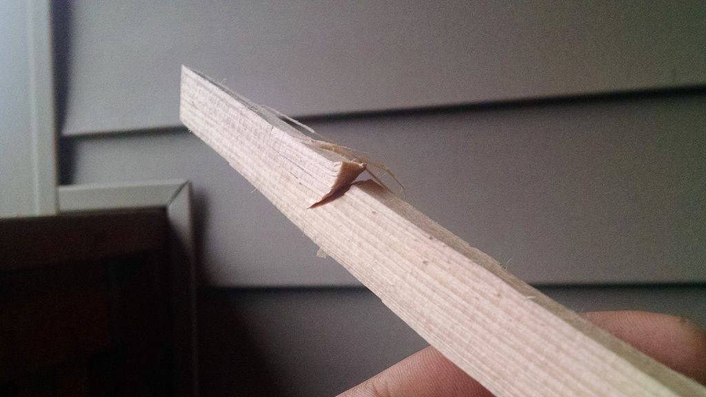

However,the edge did respond insanely well to stroping it took a very high sharpness. My regular A1 was not as responsive with the factory geometry and stroping.
The feathers this knife carved were incredible.
Almost translucent there are so thin.

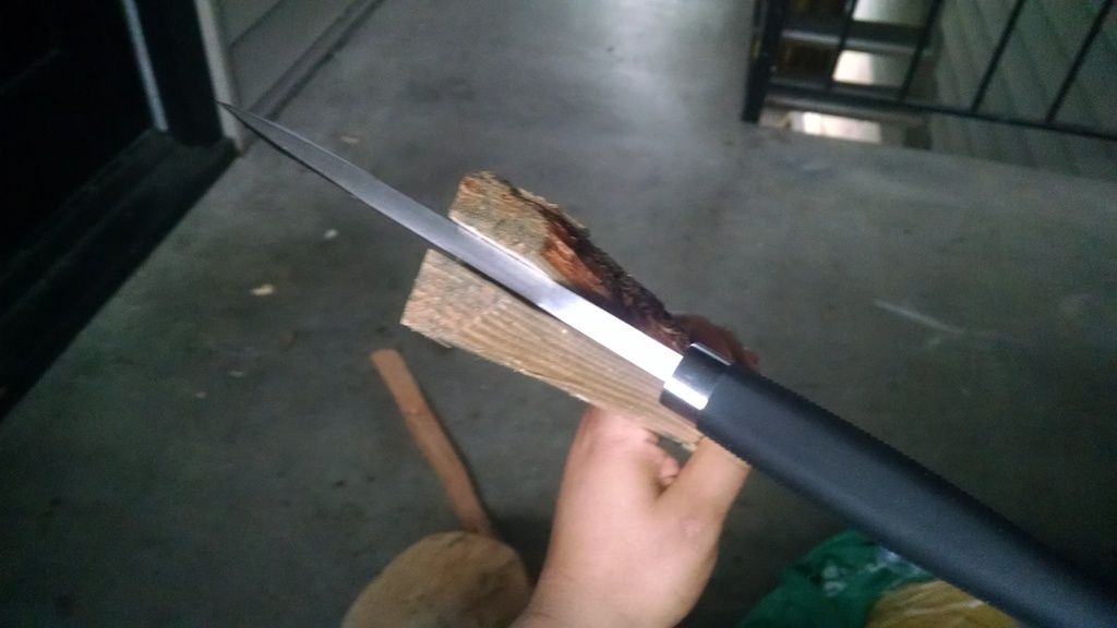

A good chest lever cut this piece straight off with ease.
It has a good amount of "bite" in the wood as well.
More then the regular A1 stock geometry.
It makes great notches
This is on of the best features, no other 6in survival made can baton this good
After the blade has been seated a good solid One to two strike will split any straight grain, knot free wood. It's incredibly efficient.

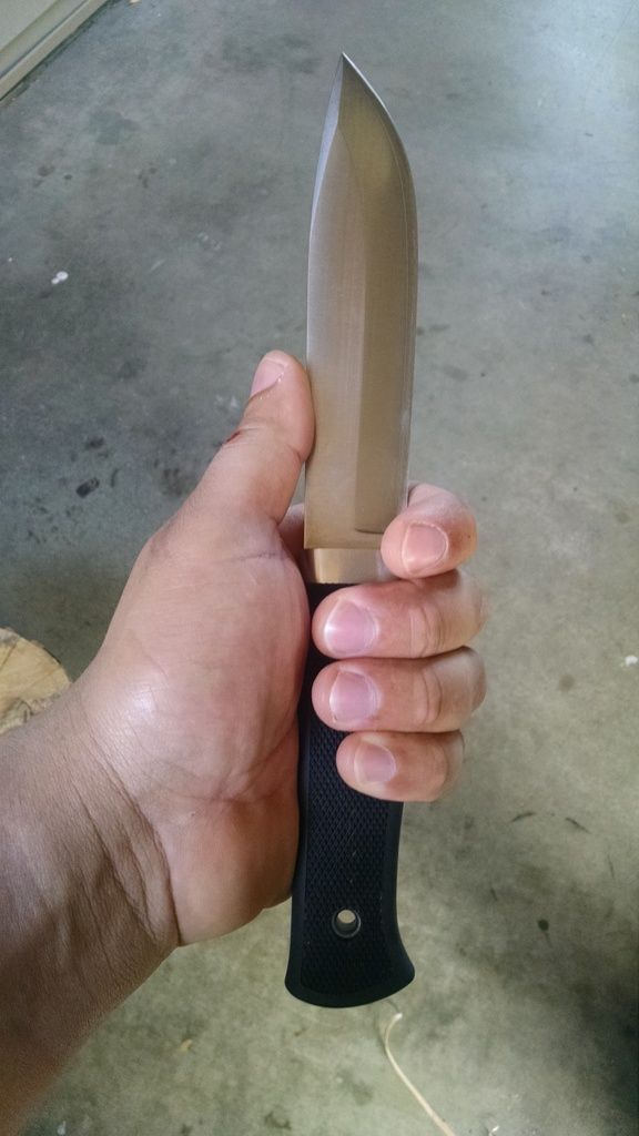

The first thing I noticed when I pulled the knife out of its foam cut out was the new handle design.
It felt incredibility powerful in my hand with a tight grip
There is a new contour to its shape with the palm swell being move forward for more comfort when choked up to the guard while carving.
The new guard is very well Finish and is amazing comfortable. Every contact point is smooth and well rounded.
Another contributing factor in why this knife feels so powerful is that the balance has been moved forward of the guard.
This makes the knife feel very kinetic in hand.
The handle is slightly more narrow then the normal A1it feels slim for those with large sized hands yet this is overshadowed by the overall improved ergonomics.

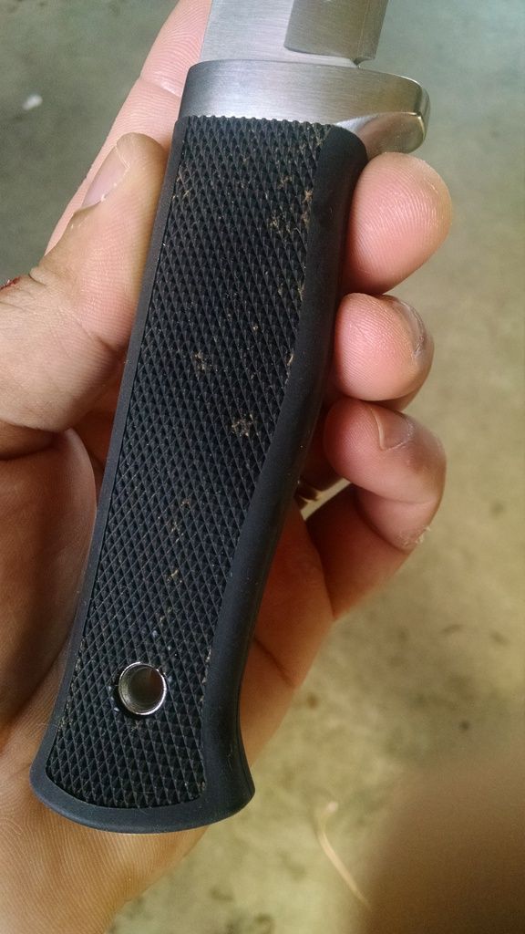

The handle is still made out of Thermorun ( a high density, rubber like polymer)
With is more firm and durable then Kraton.
The checking works great with wet hands and the new ergonomics help prevent the checking from blistering the hands while chopping

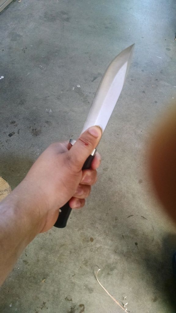

This is sometimes called the "Filipino grip" it's very powerful and controled grip for slashing. It grip the edge oriented to the user and increases leverage.
The Ice pick grip feels good. Also the reverse grip feels good too with the pinky choked up on the new stainless guard
This is one of my favorites, especially with the new balance, the pinch grip.
The thumb feel great on the guard as well for skinningor opeing up an animal. I can't say enough good things about the new guard.

Is it the picture or is the edge that badly damaged? And if it is, what did you do to get that kind of damage?
Did it sharpen out fairly easily?

The Kraton rubber is softer then the theromrun which is very firm.
As far as the handle loosening on the CS SRK, the construction only has the lanyard tube holding it in place
The Fallkniven A1 handle (top) has the lanyard tube in addition to two tang pins to keep it in place.
I haven't had anything to report about the theromrun getting loose or falling apart.
