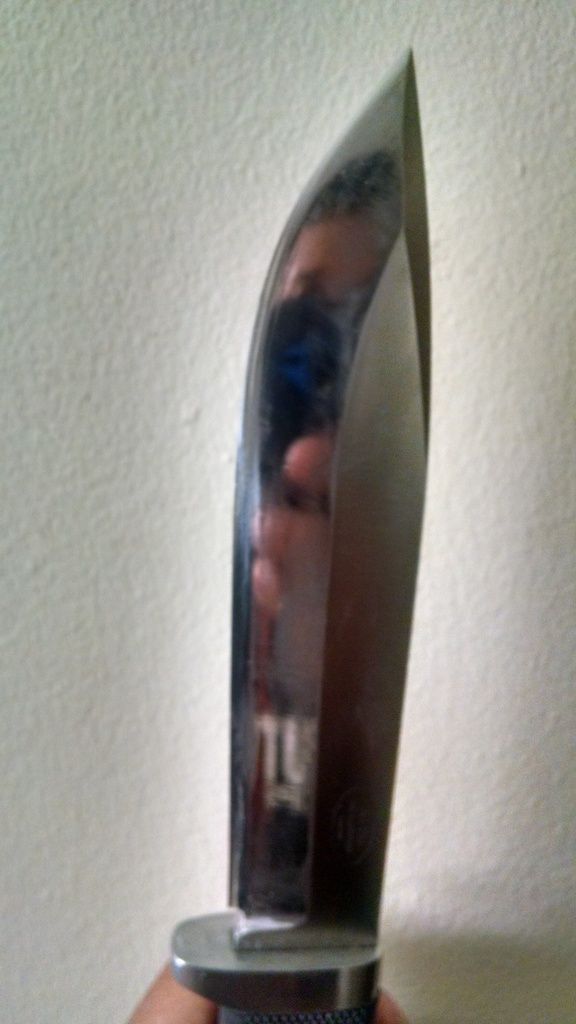

At first glance, the only thing that stands out is the new stainless guard.
This could not be further from the truth and the new version definitely is deserving of the title "pro"

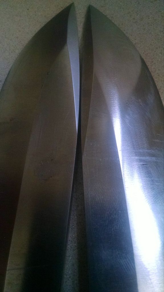

Upon closer inspection, we see that the swedge on the Pro (left) is not as long and the grind not as high.
Yet, the A1 Pro is sharper from the factory because the convex geometry is less bulbous.

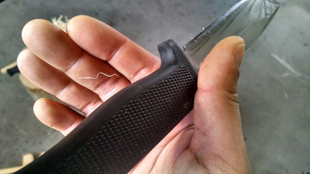

The handle on the pro is amazing. I didn't know the regular a1 needed the upgrade.
It's slightly shorter, and has a finer checked pattern. But one of the best new features is how the palm swell has been shifted slightly forward locking ones hand into the incredibly comfortable finger guard.
I was weary about the new metal guard being uncomfortable, but the transition between the Thermorun and the guard is seamless.
Very streamlined and comfortable.
Going back to the regular A1, it's simply not as comfortable
It's feels small and really "hooks" onto the index finger, it's narrower and sharper transitions then the Pro. It's still a comfortable guard though.
The Pro guard is wider, flatter and really "seats" the finger with now sharp transitions.
the Pro is more comfortable. Especially for Larger hands.
The pro has slimmer handle but this is mitigated by having improved ergonomics

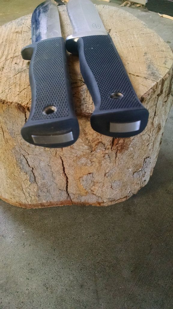

The Tang tapers in height towards the end if the handle on the Pro.
This improves the balance and also cuts back on the weight from the additional 1mm of thickness added to the blade.
The Pro only weight 0.8 ounches more the then stock A1 at 12ounches versus the Pro at 12.8 ounches.
That's alot of power in a lightweight package. For reference 16oz is equal to 1lbs.

This one of my favorite upgrades, the balance has been moved past the guard
On the regular, the balance is right at the guard. Which isn't bad, it feels very stable but the Pro feels more "kinetic"

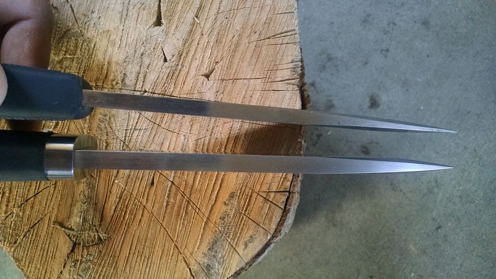

Of course the obvious, the Pro is 7mm thick versus the 6mm on the reg.
The great achievement here is that the Pro does this without any consequences to the cutting performance and we get an even more durable and dependable knife.

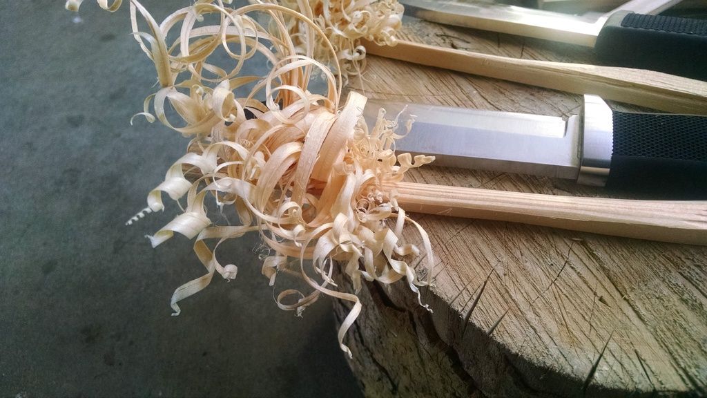

Feathersticking
The grip is narrower on the pro but is taller near the guard which gives is a great tight, comfortable grip despite its size.
The A1 has a slightly thicker and longer grip however, choking up into the guard is not as comfortable as the pro.
Both carve excellent
The Pro was able to make finer curls, even with a coarser edge.
The A1 did great, the polished edge really helps the blade slide on the wood.
