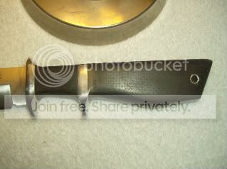

When I had the material and the completed knife in my possession I was appalled how the material had turned out.
I was always advised that it would not look the same as Neils Knife as there would be alot of cross section on view which would not show colours.
I've seen laminated cloth scale material, before it was worked, and could tell the visual outcome. If anything, the person you employed to do the work could have easily cut a small sample, work it, and report the outcome to you.
I can empathize with your displeasure, somewhat, but the decision not to proceed with using the Fibermascus should have been made before the knife was completed.

Can you upload the pic of your knife now?
(to compare)
The above looks like camo burlap fibermascus should.
Damn I take a pretty good picture. I remember that knife well,,gorgeous work by Neil Blackwood. :D
I think that works and shows you all the album I have made of the knife and the material I was given, I still dont know what I am doing haha. Sorry it took so long my internet went down.
I wish ! When you look at the cross section you can barely see the change in colors between green and brown. You seriously need to be under a high powered flourescent light to notice the differences.
I think you might be looking at a poor finish.
I held my tongue at first...cuz I wanted to see your pic. But now that I've seen it (and no offense to the maker) the finish is not right - nowhere near the finish of the blackwood piece above. That'll make all the difference in the world.
Also, there appears to be very little contouring to the handle...so, you're not going to see as many layers.
Good news: looks like camo burlap to me
Bad news: needs to be refinished
Send it back to the maker (or someone you trust) and have them fine sand it and buff it with a fine compound. :thumbup:

I know what you are saying about the finish of the knife it isn't the best. But when you look at the other pictures in my link you can see that the green and the brown is there but extremely dark as if the colours have fused together almost.
Under a high powered fluorescent light they are visible. The colours look way different on the Neil Blackwoods Knife (no offense to you) but I cannot see how a fine sand and compound will make the colours show apart anymore. I could be wrong I dont do this for a living.

Third, what Dan has pointed out really does make a difference! The craftsmanship does make a HUGE difference! That handle has VERY little contour to it so the alternate layers are pretty much wasted! If you over heat a material like canvas micarta while working it, it will turn a brownish color (I don't know if that is what happened here but it is a possibility). Also the final finish on a material WILL affect the way it looks.
You really should have inspected the material prior to using it, now you know. Lesson learned. Me personally I would be more upset with the work done...:barf:

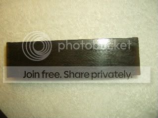

To your second & third: This could of been intercepted at manufacture stage. When you look at the cross section below of the material in block form compared to the picture of the Neil Blackwoods Knife it is obvious to me that I would have no where near the same results . The canvas has gone extremely dark and the difference between the two colours is barely noticeable. If he had pride in his work he would of not of shipped this, he would of redone it.

The knife I have in my hand right now has the different colours shown through on the face but you need a high powered fluorescent light to see them as they are that dark and the burlap cloth is, yes I would say burnt too. The photo I sent him was to me as good as a sample, he failed to reproduce this material and just sent me it anyway.

All he said was, again it would look more like a laminate and that my piece was from the same bolt of material that was used in Neal's material. More color would be seen in the flat face of the fabric instead of the edge. I have no colour !
You're looking at the edge of the laminate there, and there's definitely color.
