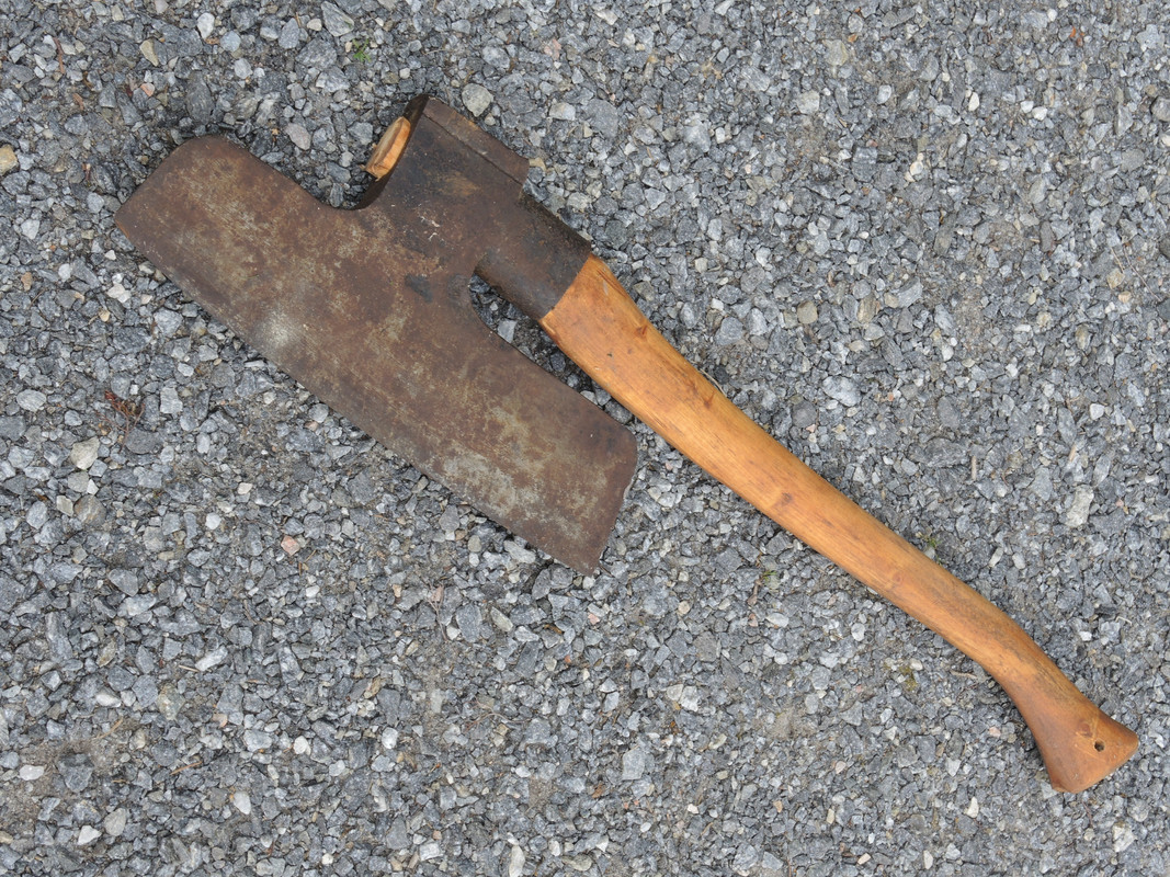

With my trusted Sparrbila now in hands and ready - once some acclamation has set in after coming from costal levels to high desert- for some raftering action, the reason behind its 4,3 kilos kind of becomes self evident. I guess, 'cause I operate to a large degree on intuition and common sense with these archaic tools, this feature is first and foremost for powering through knots effectively and maybe secondarily for the big cuts such mass can facilitate in rafter hewing context, big blade on small working surface. Me, I'm waiting now on the snow to melt so as good trees are able to be gotten at and out.
Another Billnäs 30/6, for rafter hewing, w/o haft landed in my hands😀
As usual, the left side is totally flat and the eye socket is bent to right and slightly twisted away from the cut being made.
