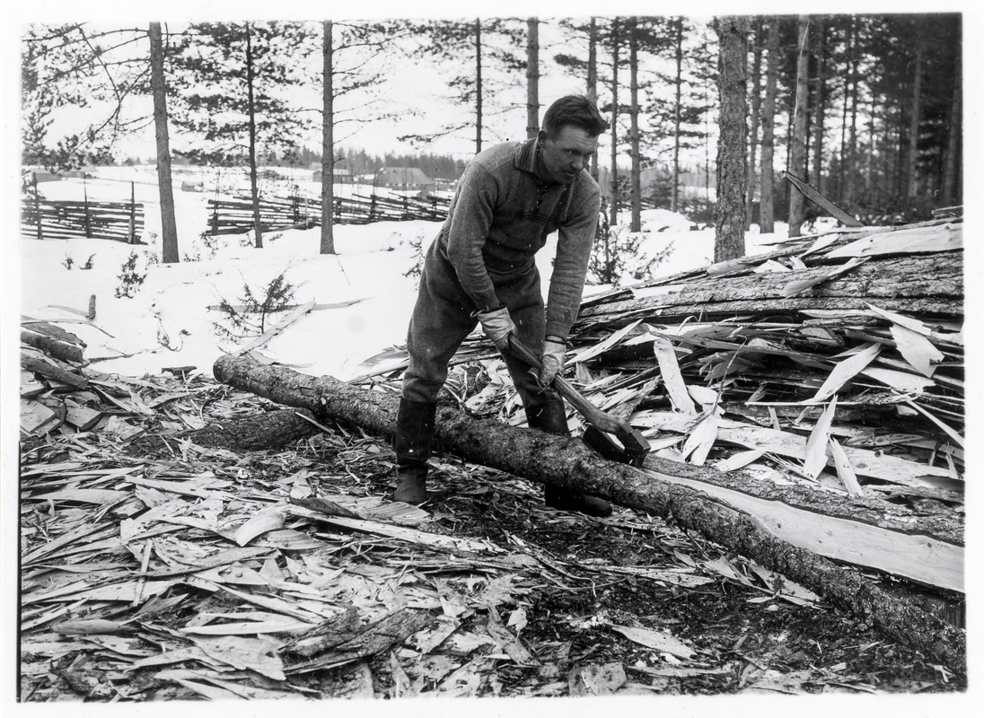

Finna.fi public domain has several pictures of these axes in use. They were used to make so-called "egyptinparru" i.e. Egyptian rafter/beam, which were exported in millions to Middle East, right until 1960s.
Those were real men👍

I hew with my left hand forward and the log on my left.
I move backwards. This is so that the path of my swing has already been cleared of wood. I prefer to hew from top of tree to bottom of tree so that the grain runs out as I progress. In this way I'm less likely to split the wood beyond the line. After hewing the first side top to bottom if I simply switched to the second side I would be hewing bottom to top. Instead I roll the log over and hew the 2nd side just as the first.

Conical from top to bottom or shall we say but to tip.
It's probably the case as I know it that the tip doesn't get hewn at all very often. In fact the squared section differs depending on the dimensions of the stick in the woods, which vary . The rafters are worked in the woods where they are cut, and then transported and then stacked for transport. Typically, (don't know for sure about the Egyptian case but likely so), the rafters are in place in the construction within a year of cutting, two at most so the process is pretty efficient.

Conical as seen above, or maybe you might call it tapered as it is no longer round in cross section, but square/squarish.
Yes, and three tiny real women sitting up there looking down too.
